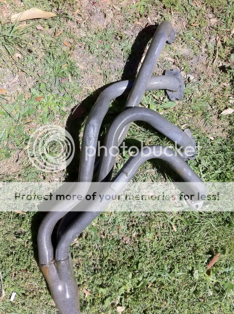

I'm sure most of were already aware of this but i've only just found out recently- molasses removes rust!! Who would have thought?
A mate of mine is doing up his dads Val and has a huge tub of diluted molasses to help him with the project, so i took my extractors round to his place last week and in they went. He dropped them off today and the difference was amazing, and no sanding or grinding or rubbing required.
I don't have a before pic but they were totally covered in rust, but now..........

Molasses has been around for years and has to be one of the best value ways of removing rust on STEEL panels (alloy and molasses can equal one rooted item).
My brother in law is very big into old cars and has been for years and had a HUGE tub down the back that could take panels, cowls, doors beams etc etc and most times it only took a week of being in the bath to get rid of all rust safely. I've done the same thing on a much smaller scale with heaps of success and when the molasses solution is fresh it's safe to handle (not sure after umpteen uses as I never kept it for long as it's cheap and easily renewable)
A strange spin off is the parts I've done haven't suffered any further corrosion even in a damp environment - something to do with the chemical reaction that stabilises the surface.
If it is deep rust it might take a few immersions with scrubbing and hosing between baths but it will eventually remove even deep crusty rust.
I used it at 4 or 5 to one but have seen it thinned almost double that mixing ratio.
When you are done you can tip it down the dunny or into the garden so long as there isn't 300L of the stuff.

Good stuff Dave, i especially like the part about no further corrosion. Could it be that it leaves an oily film and has the same effect as fish oil? Just a hair-brain theory

UTEK wrote:Good stuff Dave, i especially like the part about no further corrosion. Could it be that it leaves an oily film and has the same effect as fish oil? Just a hair-brain theory
No - Not oily at all, in fact when it comes out of the bath it is very watery and often black muck that hoses / brushes off very easily. I've always sprayed over with WD40 just to chase the moisture away but after that it has a yellowy green colour that seems not to want to rust even in humid conditions. A chemically created barrier perhaps?
