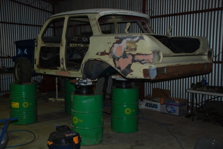

Hi Trev,
Sorry its taken so long to reply.
Any info/pictures you can post would be fantastic!
Well the short version of the long story goes something like this...Mum and Dad bought me a 1963 EJ Special sedan when I was 14, Im now 28! We did a good 18-24 months work on it and then the folks bought a farm up in Northern Vic. I did my last two years of high school, moved down to Melbourne for Uni, started working full time and all the while the car sat in the shed collecting dust. I have just recently returned from living overseas and we thought it was high time we gave it a nudge after a 12 year absence!
Quick run down of whats been done...
All four floor pans and transmission tunnel replaced with the addition of; seat belt anchor points and seat rails points for VN Commodore bucket seats
Underbody has been stripped and sprayed
Engine bay stripped and sprayed
Front end stripped, rebuilt and sprayed
Gearbox stripped, rebuilt and sprayed
Engine has had the addition of an alloy rocker cover, twin carb manifold and extractors
Rear seat and door trims re-upholstered to match grey VN Commodoer bucket seats
Were currently tackling a few areas...
Rear body work including replacing the beaver panel
Rebuilding the diff and replacing rear suspension and bushes and rubbers
Its a nice feeling when stuff is coming off the shed floor and going back on the car. Fingers crossed its not another 12 years before its back on the road!
Matt
