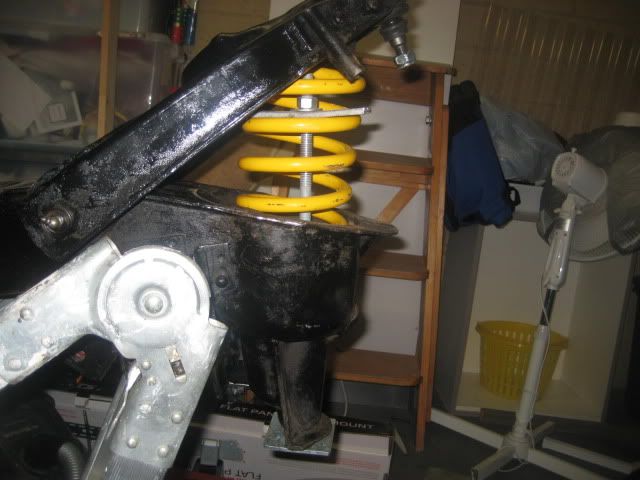

I have tried spring compressors, cutting down the spring compressors, putting spacers in the spring compressors, long threaded bolts and plates.,
The car is in one piece and driving with its original front end while i am rebuilding the hr unit, so putting it back in the car is not an option.
I am going nuts here :evil: the spring has to be slightly bent or angled inward to fit into it's apeture in the lower wishbone, but using a threded rod internally pulls spring in square. if the lower wishbone is fully hard up against the frontend(subframe/crossmember/ insert prefered handle here.) then it becomes closer to being in correct alignment. however this means compressing the spring almost entirely into the tower. I stripped this frontend out of the car so I came across this problem trying to remove the springs. It was easy enough to remove the shocks, break the ball joints and then REEEf the lower wishbones open as someone stated in the other post, at this point there was neglig, neglegabl. BUGGER ALL pressure on the springs, and they just popped out. (yes they appear to be original, and are in fact slightly longer then the ones I am trying to get in now.)

Went away for the weekend and got visited by the auto fairy- when i got home the spring was in. :shock:
I dont think I made my problem clear- I couldnt get the spring seated prior to compressing the lower wishbone . seems you dont need to compress it to seat it - My old man came in to feed the dog while i was away and "just popped it in". :?
So i guess the answer i was after is:
1. position front end so it's upside down and drop the spring into the bucket.
2. lift spring out slightly (not quite halfway) and push protuding end in and down towards pivot pin, bending/angling the spring slightly so the end of the spring catches on the lug pressed into the lower wishbone.
There is not a great deal of pressure here but enough to hold the spring in. Now you can insert threaded rod through the shock tower/spring and lower wish bone in order to fit stub axle.
Sorry for any confusion guys- sometimes i get hung up on the little details. :oops:

Kind of. I'm not advocating this as the best or safest way to do it but when I removed my springs the the f.e. was out of the car with shocks, upper wishbones and stub axles removed. The springs had some slight tension on them (I believe they were stock hr) which was forcing the lower wish bones almost straight down. They couldnt fold back any further because the spring was caught under the lug in the wishbone.
I put it upside down on the ground and reefed the wishbone open far enough to bend the spring and allow the bottom end to slide clear of the lug. The spring then just popped out with enough force to jump out of the tower and fall on the floor. Most of this energy was generated from bending the spring sideways I think -but the potential for injury is still there. Spring compressors would be safer but I found they restricted the movement I needed to get them out Flintstones style. :wink:

Post by jake08 »
I got mine powder coated - looking at the above picture I don't think it was money well spent :oops: I have used spray packs of gloss kill rust before.
