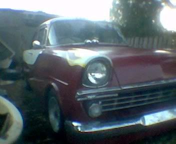

hi guys, iv been reading about all your cars and thought id post some pics of my fb, she's far from finished but im in no rush.
this is how i bought it in 1996.
this is the most recent pic i can find but ill hav another look later because so much more has been done since
its got a repco grey engine with twin carbs and extractors and hr front.

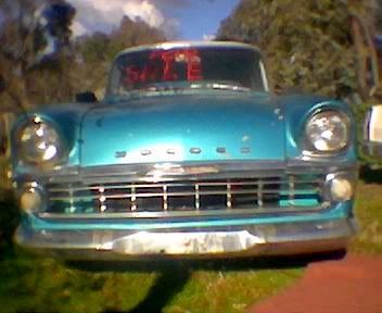

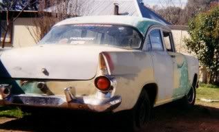

the day i bought it

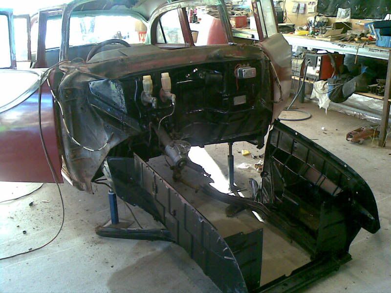

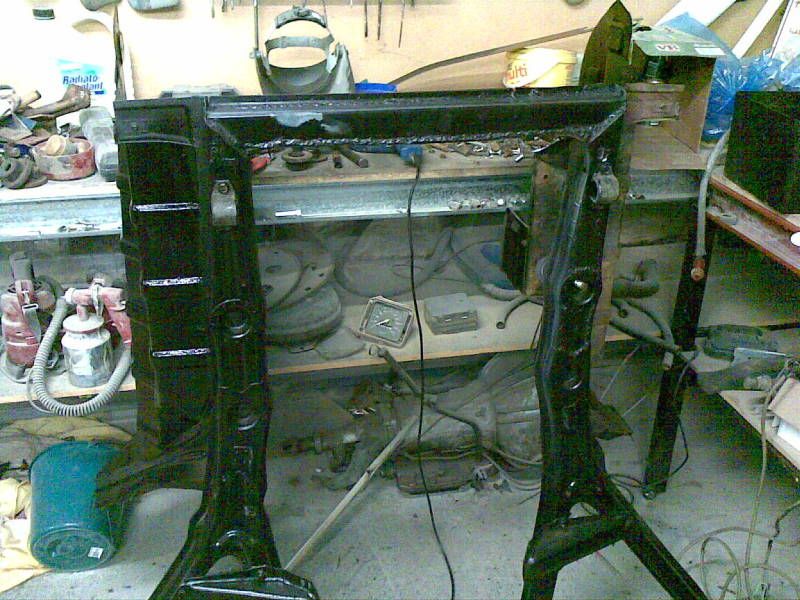

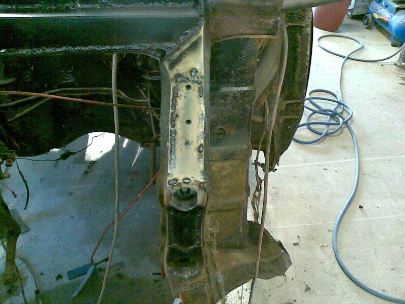

years ago i replaced all 4 floors, sill's are good but i knew the subframe was a bit iffy, so bugger it, i pulled it off, only pin holes but they soon got bigger when i started tappin round with a screw driver.
the front part where the outrigger bolts on had pin holes all along (im thinkin because of the bolt access holes :evil: ) so i replaced the whole lot

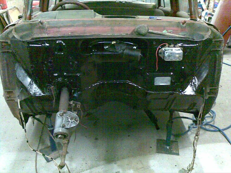

one of the stabliser bar mounts was cactus, tag was rusted off and the bolt snaped off :evil:
the patch peice i made out of a thick flat black plate, drilled two holes and welded nuts on the inside :D now hq ones bolt up.
no point doin one side and not the other :lol:
I gave the firewall a coat of black whie i was there :)
there was no rust between the subframe and firewall :)

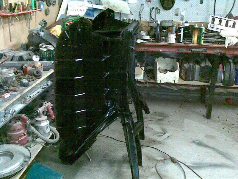

i painted the outside of the subframe in stoneguard and gloss black, and just gloss black on the inside

thats all i can do with the subframe till i get a helper smurf to help put it back on, iv tryed by my self but im a couple of arms short :?

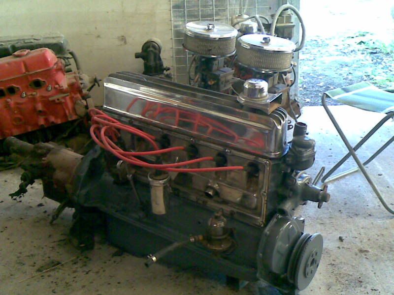

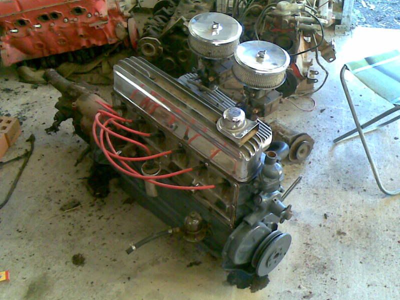

motor runs good! took it for a squirt before i pulled it out, so just a paint and polish will do.

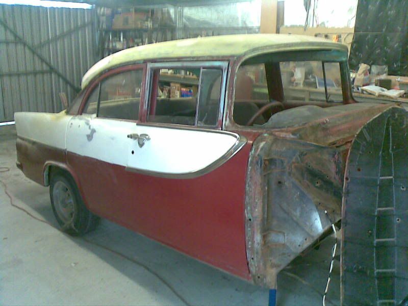

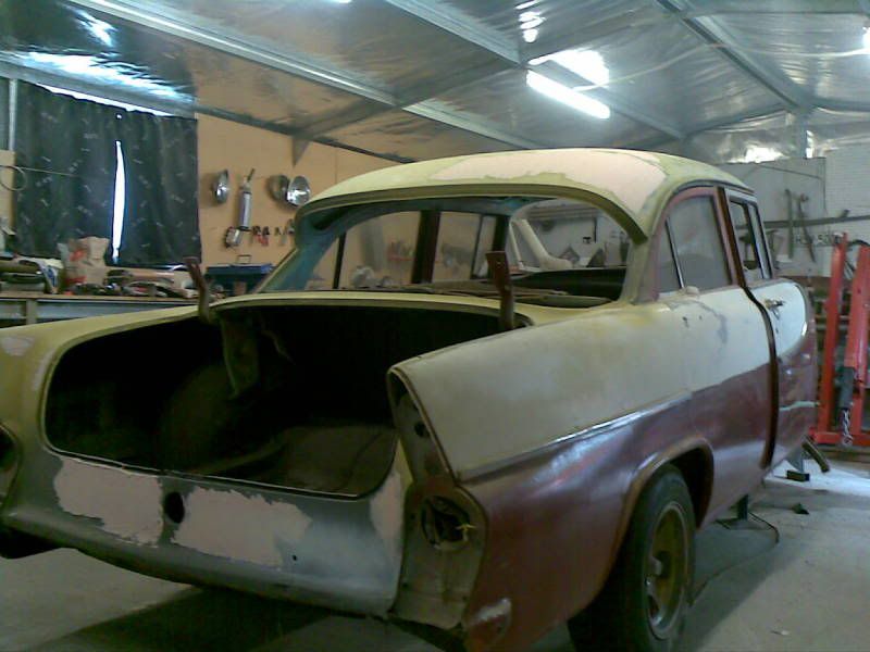

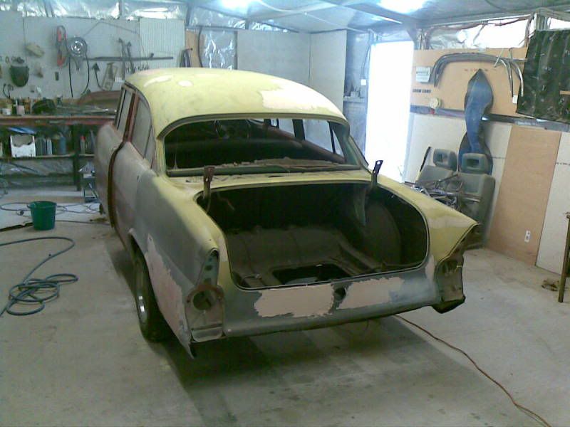

in between doin the subframe i also stripped the roof back to bare metal, i used a grafetie (spelt wrong) remover on the grinder, there a fiber/fiberglass lookin thing, they were mentioned somewhere on this site a few days back. while i was on a roll with it i did left rear 1/4 and in and around the boot, found some rusty spots in the 1/4 so did a repair, dont let the bog scare you, most of it will be sanded off :) by hand :cry: anyhow heres how she looks

tell me about the sap and leaves i didn't think there'de be anything left of the car :shock: i'de loose the spoiler if it were mine :wink: but it's not :roll: they don't call them spoilers for nothing :? they spoil the look of a car :lol: if you need some extra hands give us a yell :wink:

Interesting old rocker cover on your motor,
what brand does it have on it?
