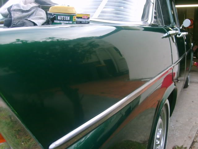

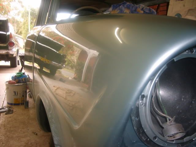

:) Hi Andrew some pics and info for you
I used protek for the colour on my wagon (acrylic )
and carmaster for the clear and primer + top coat thinners
no complaints so far happy with the shine and depth
sedan i used a brand called debeer for the colour and clear
and motorspray for primer and a GP thinners for every thing
:oops: my first paint job still happy with the shine and depth
both cars are metalic Jay :)

Thanks for that Jay, both paint jobs look great :D I'll give a protec dealer a call and chase up some prices... I'm a big fan of your wagon - silver paint and whitewalls looks 8)
