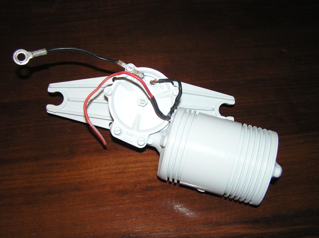

Today I finished the wiper motor. New Wiring, new color 8)
Hooray :!: The first part of the car is complete.......

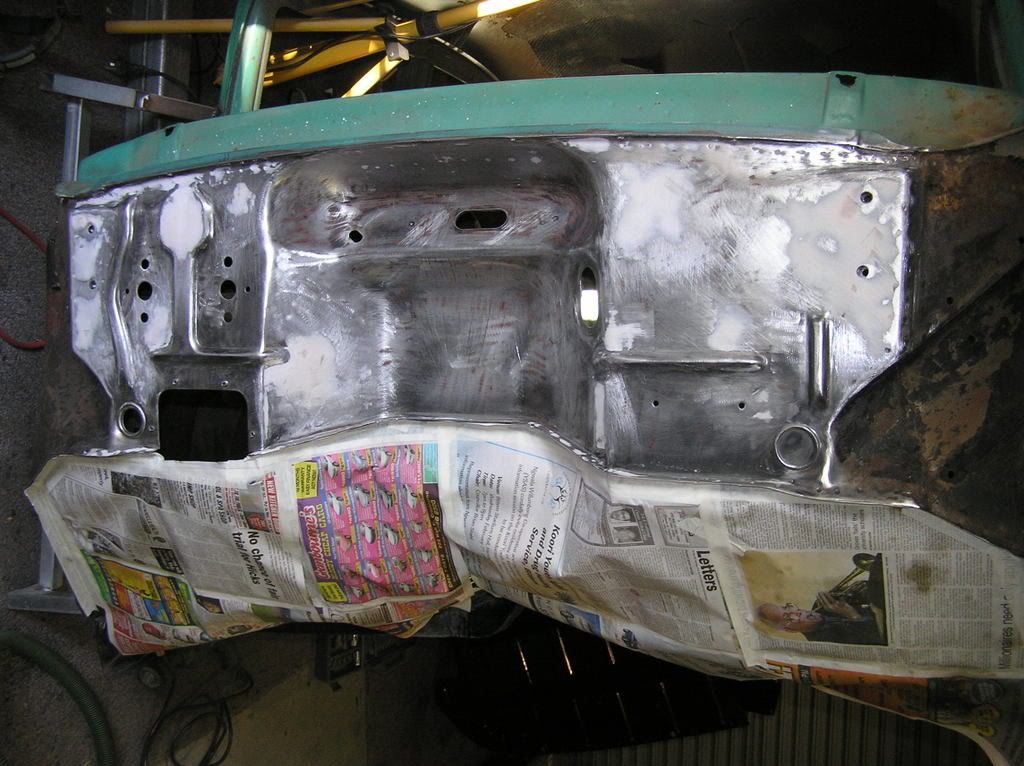

Started the firewall. Welded up all the unnecessary holes and cut off all the wiring clips etc.......
Etched, primed and guide coated.......

I recon the sick thing is doing a guide cote :shock: , how smooth do you want this fire wall? Looks good though, Trev 8) .

Nothing done by halves here :!:

Couple more rub backs and "guide coats" today on the firewall Trev :lol:
Should be ok for paint with light sand, but this can sit for a while now to let the filler and primer settle.

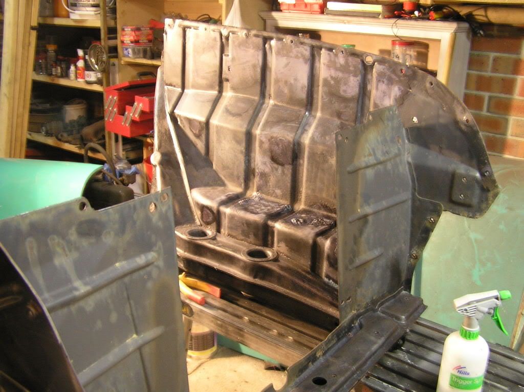

Started on the rest of the engine bay today, bit of welding up and cut the battery box out, not a lot done being Father's Day and all :wink:

When you're taking paint off with the flap disc, do you have to be careful to not take any metal as well? I use flap discs at work and I would have thought that you would be taking metal off and getting lots of highs and lows in your panels...
S'pose it depends on the grit size on the flap disc??

Paroharo - Yes I'm careful with the flap discs.
I use the leftover ones from all the welding, they've warn a lot.
The wire wheel gets into the corners etc. then I finish it by hand with a 60 grit so the filler etc can bite on.

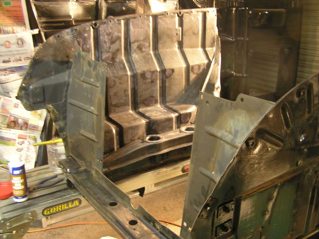

Got out to feed my addiction after work tonight.
Cut the drip rails off the insides of the bay after many mind changes :!:
Finished welding a few rust patch-ups,
treated it with rust converter where needed
and this is what I ended up with...........
