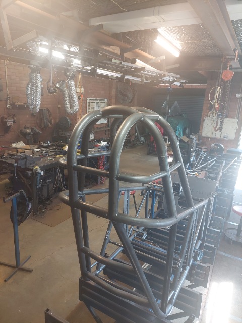

Life behind bars.

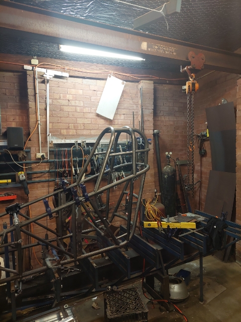

A lot more cage than the simple rollover hoops of the 60’s. My noggin is probably not worth the steel price (too much armour, not enough brains) but needs to be IHRA compliant to run.

It is some beautiful bar work.

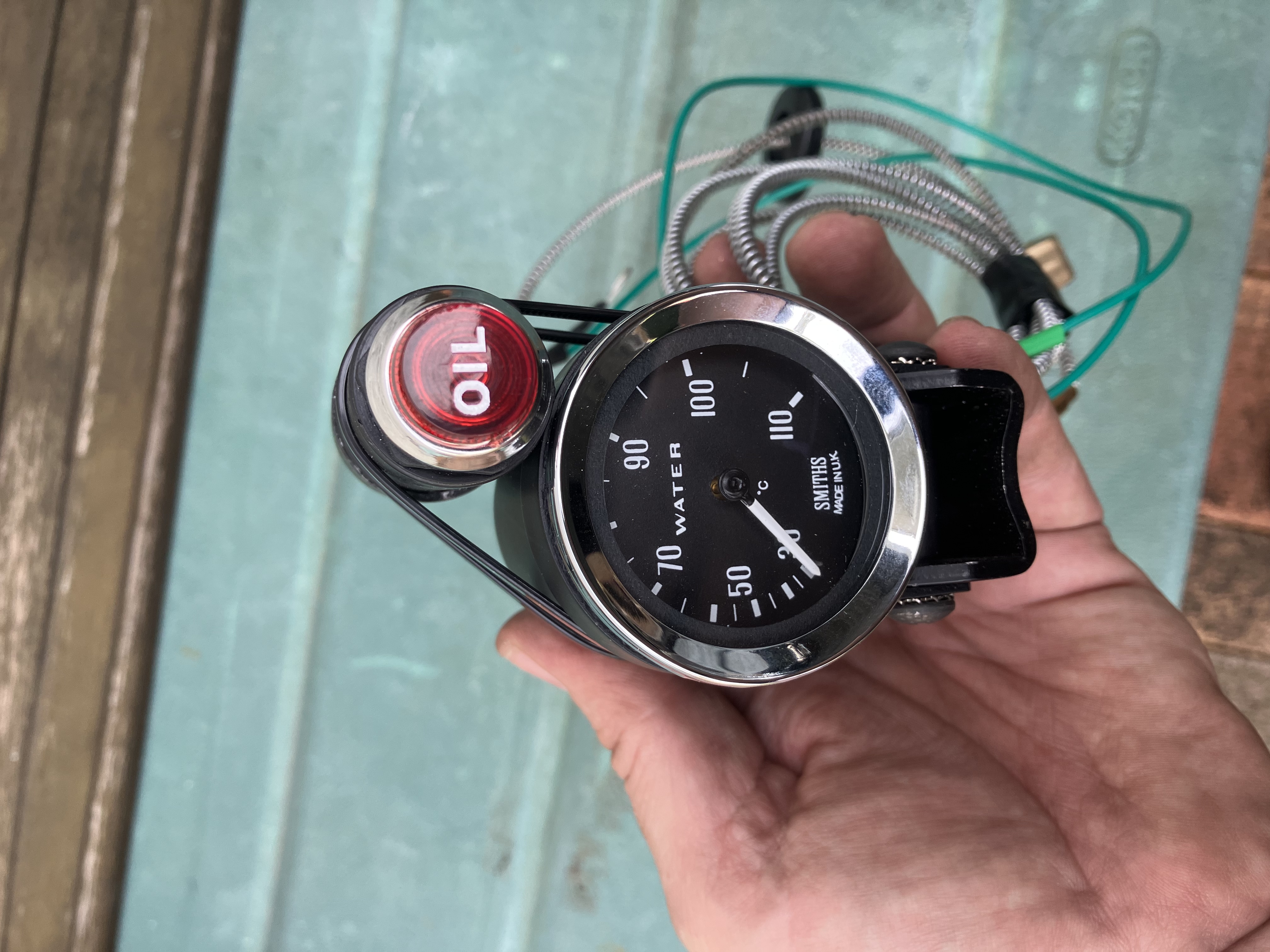

Warning stuff to sit on top of the rearmost rocker cover bolt (no gauge panel on a FED… no time to look down). Water temp for when I cook it in the staging lanes, and a big red flashing “get your boot out of it ya idiot” light.

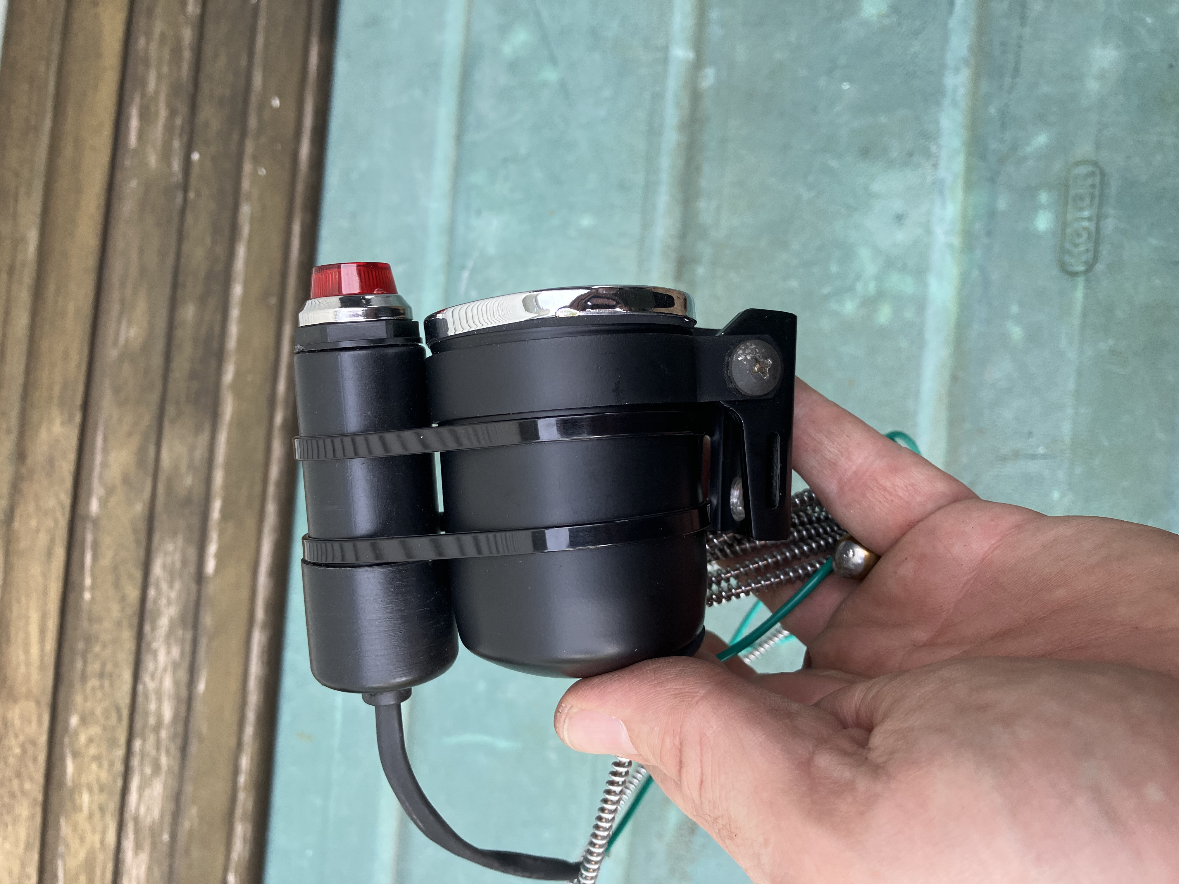

Are those nylon ties "period correct" ?
Dr erry
Posts: 5737
Re: Harv's FED thread
Dr Terry wrote: Tue Oct 04, 2022 8:51 pm Are those nylon ties "period correct" ?
I had some bailing twine, but figured that was overkill :lol:
Tried to think of a neat way to secure it without the cable ties, but failed. Difficult to bolt through, as the gauge takes up most of the real estate in the cup. Could glue it, but that didn't feel right either. Maybe some stainless panduit straps.

Hose clamp?

If that's a new Smith's mech temp gauge, be aware that the soldering on the sender of these new gauges can be of a very poor quality and are prone to fail. After mine died, I took it to a mech gauge guru, an ex-QANTAS instruments engineer I've known for years, who re-machined and soldered the sender after filling it with anesthetist aether. Cheers.
Posts: 5737
Ta - a good heads-up.
