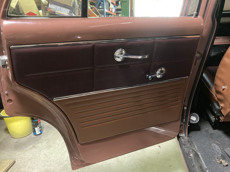

Nearly done,
Small fiddly bits now but lots of them !!!!
Door cards needed modification so the clips sit properly !!!!!
GRRRRR F@$%**&&%^%#$%^ testing my patience, so after a couple of days head scratching I decided to remove the trim and grind some material away to let the clips sit flush and not push against the vinyl on the inside.
Now I can move forward again !!!!!

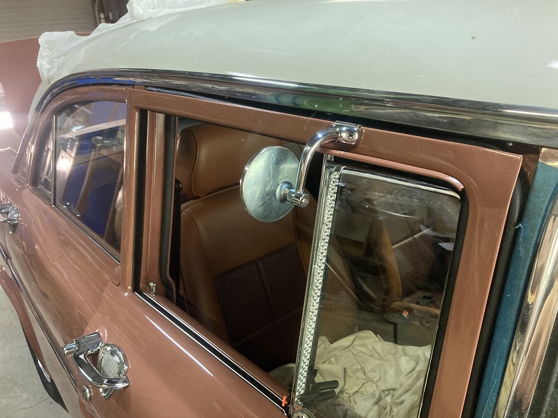

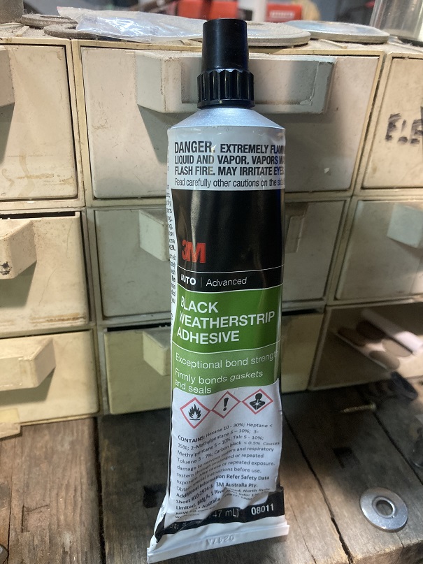

Chipping away with the limited time I have lately,
Glued in the quarter window strips, they seem to be a good fit although as we know nothing like the originals.
I used this 3m stuff, its like contact but black. I sourced it from a company called Blackwoods.
PS Steering wheel will be changed shortly.
Posts: 2800
Re: Chev EK
That's the stuff Greg I used it to put my window weather strips, bit on both surfaces, let it go tacky and it sticks like shit to a blanket.

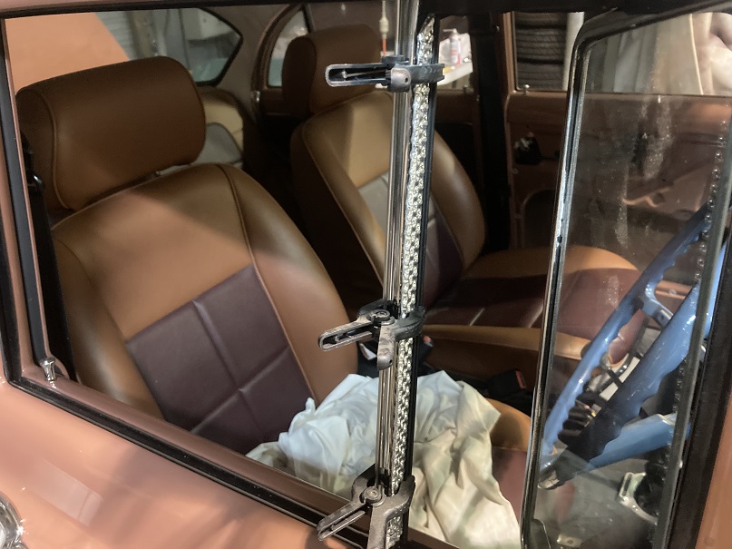

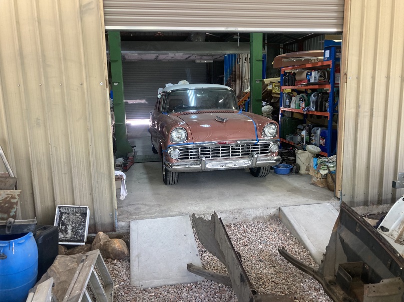

Peek a boo !!!
It wants to get out !!!!

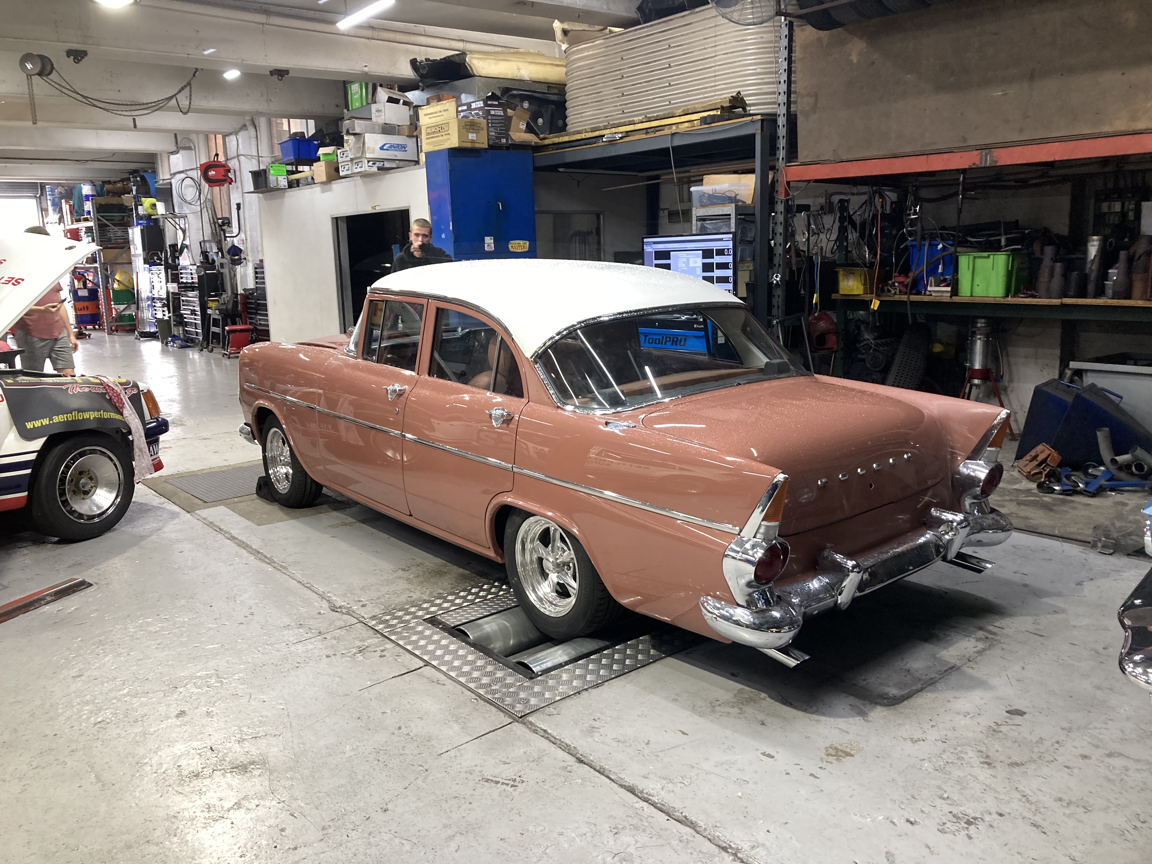

Hey, Hey where are you going ?
Sit next to my younger brother !!
Show him how its done !
Disappointing result actually, not as many ponies as i hoped. I experimented with this engine and put 305 heads on the 327 but unfortunately that has made it asthmatic. It will still cruise around ok but it does need different heads, not now but later in the year.
Engineering booked so thats the last hurdle I hope.
