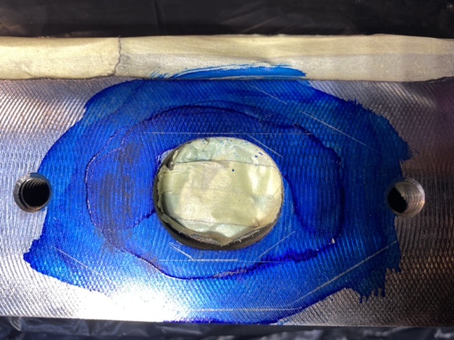

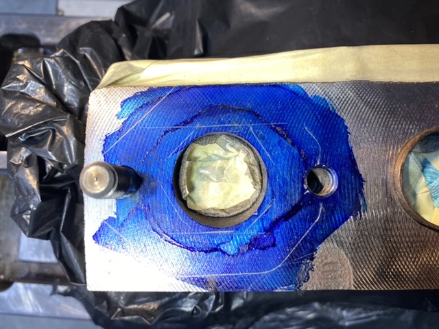

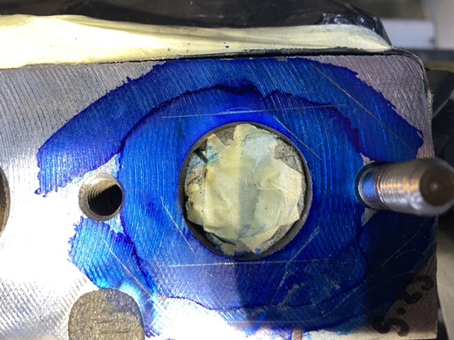

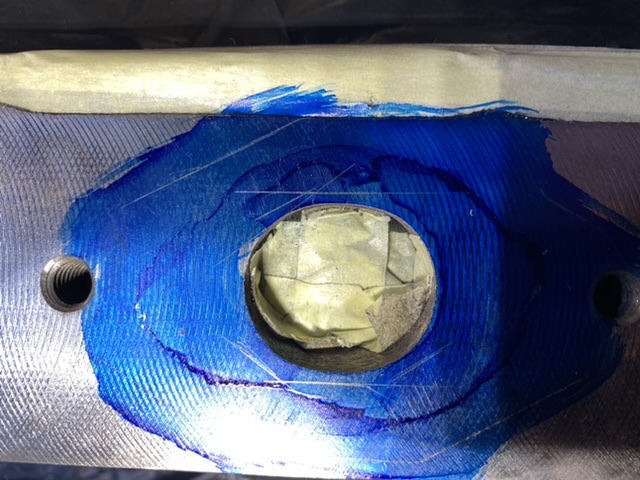

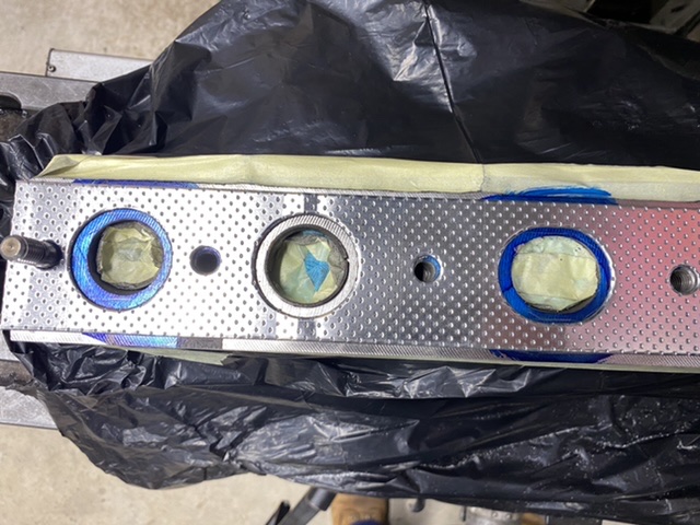

So I’m thinking there is no need to roll pin the extractors into place.
I marked up the manifold face and did some measuring and the extractor holes cover the exhaust ports nicely, so without complicating the process any further I am happy to know that the extractors line up with the ports in a good enough manner.
I was thinking they would be way off and roll pinning it in place would locate it correctly, but it’s not needed.
Happy I checked it, I can sleep easy on it.
I then layed the extractor gasket on the face and the port holes on that are so large and they clear the exhaust ports in a major way. Any mis alignment of the extractors to the head will be negated with this bogan of a gasket.

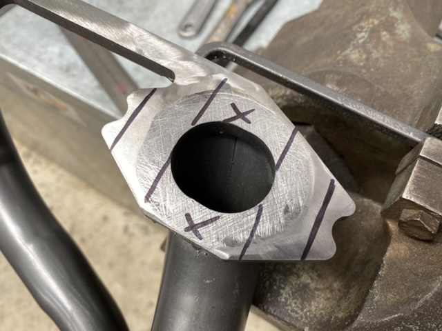

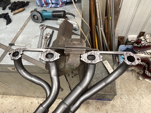

So feeling a bit better from this covid crap I’ve been out the shed yesterday arvo and this morning.
No matter what I try I can’t get the extractors sitting flat on the head when clamped up.
They have obviously been manufactured in a welding jig with high welding heat that has warped the flat faces of extractors.
I have relieved all the places when it was sitting and where there is no need for material to try to get it sitting down further.
It’s just the physics of meta and welding, it al moves.
The mating face really needs to be machined after welding ING there is no way I can do that.
Bloody pissed off having a .010” gap where all of the ‘x’ are in the photo.
Only thing I can think of is that some exhaust sealant and the gasket will somehow do the job.
I have seen so many time these extractor gaskets blow out in this exact positions and now I know why.
