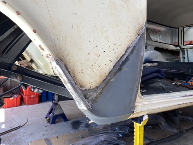

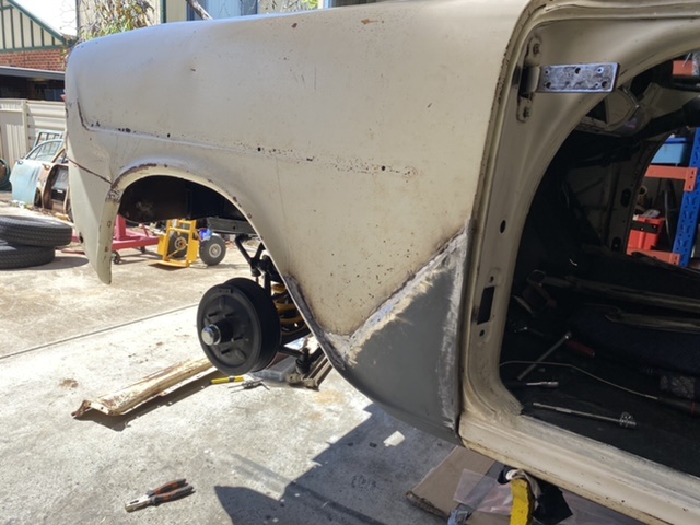

It’s not the worst panel repair I have ever done…
That is really saying something about how bad the others must be 🤣

Looks good from this angle Drew.
Any excuse for me to go see the old fella, specially when I’ve got the ute on the road. Though by the way second sounds currently I don’t know how long for…….

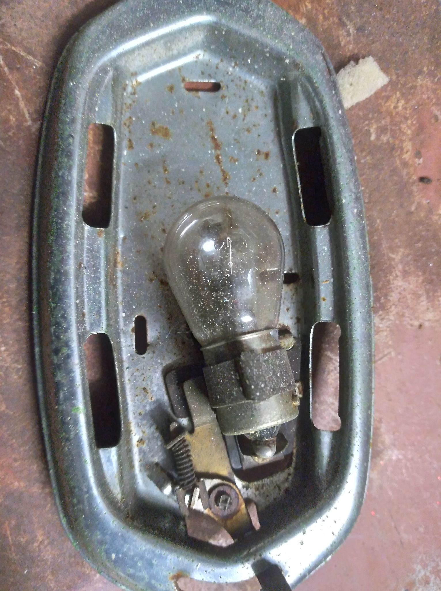

Mick if your interior light is complete just leave it complete mate, no need to strip a small part out and then be holding a light that don’t work.
you can have the whole lot if you want it just send postal address

Christ Mick, I’ve been sitting here trying to make excuses to my self to not accept your offer.
But it’s just my pride messing with me.
I’ll graciously accept your offer mate.
I’ll PM you now

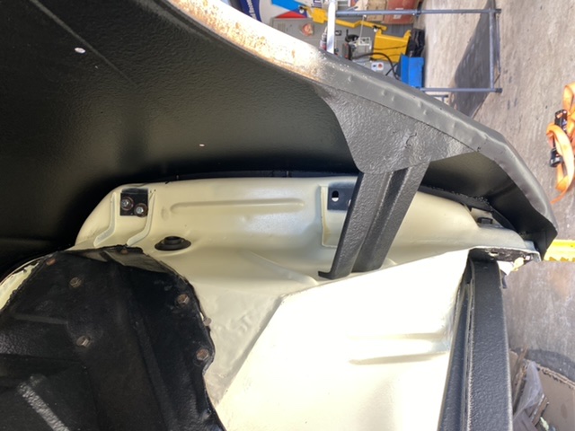

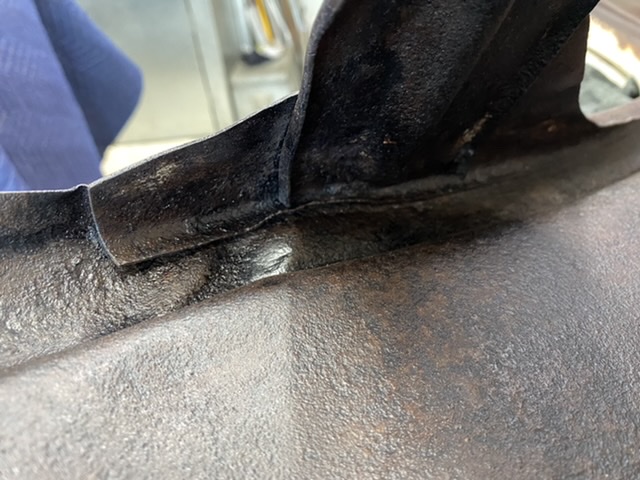

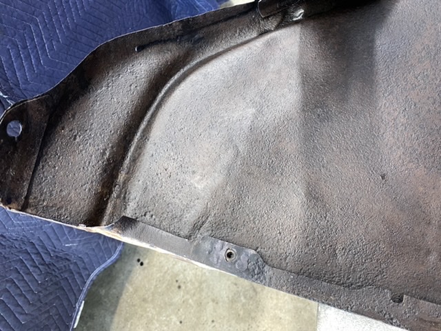

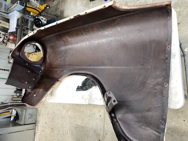

Hey boys I need an opinion.

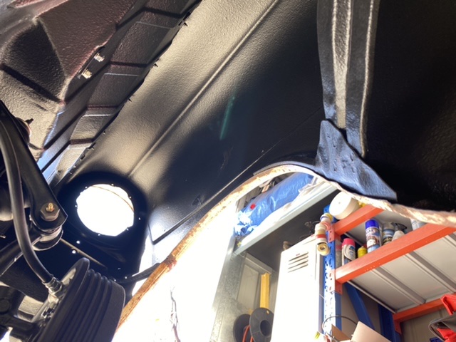

The guards have been treated with the Wurth rust converter and my plan was to etch and cover in water based stone guard.
That is what I have done on the rest on the underbody and front subframe.
But the guards are far from perfect and I fear that if I cover the areas shown in stone guard it may trap moisture in the nooks and crannies.
Options are
Etch and stone guard - uniform with rest of the car
Etch and GMH black so any moisture can escape and it’s not a shit show to work on for any future repairs.
My issue is I often over think things…
What do you guys think of the scenario?
What would you do?
Drew
Posts: 5734
Re: FB Standard Wagon
I'd vote for stoneguard.
Posts: 2520
My vote is for normal paint prep primer and top coat (chassis black perfect) and then one of the spray on stoneguards. Have done that on Wilma and will be doing same on project 2. Suggest that you seam seal what you can prior to stoneguard.
You are right though, revisiting later is a bit harder with stoneguard.
Posts: 11637
They look to have surface rust. If so I would simply brush paint with Metal Fix black.
http://www.phoenixpaints.com.au/product ... /metalfix/
Posts: 14242
are they going on and staying on or are you going to pull them off and knock them straight ? If you plan on straightening them up at a later date I would give the stoneguard a miss and just whack a coat of primer and chassis black so you dont have to scrape stoneguard off to do repairs later.
Posts: 2520
If you are only using a dolly and hammer, stoneguard won't make a difference. If you are heating and welding then better not. 😀

So cheers guys, it sounds like the original stone guard idea will be the go.
Brett got me thinking a bit, could etch / GMH black and then just stone guard the main parts of the panels and leave the other tighter areas free of stone guard.
But I know what will happen, I’ll go mental with the stone guard all over it.
Blacky these panels will just be what they be, they are going on and staying on. Any further panel work will mean paint and paint is a can of worms i don’t want to open.
So I’ll stick with the original plan and just get on with it.

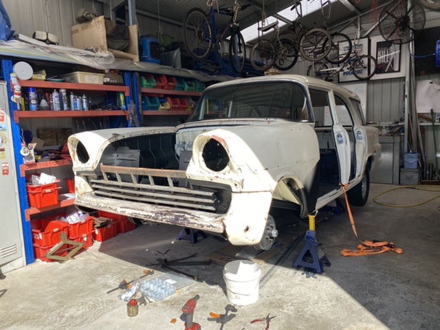

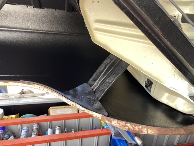

All right so a bit of an update… after some serious booze benders and shitty shifts at work I finally got back into the shed🤣
Front guards etch primed and stone guarded.
Happy enough with it so I’ll be moving on.
Fixed the guards in place and dummied up the grill to ensure it fits.
Good to see what the front will look like, now I’ll remove the grill to polish the stainless and GMH black the frame.
Drew

Looking good Drew.
