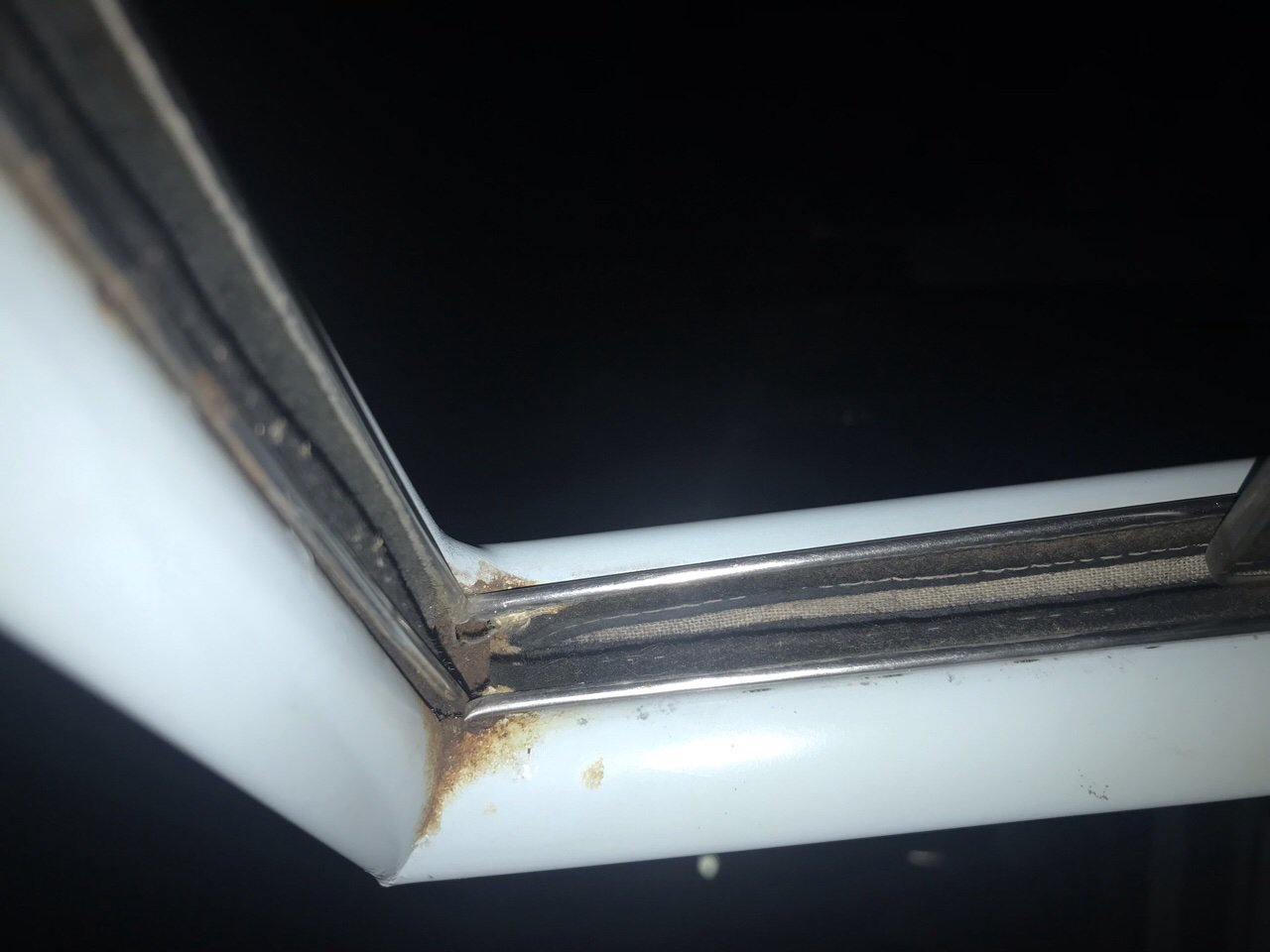

Do people bend the channel at the top corner, or cut into two pieces and push together? What was it from factory?
Posts: 11444
Re: Wilma FB project
I cut the sides at 45d leaving centre intact on the ute. On my sedan I just cut right through. You won’t bend it for a 90d corner. The rear window bends fine, as does commercial front window.

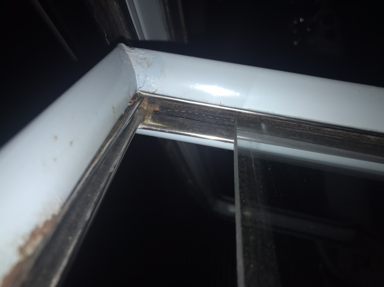

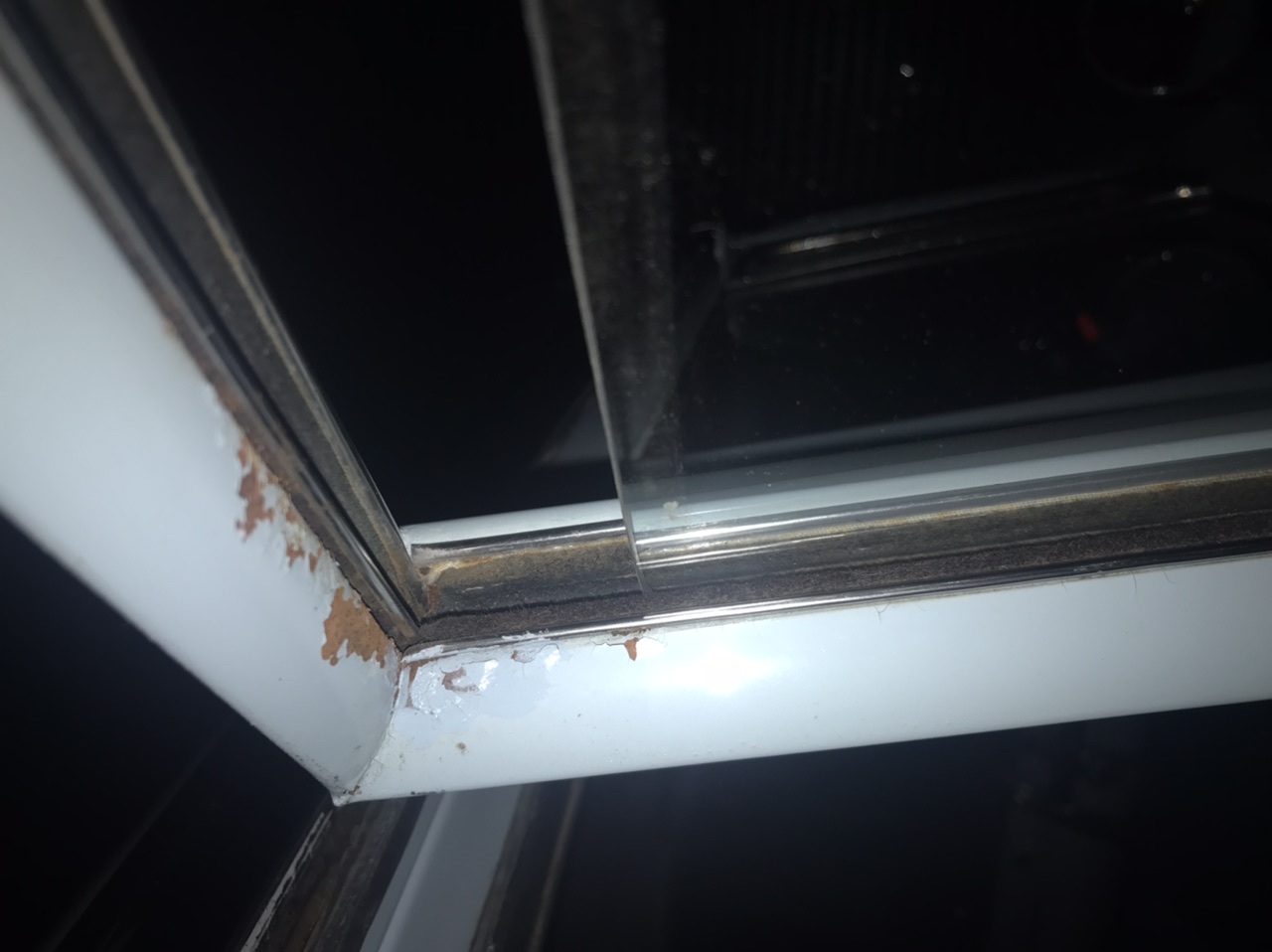

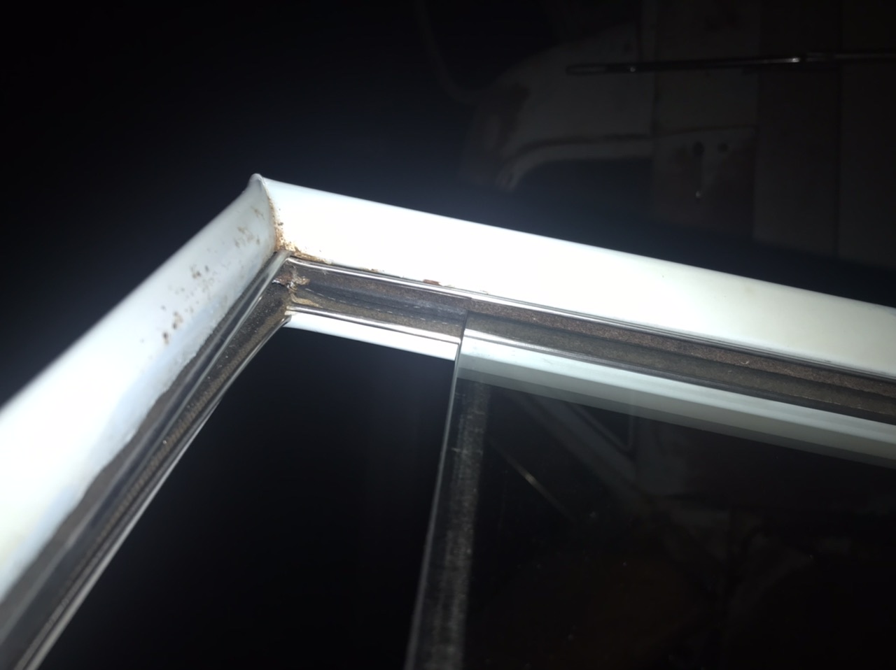

Post by Fex »
This is on my sedan. Original seals. Not sure if they were taken out during a closed door respray. Looks to be cut into seperate pieces? Sorry, head tilt required. But you get the idea..
Cheers, Andrew
Posts: 2492
Many thanks for the pics Andrew. Cheers Clay.
Posts: 11444
Rings a bell that I've seen the channels cut square and overlapped from factory. There would have been variation between assembly lines no doubt, but certainly seen on some Adelaide cars.
