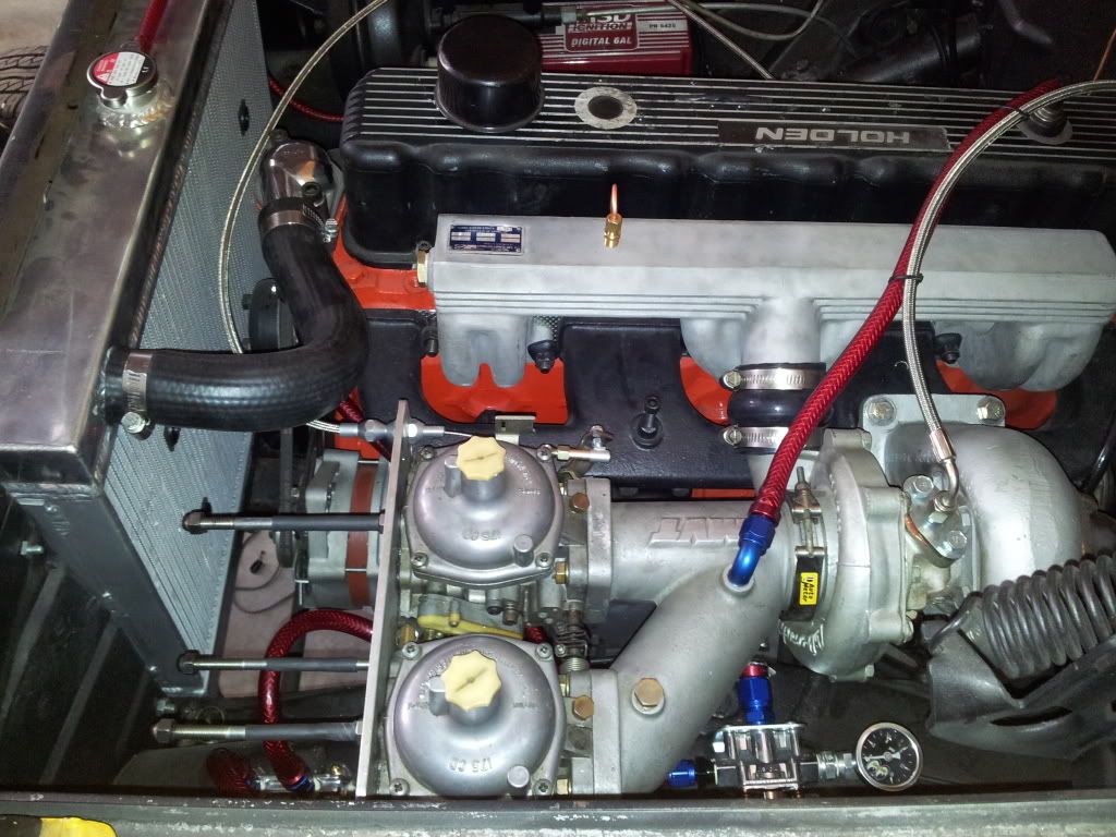

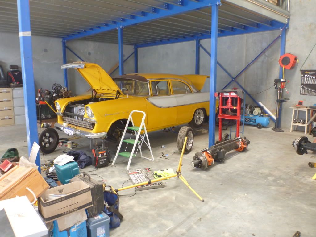

SO I got a bit done today.
But I possibly took three steps back - I snapped a spade terminal off the starter motor, which is obstructed by the manifolds, exhaust and turbo :(
I am hoping my auto elec mate can solder a wire on instead so I don't have to rip it all to bits to replace the starter.
I also chopped a fair bit out of the front guards which I think will help with the tyres rubbing around corners. If this is successful, I will lower the front end to its old height :)

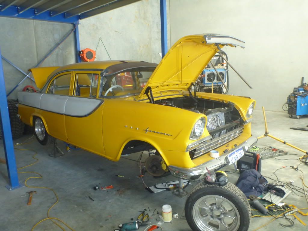

Getting sidetracked is the biggest problem Ben - those pictures don't show the 3 others cars at our unit also looking for attention :x

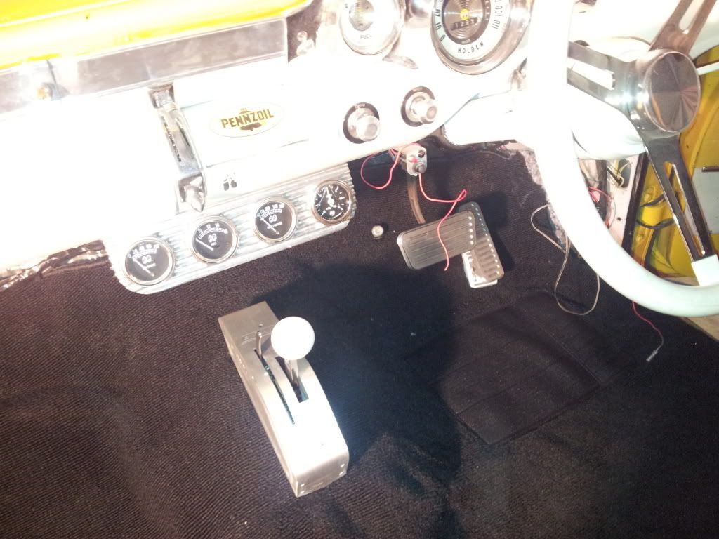

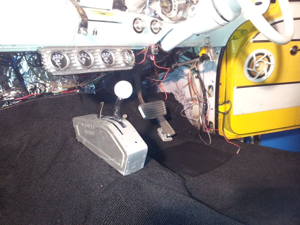

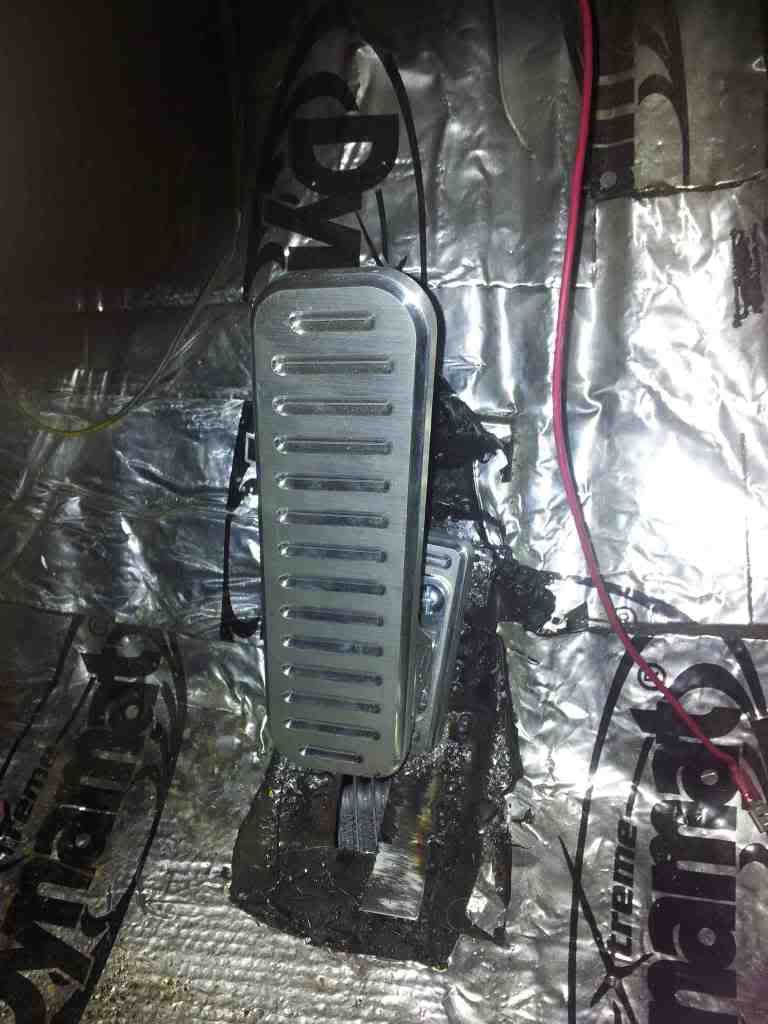

More done getting close now!
NoMAD
Posts: 1993
Re: "(AUST)Mod's Turbo FB"
Post by NoMAD »
nice pedal hahaha you need to bend the top bracket (underneath) so the cable is straight otherwise you may have snapping issues when you step on it! consider a spacer inside as well to give you as little more room of the rail
cheers

(AUST)Mod
Posts: 2272
Post by (AUST)Mod »
I have the spacer inside. Will bend the bracket

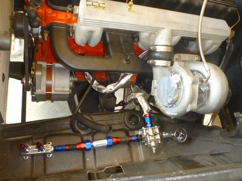

brad671
Posts: 13
Joined: Wed Oct 19, 2005 6:42 am
Post by brad671 »

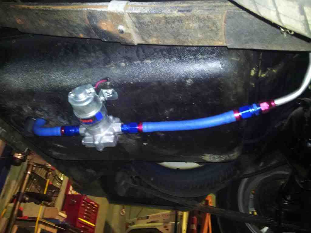

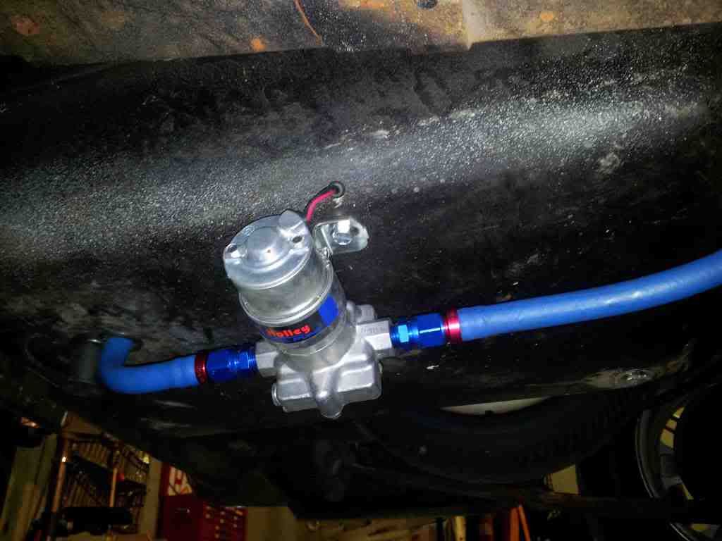

Hey mate,

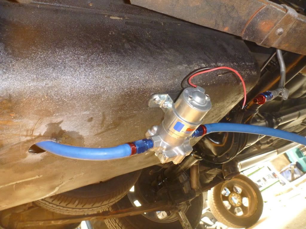

Nice setup however Holley fuel pumps are meant to be mount vertically. I think it is so fuel doesn't accidently run into the electric mount and go boom.

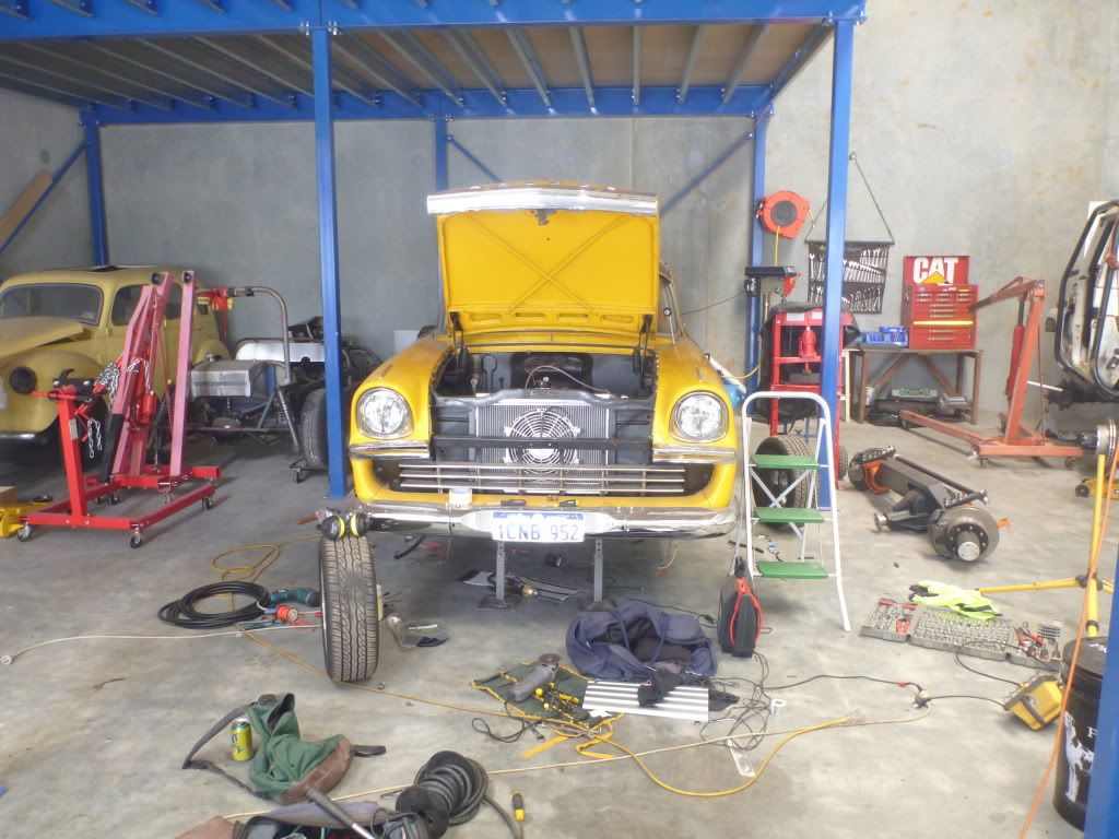

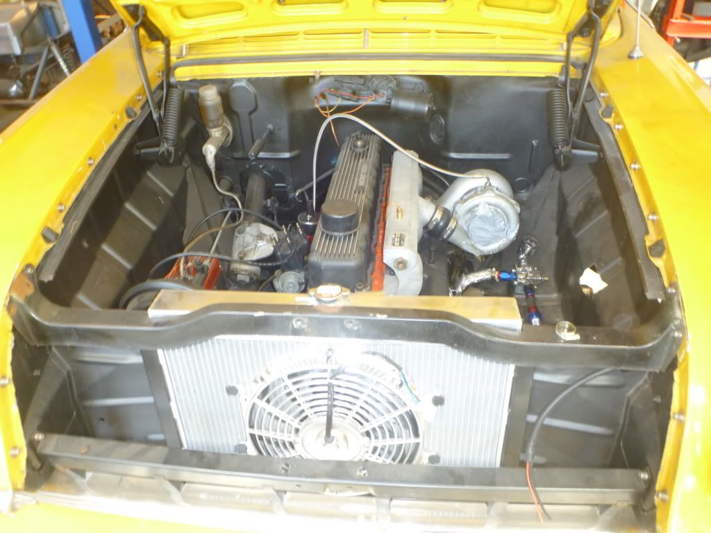

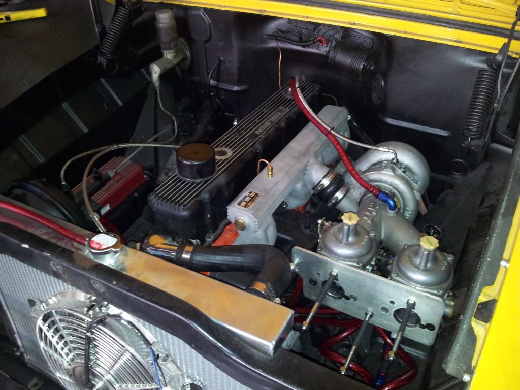

Put in a few hours today.....

(AUST)Mod
Posts: 2272
Post by (AUST)Mod »

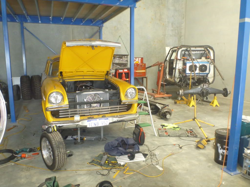

More mooneyes and socal on the way 8)
Didn't get to work on the car today - decided to clean the workshop instead. It was getting pretty feral!
I should be able to complete all wiring tomorrow and then see about firing it up.
