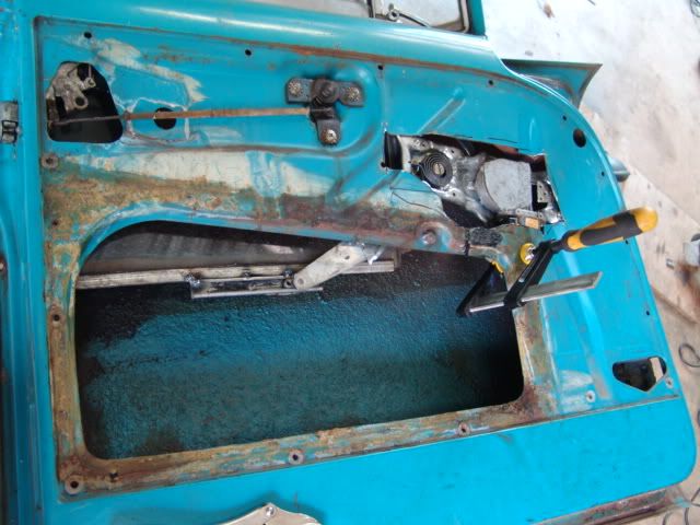

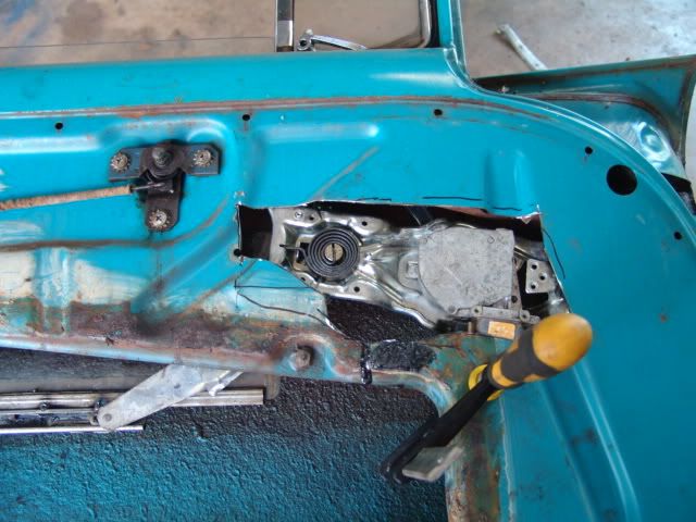

Power windows & Central locking

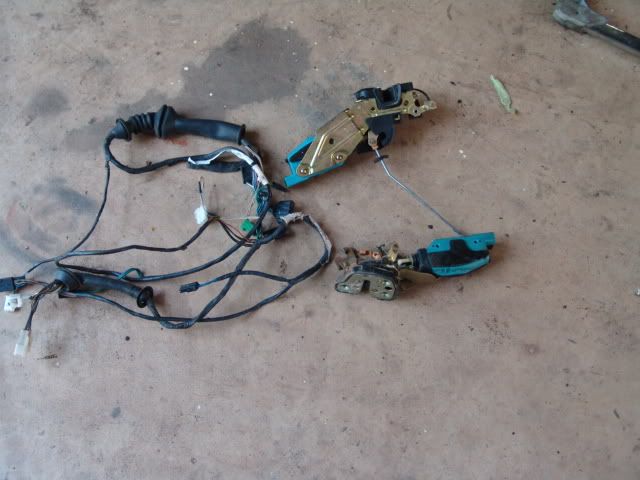

Went to the wreckers and got hold of the power windows and central locking from a VS commodore Equip.
I have rough (very rough) mounted the power window mechanism (after cutting and shutting the arm) for a "test run" to make sure it would do the trick.
also added slide from commodore to EK glass retainer....... after this it works great, very smooth and quite.
These are the central locking units and complete door wiring harnesses from the VS. I will us the harnesses as it has all the plugs etc... for both the power windows and the central locking and the weatherproof boots to go between door and body.
The cutout for the Power windows will be completely removed and squared off, then I will fold a flat plate with two return folds to weld back in place, once this is done the mechanism will be hidden behind the new plate. will post pics as I get it done.

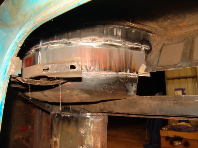

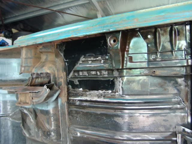

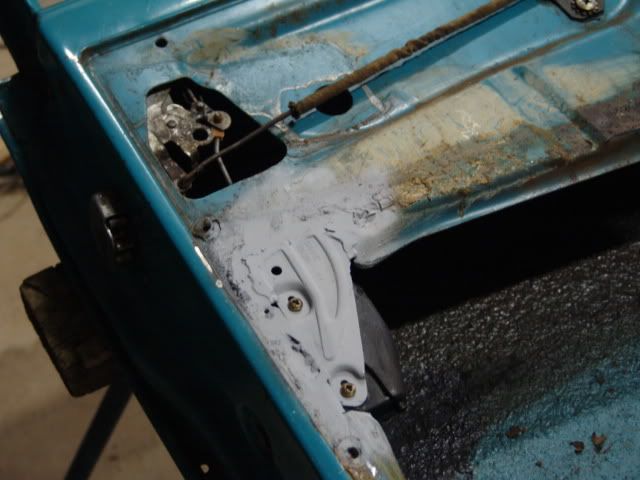

I have mounted the central locking from the VS .... used the VS bracket with a bit of cut and shut ... a bit of welding and grinding ... a bit of primer and hey presto, one central locking unit fitted!! I cut the link of the VS latch and welded it to the EK latch, works fine.
Closed in the tubs as well.
Still need to tidy it up ....
.... dont think the spider webs were fire proof!!!!
cheers

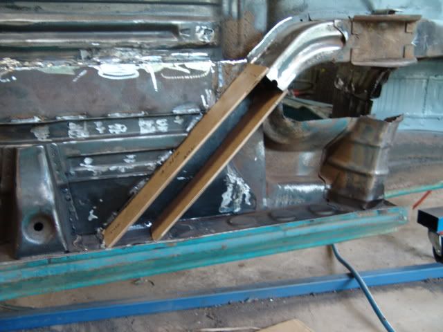

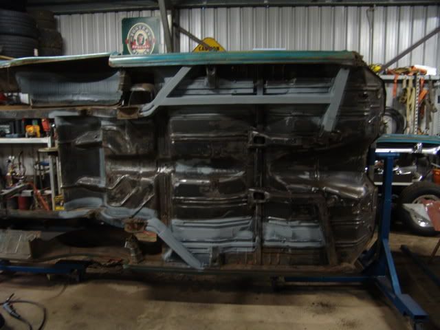

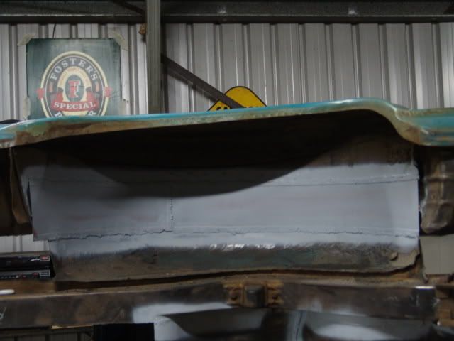

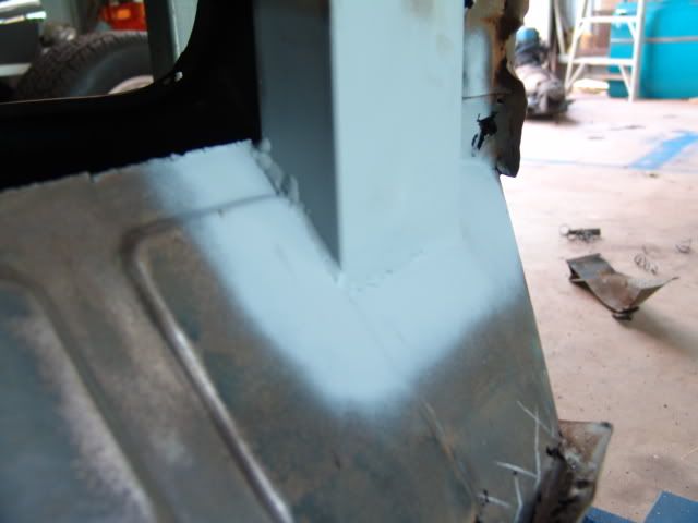

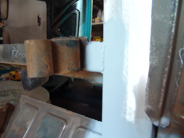

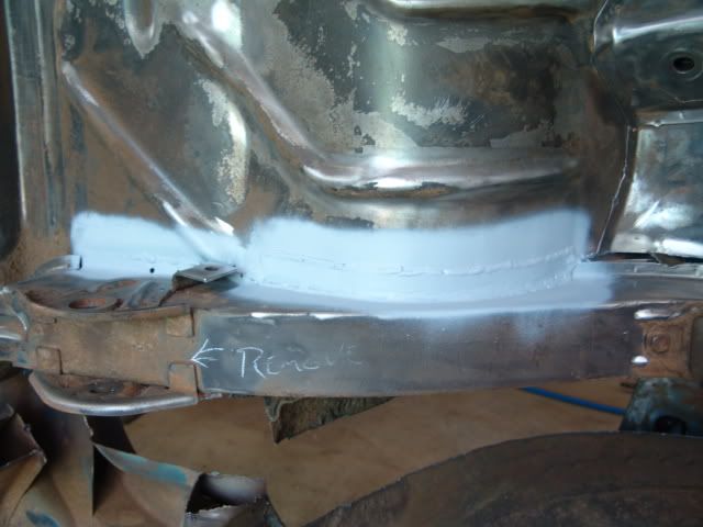

OK.... started the chassis mods/additions/BEEFUP

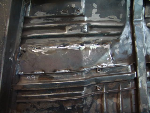

Had to do some more rust repairs first, replace section of floor before adding the plates that will carry the "new chassis".

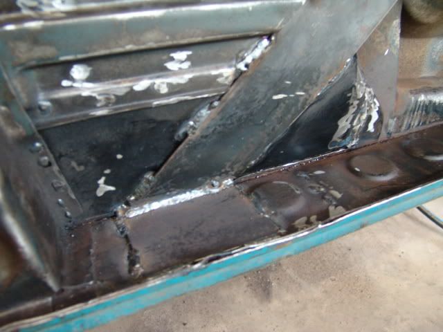

Then added the plate to carry the new rails and cross members... this is one of the front plates.
This is one of the back plates, also has the plate to carry the new section from the tubbed/relocated rail to the sill (as per the original setup)
This is the plate on the sill which will help lock in the new sub frame rail.

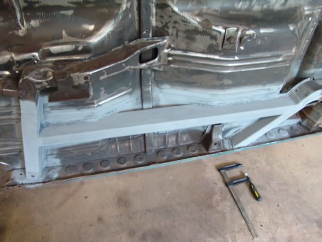

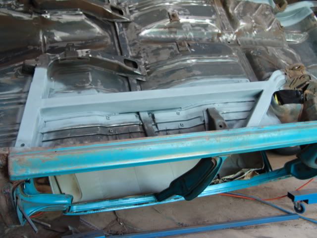

Who said cardboard is good for &^&%all!! Here are the trusty cardboard templates that were used to cut the "new sub-frame rail".

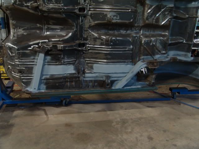

The new sub frame rail in place...........
New cross member stiffener on the front cross member.....
Both in place ready for chassis rail........
Oooohhh nooooooo!! the minister for War & Finance is home so I better chuck some primer on it and get cleaned up
chassis rails will be another day!!!
cheers, Garry

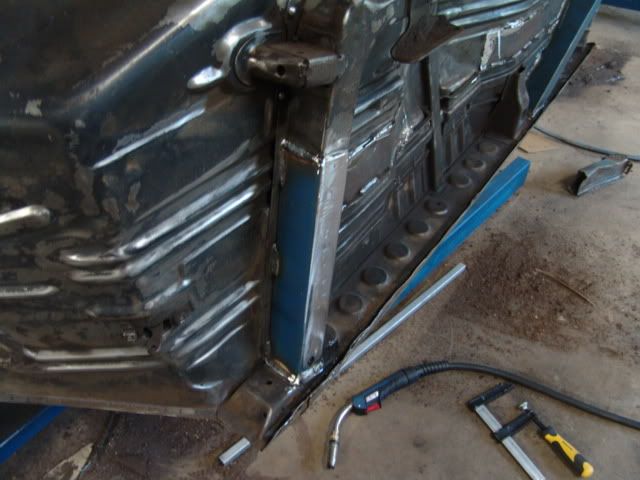

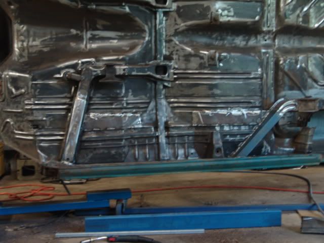

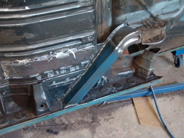

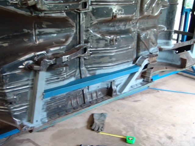

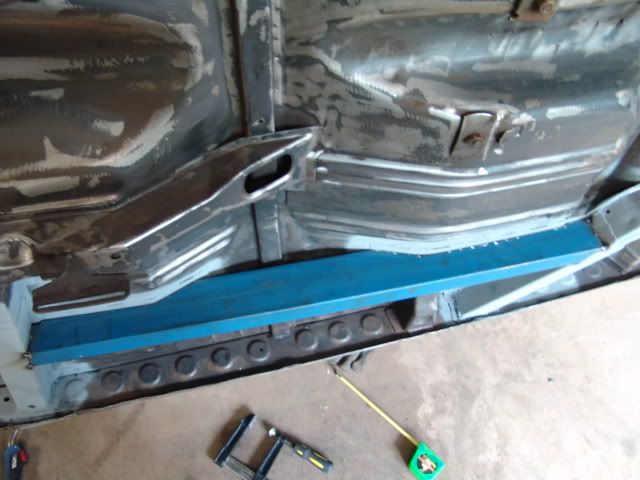

Main chassis rail notched to match floor profile and tacked in place....
Main rail fully welded.......
Started other side ........ missus is home....... must stop now .......
