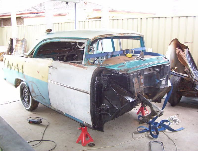

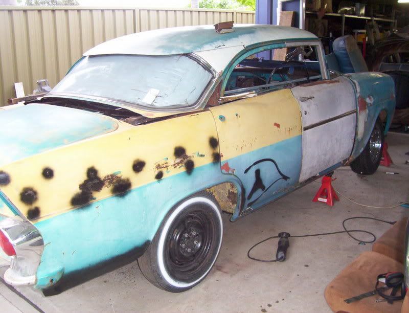

Man this is taking too long ,more thinking in it than expected around the parcel shelf and curve on the roof to keep the original glass ,
Ratbox did you weld the door frames to the roof ? or is it the roof frame squared off ? cant realy tell .

yeah i welded the door tops on then filled the gap
i thought if i did another one that i would use a rear window out of something else but wasn't sure what it would look like with the sides filled in, by sides i meen the wrap around part of the rear window

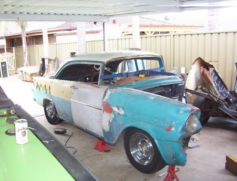

K then heres some more pics ,

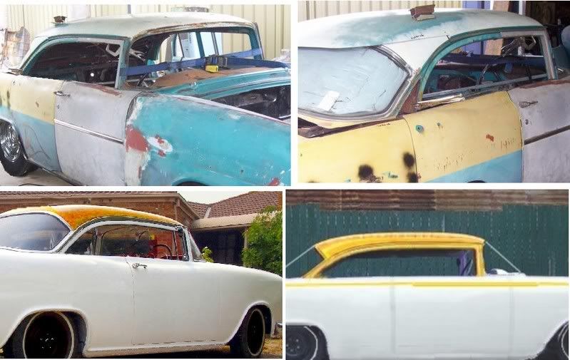

I measured and remeasured my photoshop concept and the chop on it is somewhere between 2 and 2 1/2 inches and if you look at the pic its photographed from below the roof line which is giving a false impression.
When I marked it up I put a squared line at 2 and 3 inch marks so I could cut the 2 inch first and have a look at it to see if it works .
Its not working for me as yet ,I need to get a car out the way so I can see the side profile better and lower it down to get the correct ride height.
My cut on the rear of the roof could have been in a better position also so I think I will have to add a little and delete a little further back to allow it to drop more . Another half inch lower at the front and 1 inch at the back me thinks .
This pic below is photoshopped down so its easier to see the proportions.

Nup after doing this comparisom I think I still need an inch out of the front and 1 1/2 out of the back.
Can you guess the third car in this pic :)
