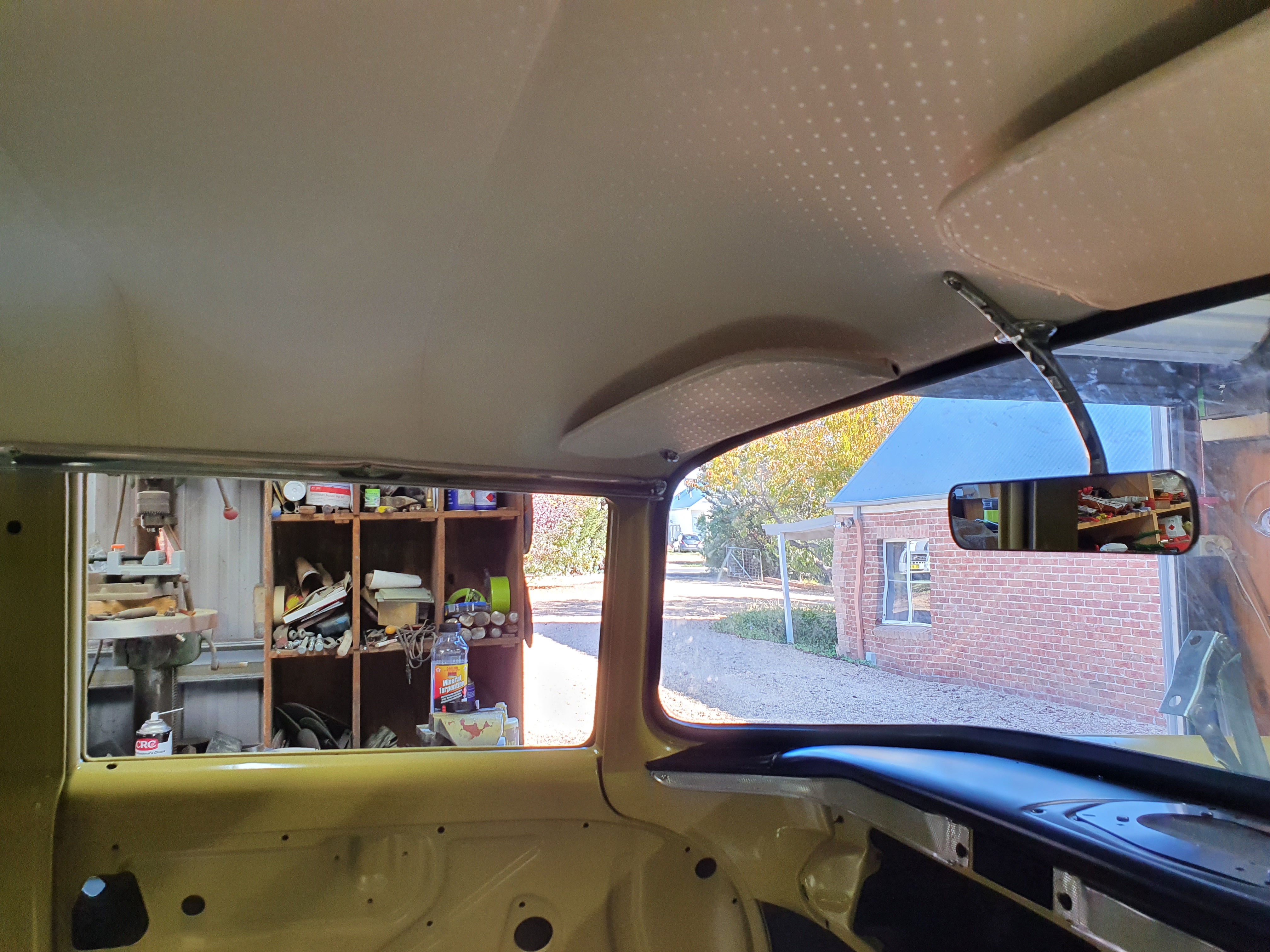

Spent a few days on headlining, windscreens and bits and pieces of interior. Having lots of trouble with rear windscreen, taken it out once to have another go and may well have to take it out again and refit it tomorrow. Top and sides fitting perfectly but bottom is stubbornly 1/4 inch away from sitting properly in the channel.Will have another crack at it tomorrow. Frustrating time all round. Front windscreen is sitting nicely fortunately.

Got it in this morning 😀. Aimed the heat lamps at it to warm it up and went to that big hardware place and bought a suction cup thing for glass while it warmed up. Splashed a lot of soapy water in the rubber and channel and it finally seated after about twenty minutes of juggling. Put upwards pressure on it using the suction cup which is a lot more effective and safer than hands pushing on it, and that and lots of tapping with the rubber mallet persuaded it to finally go all the way in.
Will continue to tidy up headlining and put the upholstery on the wheel arches as next jobs.

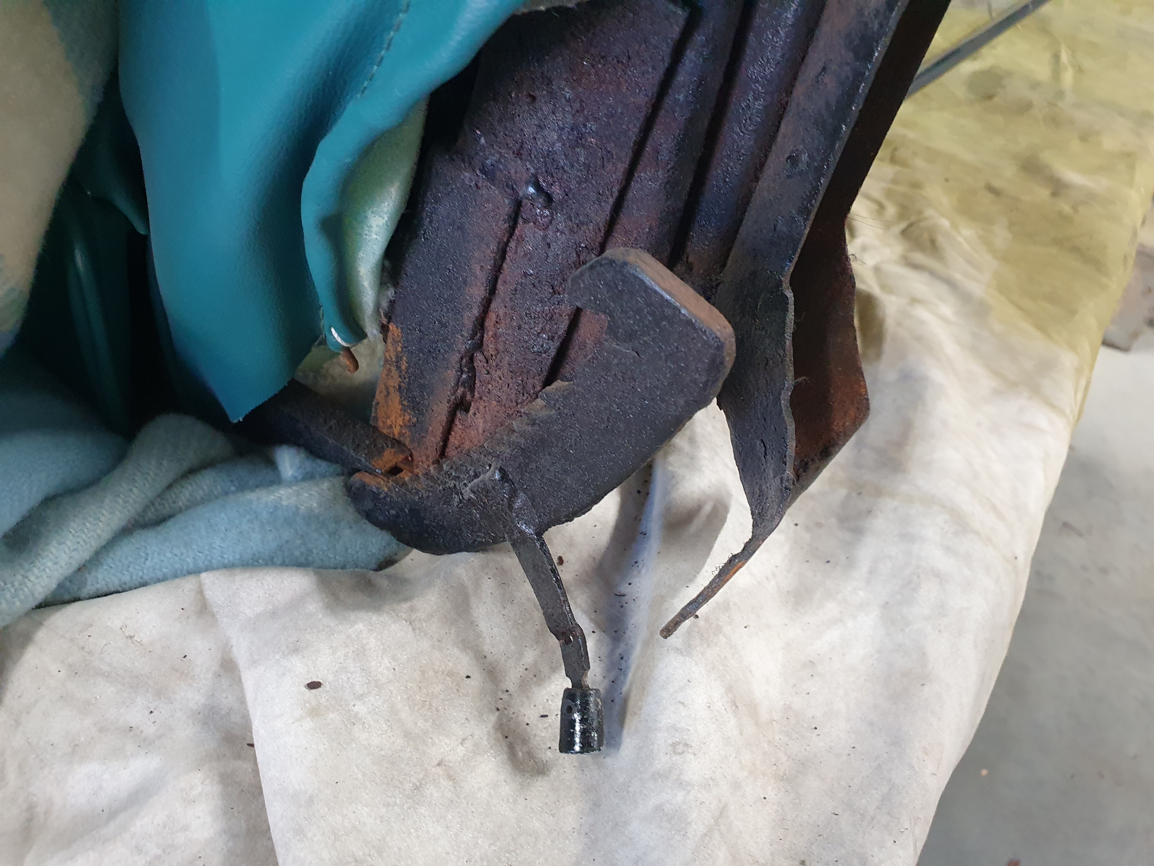

Today's inane question: Do FB seats have a back angle adjustment normally?

Your front seat back rake adjuster is high-quality bush-league equipment.
I'd suggest concealing it when you get the car blue-slipped.

Wot?? NO! On the seat adjuster. Could be a variation on the lay back picnic seat. They seem pretty agricultural from what I've seen.

ardiesse wrote: Wed Apr 21, 2021 3:06 pm Your front seat back rake adjuster is high-quality bush-league equipment.
Thats the NASCO "overnight camping option", available only on FB/EK Shooting Landau models. :lol:

It seems like a pretty thorough job on the seat adjuster. There is plastic tube on the joining rod and the pawl/ratchet thingmy is well made too. Haven't worked out how the metal corner covers work with it, but that is coming up soon. Have to paint them first. Have a bit of rust work to do on seat too.
I am looking forward to having the seats back in 'cause crawling about on that floor pan is killing my ancient kneesImageImageImage

Looks better in that photo. They are sought after.

Brett027 wrote: Wed Apr 21, 2021 5:03 pm Image
the small hole on the arm attaches to a spring that releases the sliding mechanism so that the seat slides forward as you lay it back

Many thanks Patrick. I didn't know about those things. I will post picture of seat surrounds next time I go to shed, but assume(hope) they have been cut for it to have worked.
