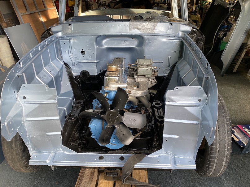

I got the engine and trans ins without too many issues but the my exhaust was one.
Headers and inlet manifold fitted no trouble but I had to rely on my memory as to which way the muffle went on ( off set one side at one end ) and which way the middle pipe went.
I had it off and one more times than I care to amitt. A tip for those who intent to make your own exhaust system, fit the shockers ( I changed the angle to miss the sway bar ) and the sway bar mounts before finalizing the exhaust pipes.

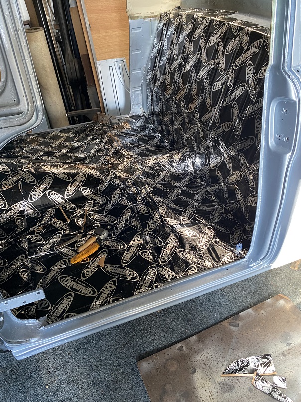

My pipe is very close to both but will work. Mitch gave me a hand with the Dynamat today. He is much more flexible than I am.

Love it Roger. That is a serious looking fan. Looks like it could be off a later viscous clutch fan.

I got the fan off of a VC commodore starfire motor.
2 extra blades should help.

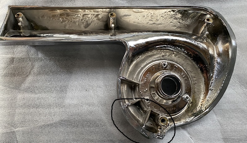

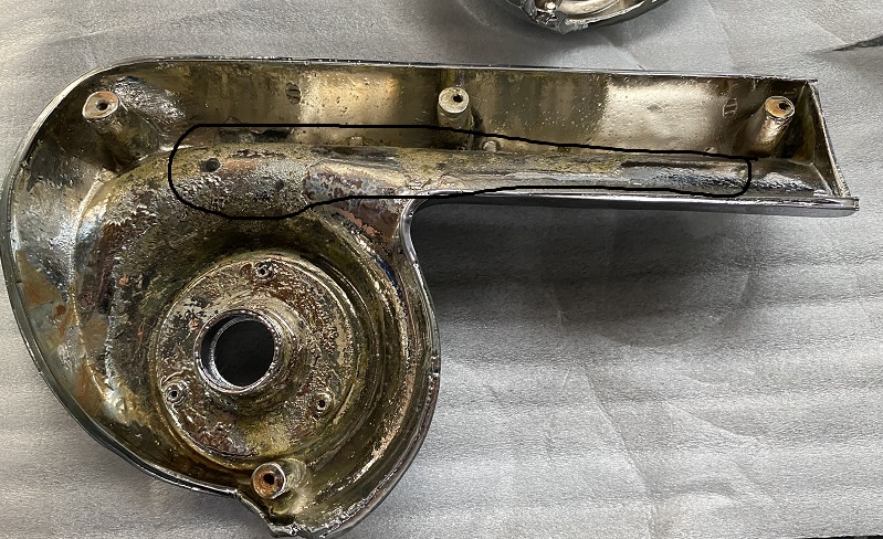

I had an issue with the chroming of front indicator surrounds at A Class Plating here in SA, so I grabbed a set of Retro Richard and sent these to Wizard Class Chroming in Queensland.
5 month later
they arrived back home and I'm less than happy with the results. There are small indentations on the front surfaces that should have been corrected during the plating process but I can live with those.
RH side has some material added which suggests the edge was "eaten " away in the acid tank.
The LH side has not been washed correctly of the cleaning solution and has dripped out of the screw holes, which is causing flaking of material and will need to be fixed. Will probably grind off and silver zinc paint. Their website reads "Home of the diecast Wizard " but my results suggest differently.
A class Plating has correct their processing issue and rechromed the first set at no cost so I have a good set for the ute and a spare set as wall art.

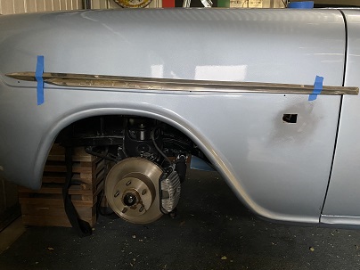

I have a pair of front guard trim off an FE that I may add. As it is too long I had go at cut and TIG weld but lack the skills to weld this thin stainless.
So I decide to cut and form the end on a old piece of trim
A quick file and grind and looks ok

looks good on but i can see an optical problem with it because there is a line in the guard and the strip slopes up it's always going to cause the optical illusion of not being put on straight will always look like it's sloping up or down depending on which line you choose to follow
