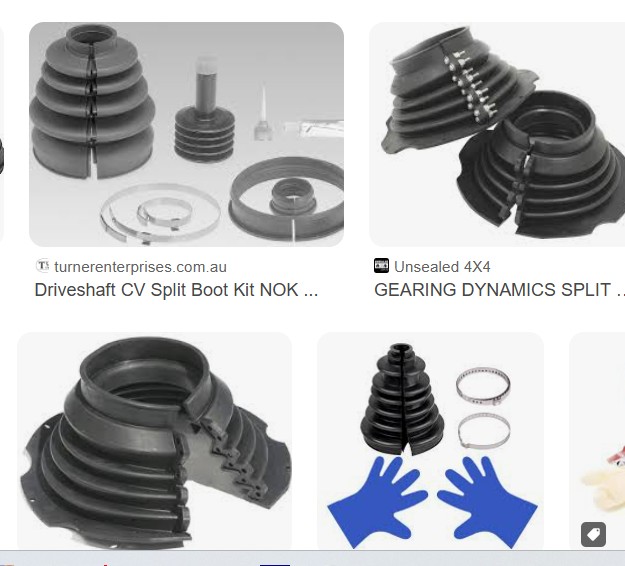

With all the fancy stuff on the market, it still surprises me that you can't buy a CV/balljoint boot with a closeable seam to allow it to be installed (wrapped around and sealed) with the joint intact.

You mean these Andrew?

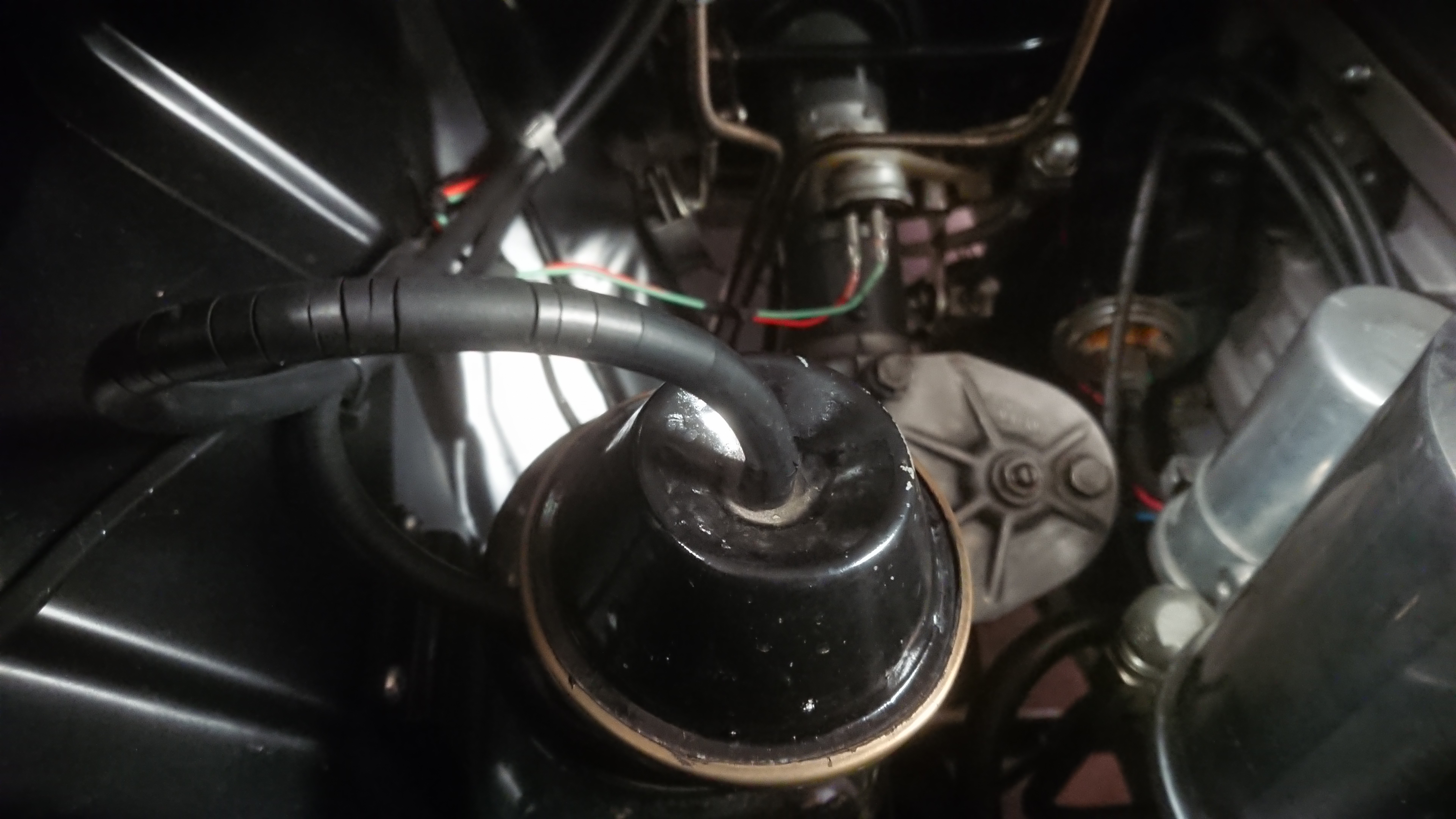

More knackered rubber bits. I'm wondering if detergent is doing the damage??????

Craig Allardyce wrote: Tue Apr 21, 2026 4:52 pm You mean these Andrew?
Ooooh.... I like those 8) . I learn something new every day.

Craig Allardyce wrote: Tue Apr 21, 2026 6:58 pm More knackered rubber bits. I'm wondering if detergent is doing the damage??????
I know AI isn't everyones cup of tea and that a little bit of knowledge is a dangerous thing etc. but I asked Gemini what causes rubber to degrade in a sunless environment.
1 - Ozone. - Causes chemical chain scission, the result is surface "crazing" or small, deep cracks perpendicular to stress.
2 - Heat - Causes thermal oxidation, the result is hardening, cracking, loss of flexibility.
3 - Fuels and oil - Causes solvent swelling/Ozone inhibitor extraction from rubber, the result is swelling, becoming "gummy," or excessive hardening after evaporation.
Didn't delve deeper but the cracking looks like ozone ( lack of ozone inhibitor ), so either #3 (if not actual chemical oil, maybe oil from skin?) is allowing ozone to break it down, or its cheap rubber with a lack of the ozone inhibitor.
Pure speculation but it would be leaning towards cheap rubber if it is happening in a range of situations where #2 of #3 might not be a factor.
