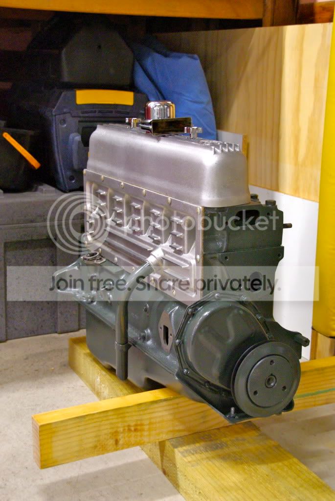

gday all.
maybe should have posted in christmas thread, but i was pretty lucky..

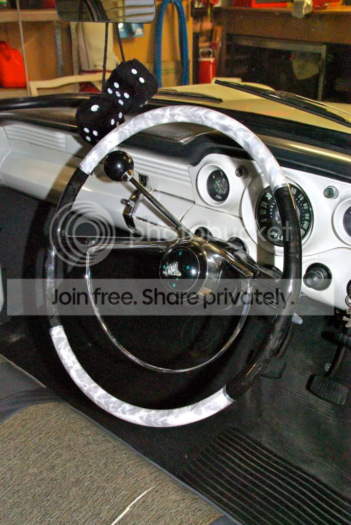

reco'd steering wheel by pearlcraft... awesome !

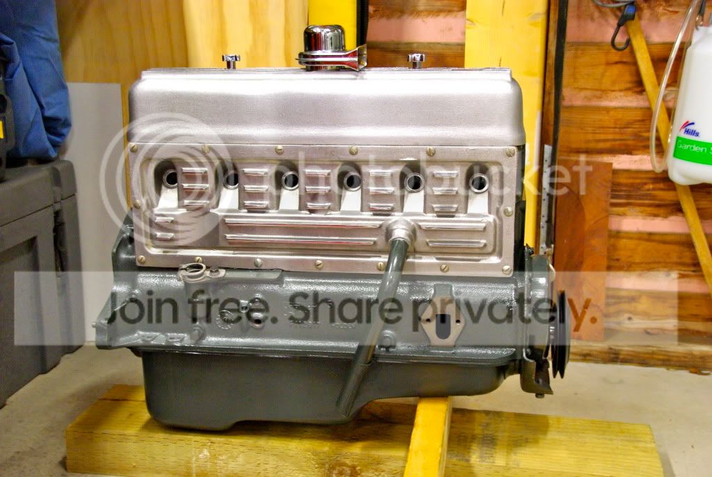

and a gift to my self.. a reco'd grey:
new spring set
new welch plugs
new harmonic balancer
clutch kit
cam bearing set
main bearing set
valve regrind gasket set
piston and ring kit (3.125 bore dia.)
head crack tested and grind
lightened flywheel
camshaft reprofile to wade 240 (34/74)
bore and hone block
inlet valves (1.490 dia)
exhaust valves (1.270 dia)
conversion set
and steel timing gear
full balance

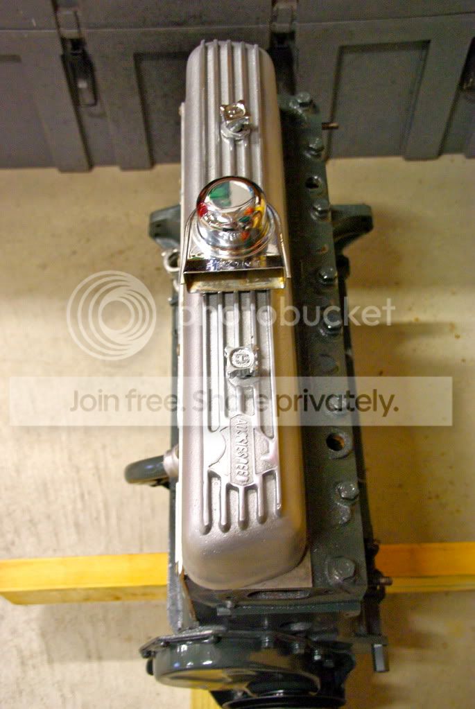

aussie speed sideplate
aussie speed rocker cover
brass h bolts
and aussie speed headers !

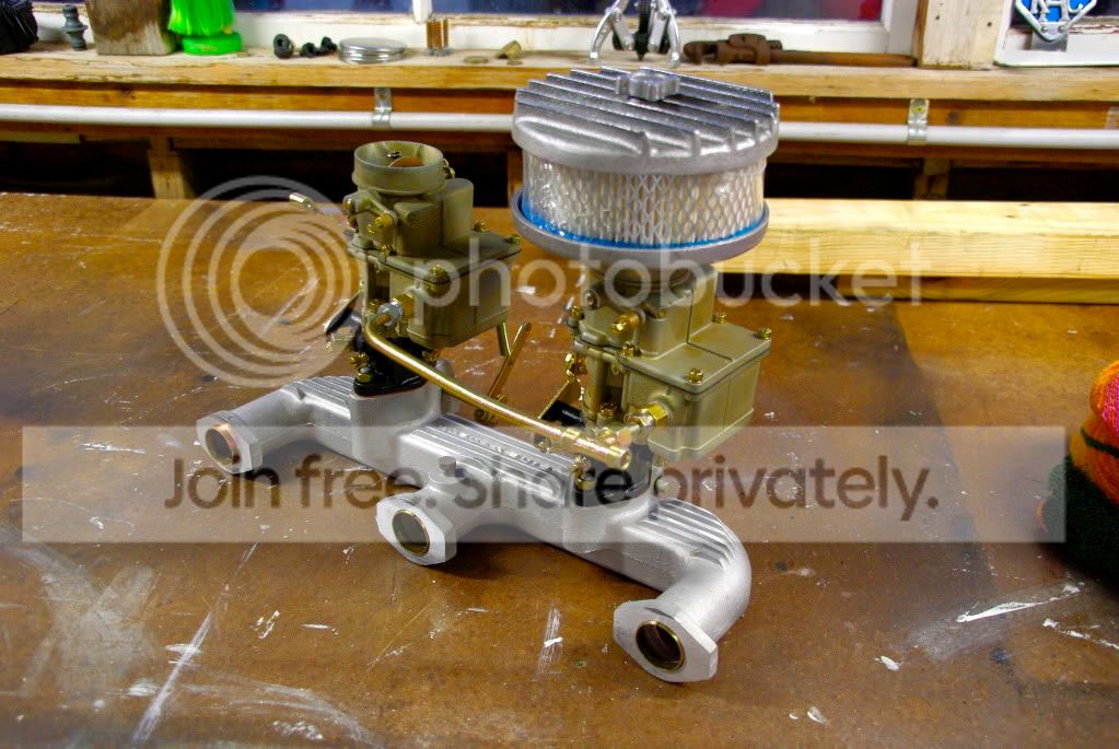

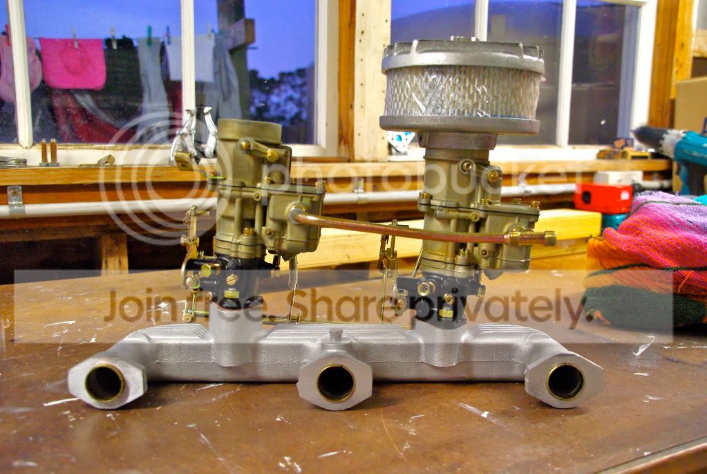

reco'd twin strommies with aussie speed filter heads
drop it in over the next week or so and see how see goes !
pics shortly !

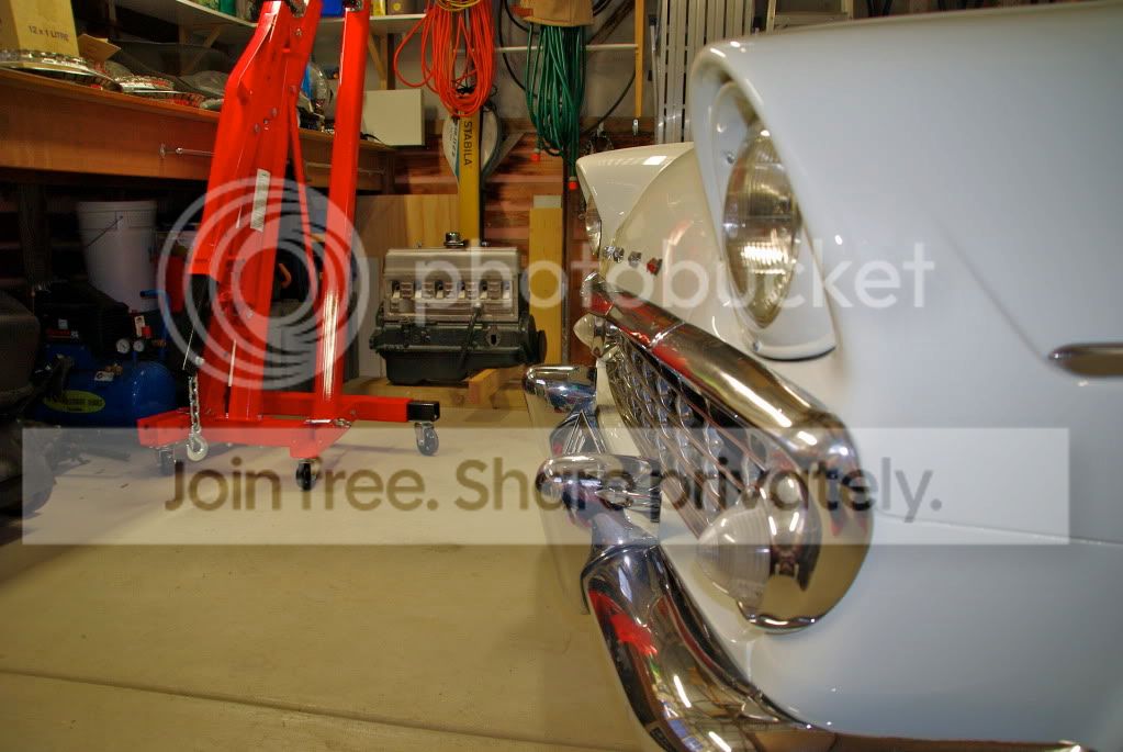

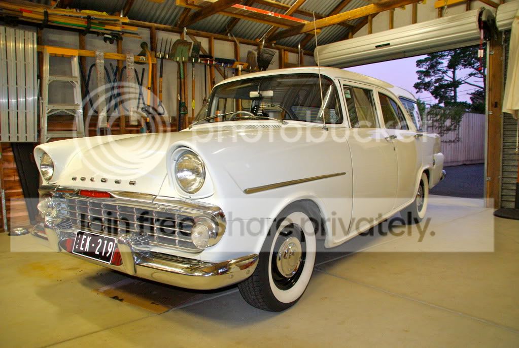

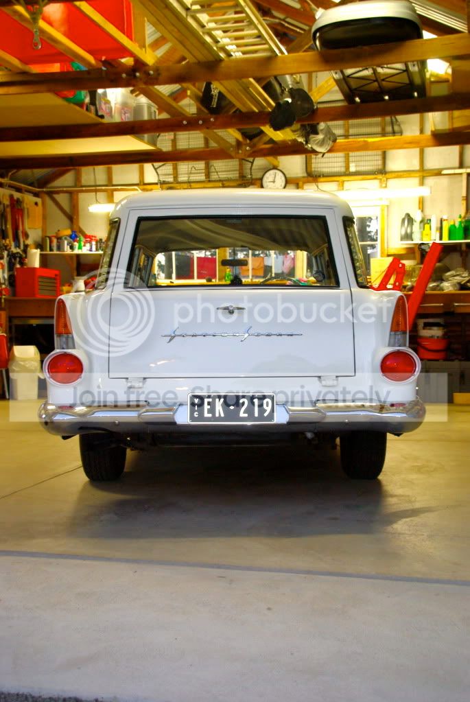

pics of the rebuilt grey, pearlcraft wheel and the wagon after a polish 8)

Sure looks like you had a good Chrissy!!! 8) 8)

Sweet motor :D
That is all going to look real good when together 8)
Very Nice :wink:

Nice work! That steering wheel is cool 8) 8) ...... is that done by Pearl Craft?

That steering wheel looks fanstatic.. specially like the colour combo... The rest of the gear looks smick too!
