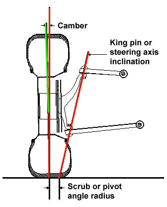

What rims are you running on the front? I'm thinking that they are wider than standard which is causing dramas with the King pin touching.
I'm not a fan of spacers for various reasons one being that they cock up your scrub radius with respect to tyre to ground contact.
Simply the centre line of the wheel and tyre must meet at the centre line of the king pin at the point the tyre touches the ground. Pushing the wheel out further makes for extra tyre wear and heavier steering. This is one reason why wheel offset is so important on the front relative to steering geometry.
Cheap way around for you would be go to a narrower rim (standard) or maybe 14" rims to give clearance.
The other costly option would be to ditch the front end for a HR/HD with standard springs and fit dropped stubs. This will position the wheel higher and still retain correct suspension travel and bump clearance.
One other I have seen in trucks is to have the king pin re-bent i.e. increase the angle between king pin center line and the top pivot. Hopefully after that you would be able to compensate for adjustment by reducing the camber angle.
I'm not sure that I would be increasing spacers due to the lack of wheel stud length and increased loading placed on them.
I forgot to ask, is the king pin touching or the wishbone? If its the wishbone touching, what was your camber angle set to? You may have some adjustment there to push the rim away from the wishbone depending on your camber angle.
