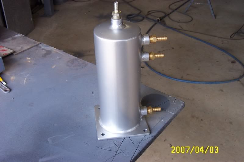

I've always been known for over kill when I do anything. Anyway I've finished the surge tank, I guess its shinney if you look at it in the sun and squint but you won't see it either.

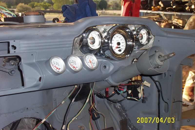

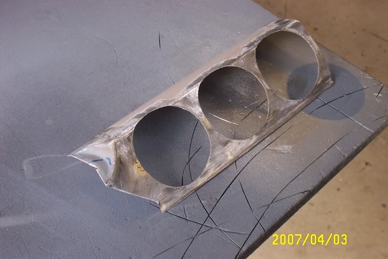

Just a couple more pickies, I have a few guages that I wanted to fit but didn't know where to put them.
So what I come up with was, I don't need a choke anymore or choke insert and I can do something else for the heater controls, so I got a spare glove box lid for the profile and welded in a few bits of tube to house the guages and welded it into the dash.
See what you think.

Thats a really neat job there Mal, sure beats the old under dash add on ones.
I personally wouldn't do it to my car but it fits with the modern style that your going for, keep up the good work :D ,

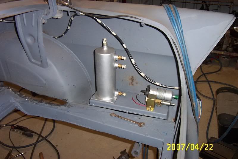

i guess if the surge tank doesn't leak then who cares if its shiney :)
very nice gauges, i have been wondering what to do with the choke and wiper controls as they wont be needed, i was thinking of just filling them over the same shape as the rest of the dash, if i do i will definately be chasing a spare glove box lid!

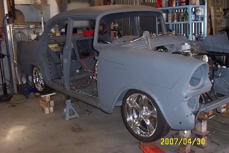

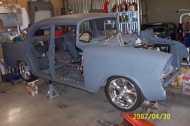

Finally I got my wheels from the US, fitted tyres now just trying to get an idea of ride height.

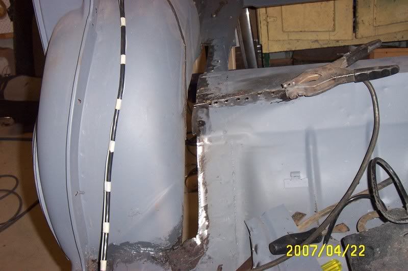

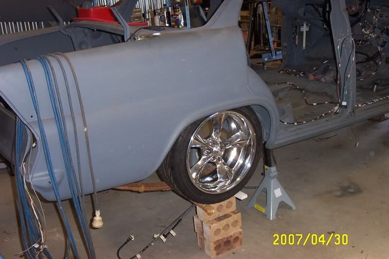

Greg, I went with your idea and widened the rear tubs for clearence. I removed the lip on the chassis totally and pushed the wheel arch out to suit.
The wheels are Boyd Coddington Junk Yard Dogs 17x7 with 205/40/17 up front and 17x8 with 235/40/17 on rear. With the rear inner guards done I've got heaps of room both sides of the wheels now.
I've also got the surge pot and pumps mounted, just have to finish running the fuel lines and fit the charcoal canister somewhere. Then it will nearly be time to turn the key and see if it all works.
Finally finished the wiring now with all electric windows and central locking done.
So just a few pickies.

Hey Mal,
The pumping of the inner certainly works a treat! In actual fact the wheel tub is larger the higher the wheel goes up from factory. Removing the lip just squares it off ( Like I said now 300mm from tub to lip ). The tub job is relatively easy and your diff width is now easy to obtain and no wheel scrubbing tops!
Got to love the wheels Mal and I think low is the go!

i like the wheels!
looks like its coming along nicely .... nice rats nest of wires going all through the car where they never used to be :)

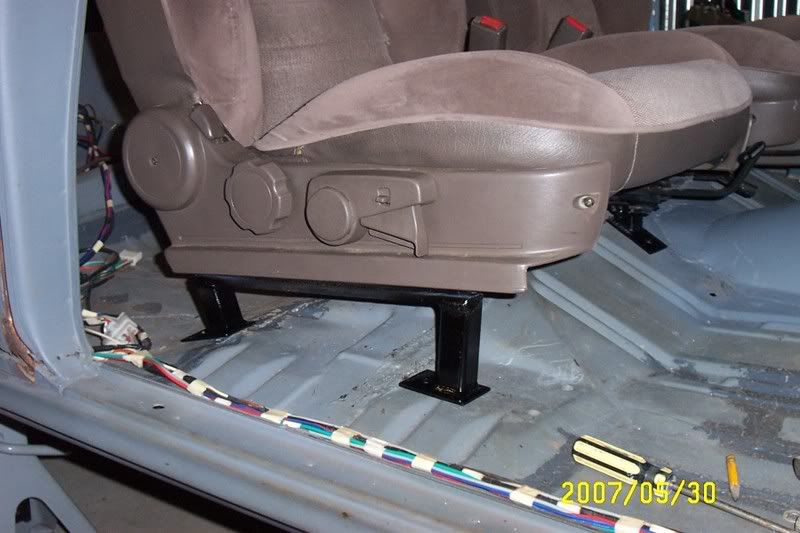

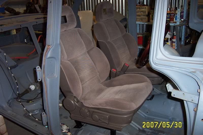

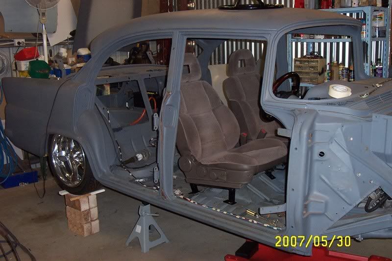

Once again I copied another forum members great idea and have now got the front seats fitted. I ended up using Mazda 626. They were really easy to fit and are ever so cumfy.
Just a couple of pickies of the seats.

You will be happy with the seats Malcolm they are very comfortable with heaps of adjustment (which I needed for the ute).
I lost the headrests on mine when they were reupholstered-see if your engineer will allow it!
I reckon headrests look a bit out of place on old cars even tho bucket seats weren't original also, but if you keep them the ones you have are a better look than tombstone type!

Hey I had those in my Wagon , same colour too :)
