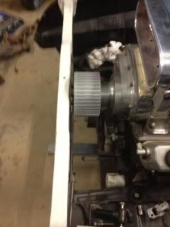

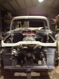

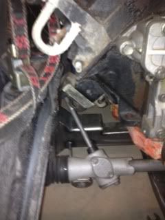

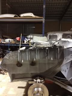

some updated pics for everyone.I have installed a southern chassis works front end .Ive got to make some new engine mounts as the steering shaft goes through the engine mount as it sits.Ive got the motor sitting on a piece of 35 mm timber.I would like to move the motor back another 15mm so will have to modify drivers side alittle bit .Ive done the passenger side will take pics on weekend

what about using an engine plate to mount it Fat?

You'd reckon for the money those frontends are, that a bit more homework to allow for both steering and engine mounts would have been done. Bloody shame, it'd probably have great clearence if you put the grey back in it. :lol:

Could you make an engine mount boss out of flat plate, boxed with crush tubes that has a hollow underneath to allow steering clearence? Excuse the bodgey drawings but something like this.
Or an engine mount boss like on a CRS front end, but built to allow the clearence required, that I have highlighted in pink.
Posts: 4286
Re: Moon fb
that's pretty much how my mate has done a few now, flat plate bent that the engine mount actually sits on withtube welded to underside for bolt to go through
