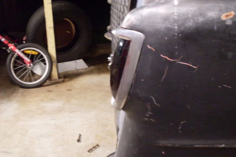

got the sides finished off and smoothed ,now just gotta blend in the rip cords at the bottom :)
and the tail lights arent supposed to be so black
