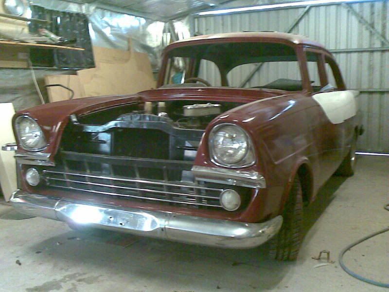

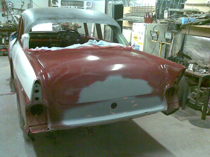

mega update :roll: havnt been on here in ages :oops:
I wasnt happy with the colour, it was too red, it needed to be darker, just a few shades darker :roll:
heres the new colour, more of a burgandy
painted in and around the boot, wasnt as straight as i wanted so a few repairs
And heres how she sits now
the only other thing iv done is a heap of mdf work in the boot for the sound system :D im not into doof doof but i like to feel the music :lol:

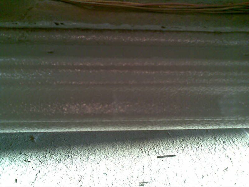

fb cruzn wrote:got a bit more done today :D
i also stone guarded the sill's :D
heres a close up to show the ripple effect.
Hey Mark, just discovered ya post, Wanted to ask a few questions regarding Stone garding the Sills???
Why did u do that? Ive seen it on a few cars but didnt really realise why? is that added protection?
How did u do that?
Ta
Sam

thanx for the comments guys, sam i used the stone guard because i live 30ks from town and i will be using the fb a fair bit.
even once its dry its still a little 'soft' so im thinking it will take the impact of the stones and rocks etc and wont chip.
the stone guard i bought from super crap auto for about 30 bux and i bought the spray gun from them as well for about 30 ish bux, its all k&h brand (i dont like k&h coz most of there stuff is shit)
the spray gun screws to the top of the container of stone guard, it doesnt have to be thined down.
i use this stuff everywhere. the whole bottom of the car is done in stone guard. :D

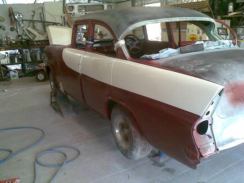

update......
started buffing the RHS, glued the door rubbers on the RHS on started bolting front shiny bits on :D 8)
getting close now :roll:
