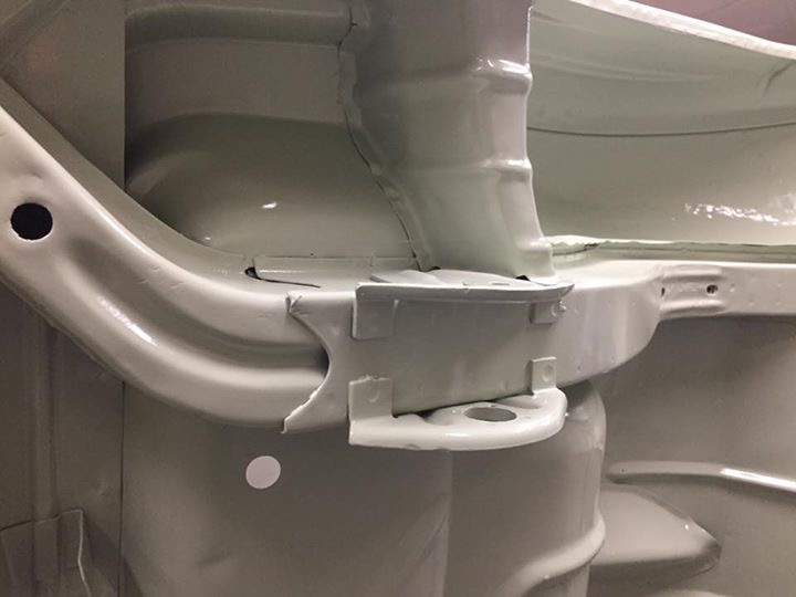

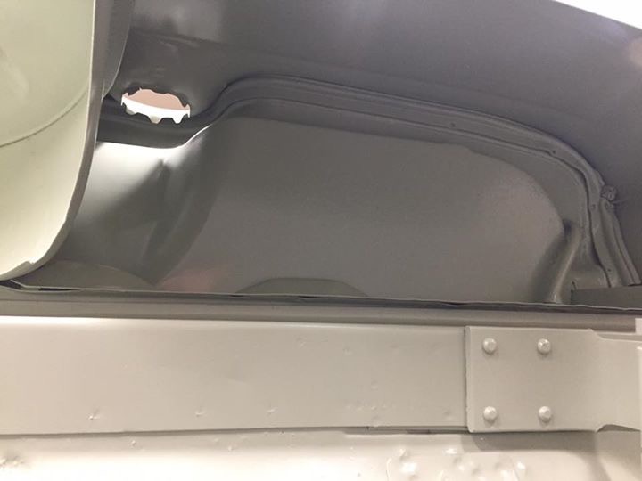

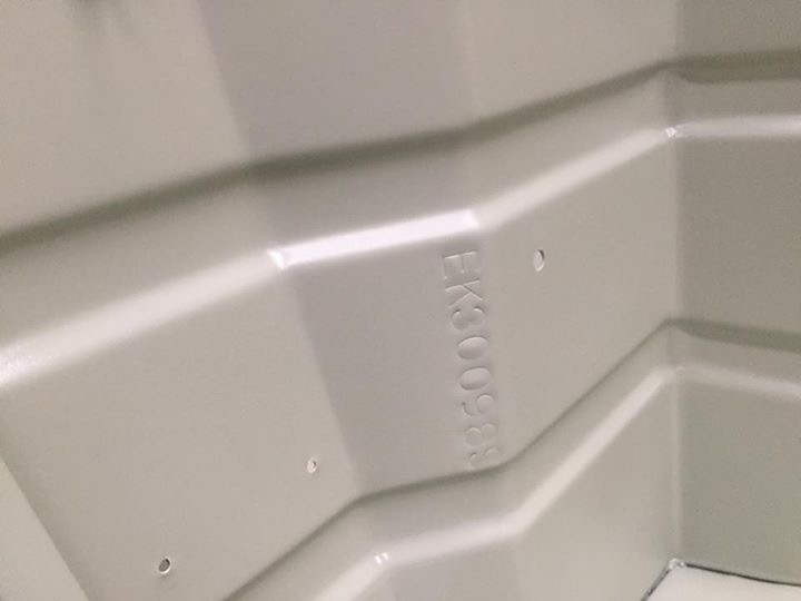

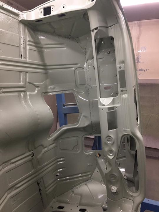

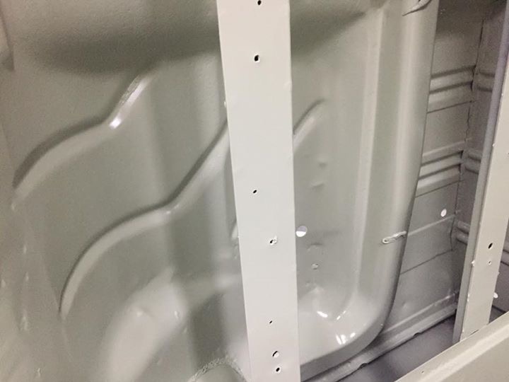

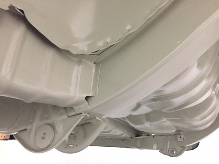

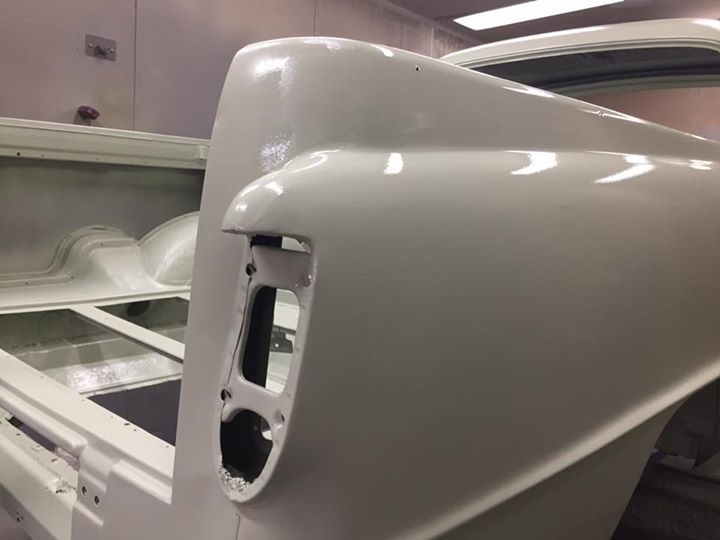

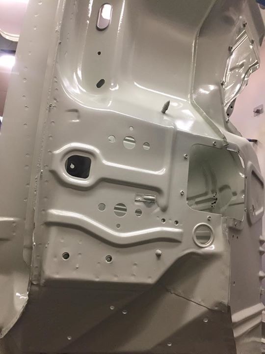

keep at it mate - here are some pics of what it should end up like - I was lucky.

sorry a couple of irrelevant ones there -

Sorry if too many pics BrotherJ - pls delete or mods delete if unwanted - I batch copied and then couldn't delete the relevant ones.

FJWALLY wrote:Sorry if too many pics BrotherJ - pls delete or mods delete if unwanted - I batch copied and then couldn't delete the relevant ones.
Hey Wally!! No problem, I don’t mind at all!
These pics are amazing, I am definitely jealous... and yeah thanks, it’s great to see how it all looked as-new, in a light colour too. This does help me visualise as I cut ‘n’ shut my old bus.
Shame mine will never look like this again!
But hey, I would never have chosen my Ute in the first place - I was given this car to get back on the road, it was quite rough to begin with... but I can still drool at the work you are doing for sure.
Can’t wait to see it finished mate, love that colour ImageImageImage
