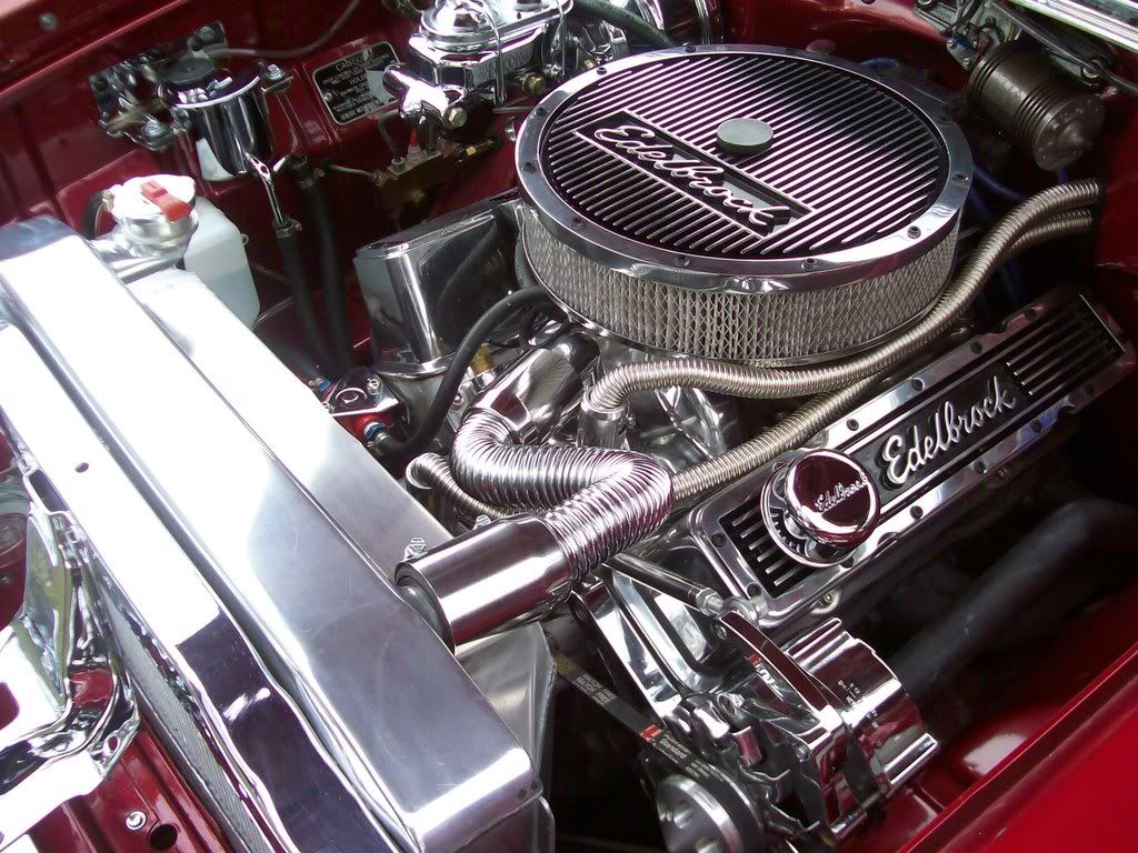

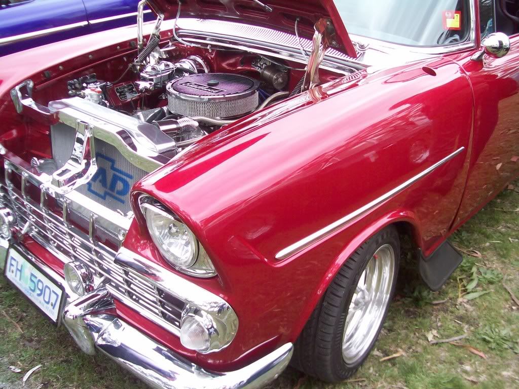

A fella in Launceston just finished a EK Ute with 350 chev with extractors that were similar to block huggers but much better even with good clearance for spark plugs/ leads these were home made and are the way to go. Image

Yeah,
They look like HT/HG pipes or similar design.
I don't mind the look of pipes through the guards hot rod style.
Gary the pipes down the inner guards I assume will be tight. Look foward to seeing those being built.

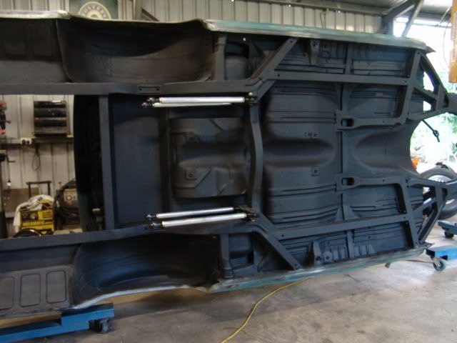

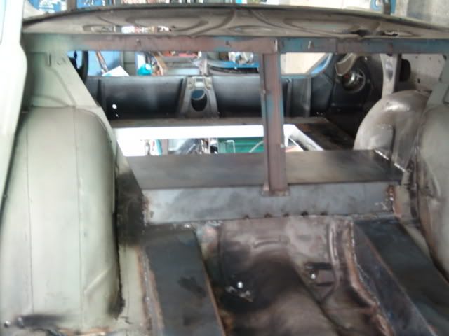

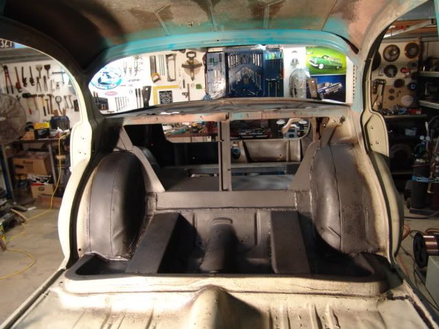

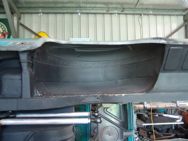

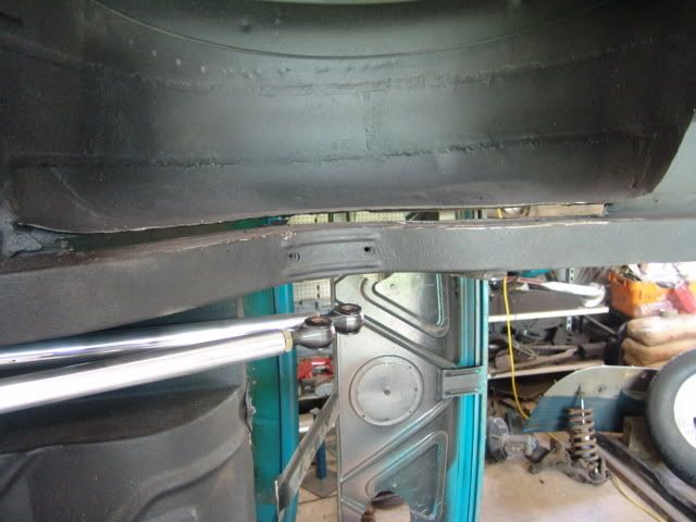

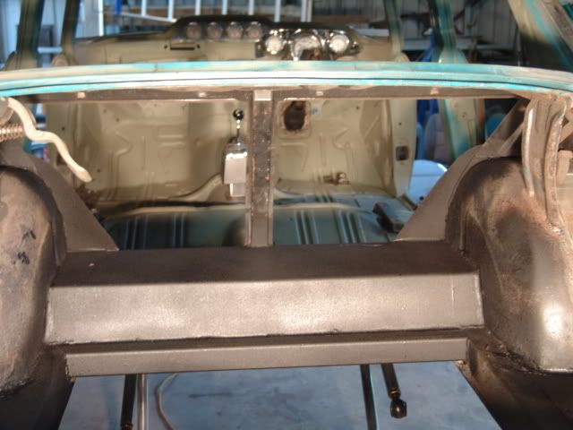

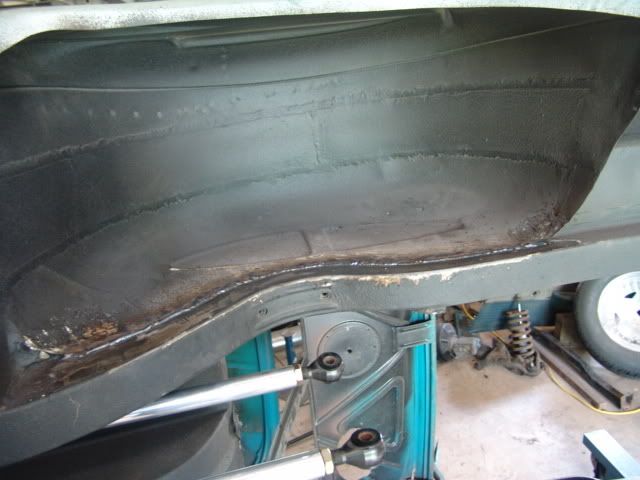

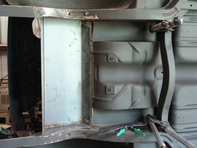

I have done the "mini tub" (remove section between guard and chassis rail to make sure the 295's don't rub). Although the diff fitted into to "original" hump, it would have been squeezy for the other bits running through there and the old shocky mounts needed to go :roll: . Soooo, I cut the whole lot out and made up a new hump out of 1.6mm black steel sheet. I made up some new plates to support the bac of the seat out of 1.6mm also.
Mini tub job - now takes the tubbing to 260mm.

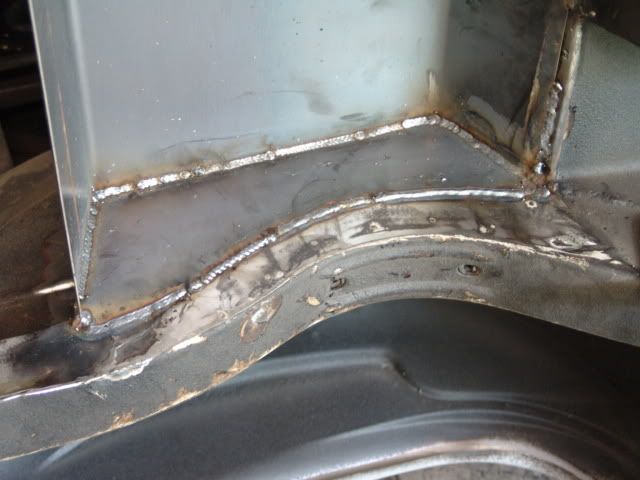

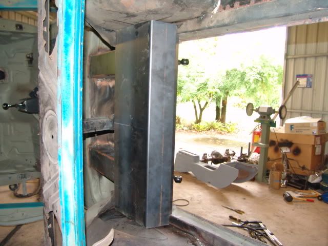

Fabed up this section to give more clearance for exhaust, coilover shocks etc.....
Tacked in:
Finished, the box secion will support the fuel tank and also have the Coilover shock mounts (on the inside of the hump):

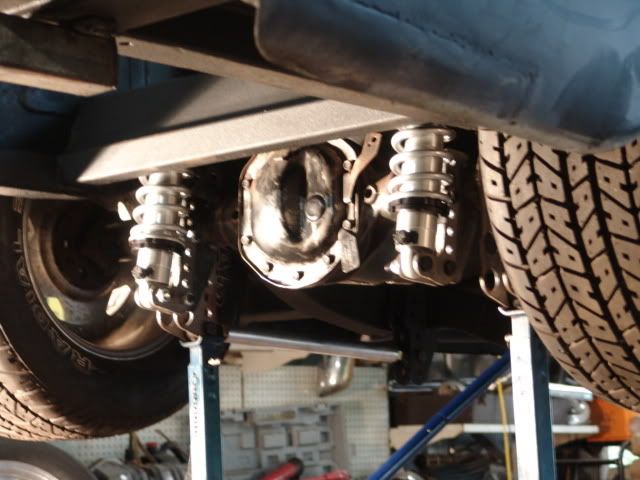

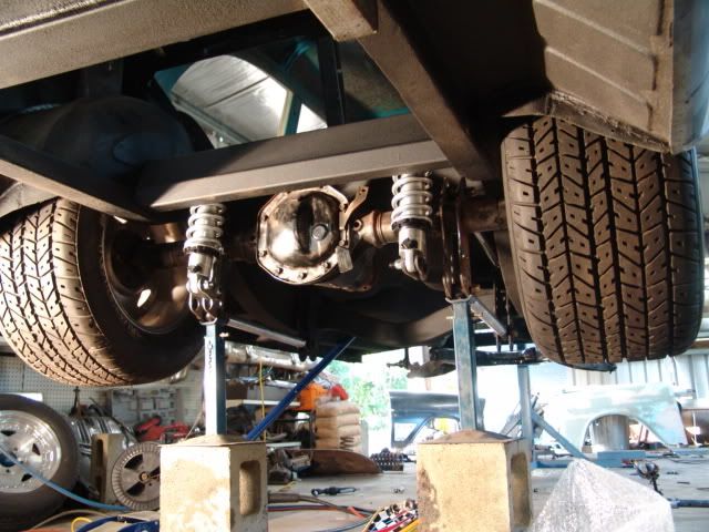

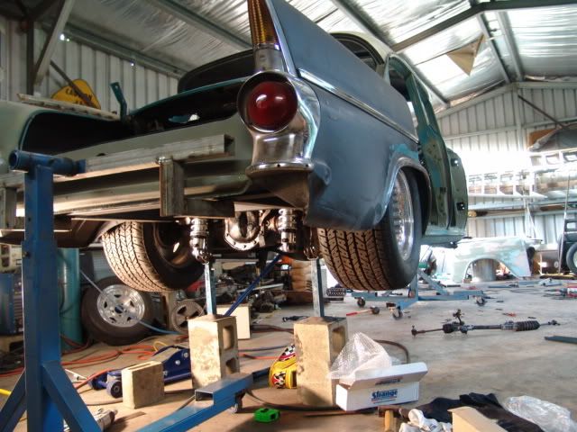

Coilovers turned up and have had their first trial fit :D . They are "Strange" billet alloy shocks with 250 lb "QA1" coils.

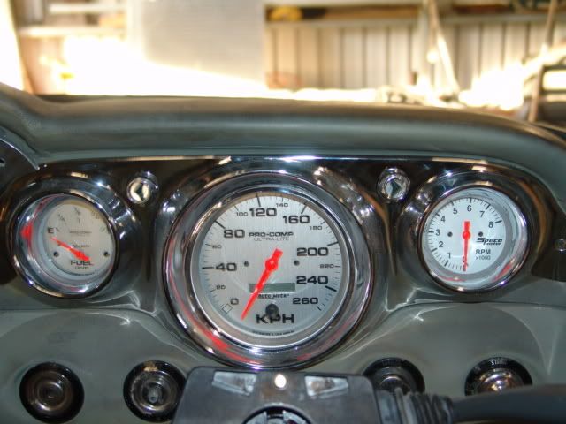

Didn't like the small guages (2 1/16" Autometer) in the cluster so I have upgraded them to 2 5/8", had to use a Speco tacho because Autometer don't do one this size :shock: , fits alot better :D .

very interested to see how you've done the gauges as i want to fill my cluster with something that will work with a commodore wiring harness and sensors .... is the fuel sender the original fb/ek one ... im keen to know if a new gauge will work with an old sender ?

Sammy wrote:very interested to see how you've done the gauges as i want to fill my cluster with something that will work with a commodore wiring harness and sensors .... is the fuel sender the original fb/ek one ... im keen to know if a new gauge will work with an old sender ?
keep up the good work, its starting to really take shape!
Sammy, I am using the wiring harness out of the VN SS including the main fuse panel etc.... stay tuned :D ( this will plug straight into the VN SS commonwhore steering column I have fitted to the EK, which is just a bloody bonus, one less job to do!).
In regards to the fuel gauge, the original sender "old style" will work with a "modern gauge" as long as the sender "ohms" (ohms is resistance) range/readings are what the "gauge" requires, other than the 12 volts this is the only other parameters that the gauge/sender combo requires to work (other than wire :roll: ) :D . I am fitting a new sender that is Empty/ Full, 240 Ohms/ 33 Ohms and the new Autometer gauge to suit this ohm range (many ranges available). From memory the EK standard sender is 0 - 30 ohms (I stand corrected if wrong :oops: ) so you would need to have a gauge that is the same "ohms range" empty to full, or change the sender to suit. The same goes for the temp' gauge etc..... if you buy the gauge to match the "ohms" reading of the sensor then she's thumbs up on the dash!!(gauges and senders are available in many ranges).
