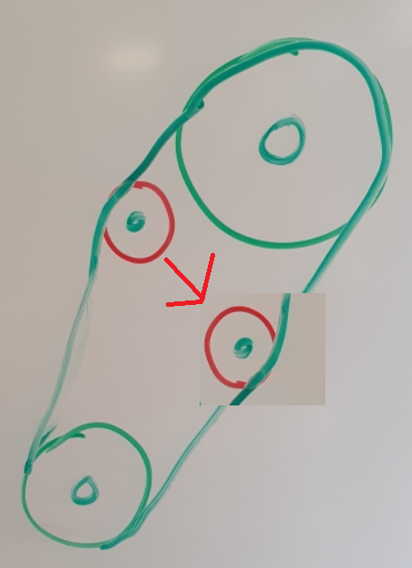

Tensioner will only work when it's on the "slack" side of the drive belt, which I'm guessing, from the direction of crankshaft rotation, will be on the driver's side (belt moving upwards).

ardiesse wrote:Tensioner will only work when it's on the "slack" side of the drive belt, which I'm guessing, from the direction of crankshaft rotation, will be on the driver's side (belt moving upwards).
Yes that would be the top side Rob as crank shaft is the drive and turns clockwise when you look from front of car - is that because of belt slap?
ardiesse
Posts: 1204
Re: WRAY T96 SUPERCHARGER refurb and install
Post by ardiesse »
Yes. That's what I mean. There's much more tension on the left hand side of the belt (otherwise there'd be no power transfer to the blower), and a belt tensioner on this side will have next to no effect because the belt is already under lots of tension. So the tensioner has to go on the "slappy" side.
