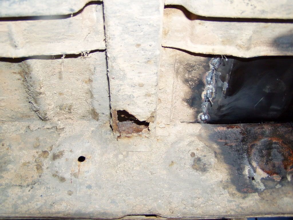

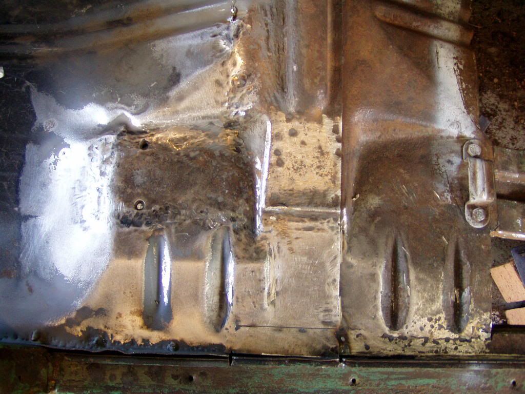

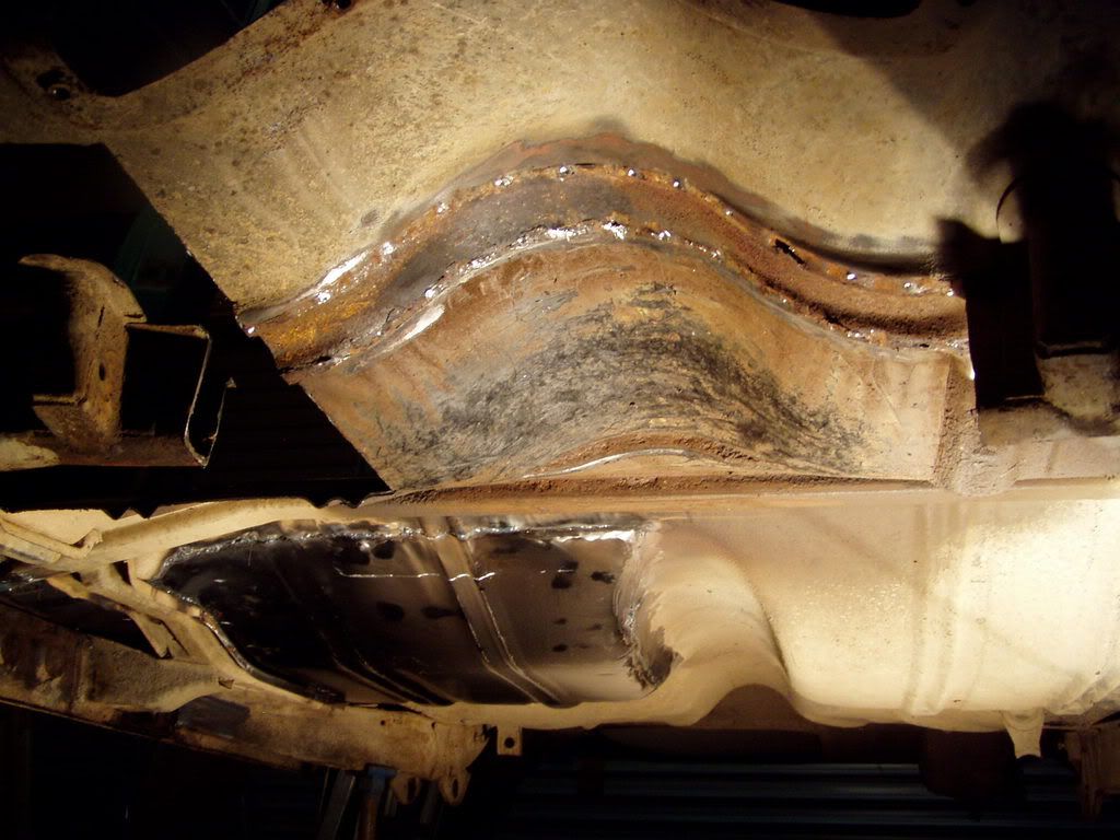

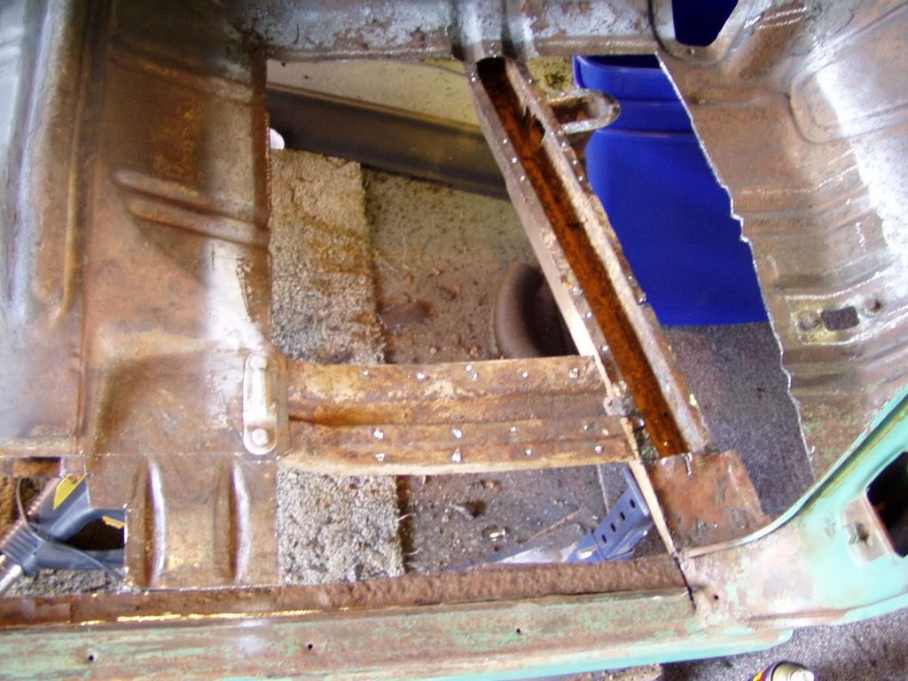

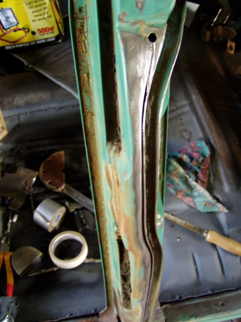

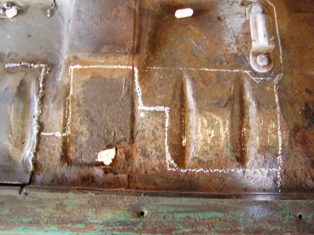

Decided today to attack the floor again.
Found this...
and this.......
New piece of this....
then this bit new.......
all done......

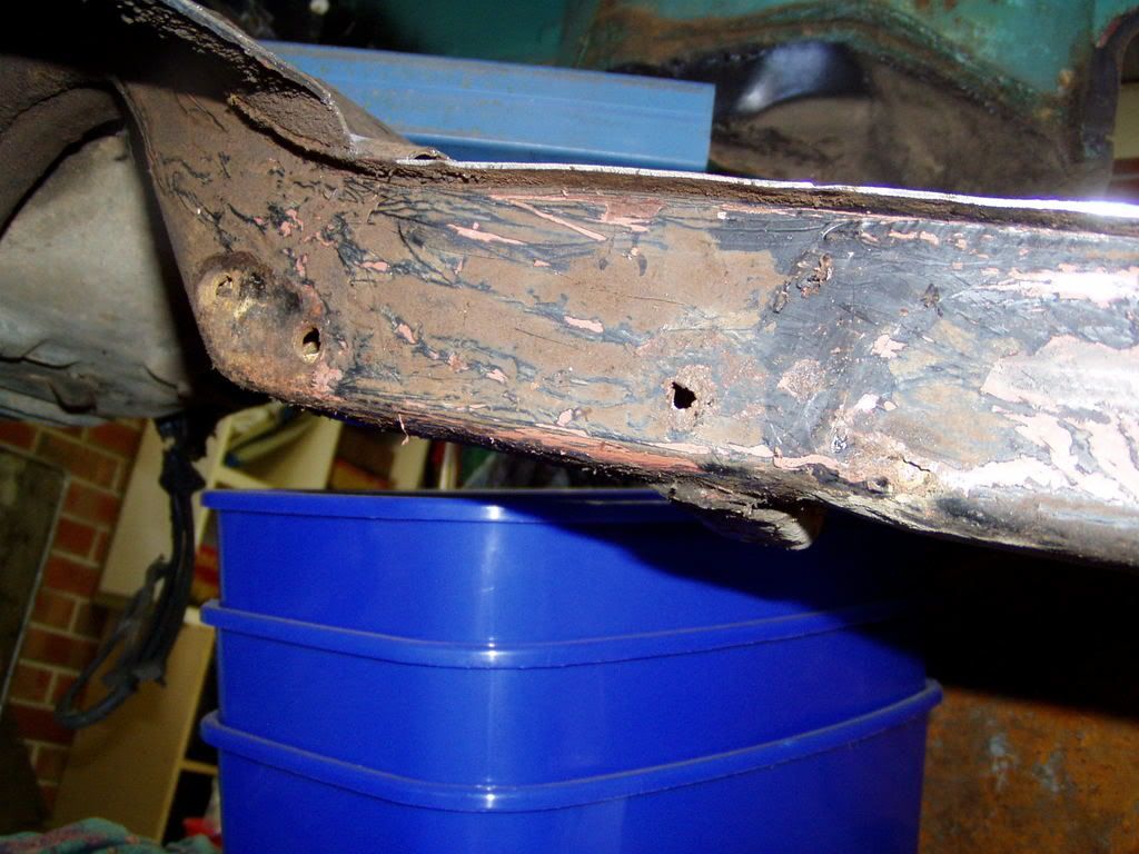

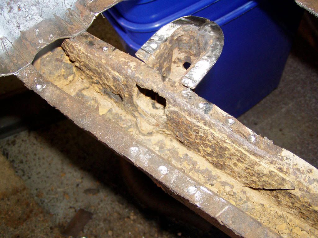

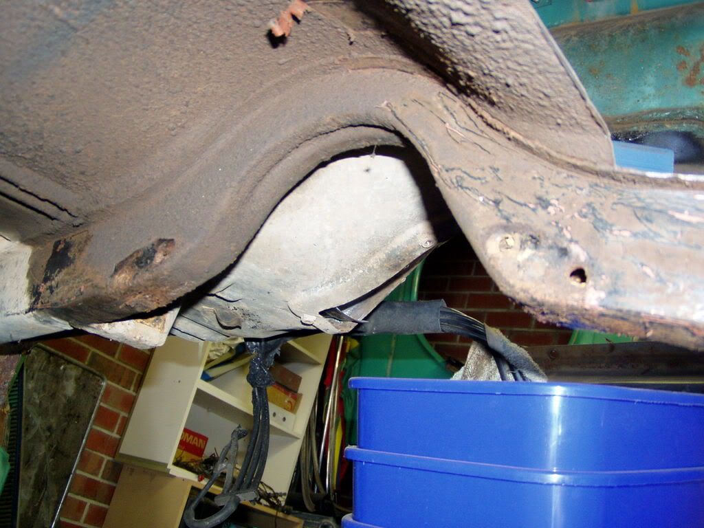

How do I fix the subframe here? I don't think there should be a hole here!
Do I replace it all, and how? Or only pieces?
Shouln't be holes here either.......

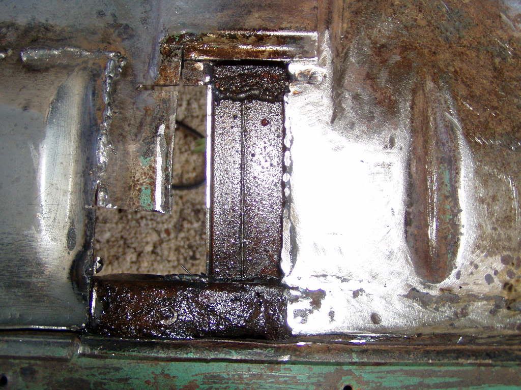

The corners here on the gearbox mounts are all soft from rust!
Has anyone replaced these corners before? How?
Sorry for the novel :shock: , but I'd rather ask and get it right before i go and stuff it up
Thanx heaps :wink:

Just my tired old line here EKSPCL - you can weld a lot better than I - I haven't had to weld trans mounts - I fabricated an "arch" and welded that into where the removed tunnel support was cut from.

Go to www.fefcholden.org.au/forum and click on restoration help section and look under post called crossmember fabrication.
Some photos there on how to fabricate a new trans hump floor brace might be of help.
Terry.

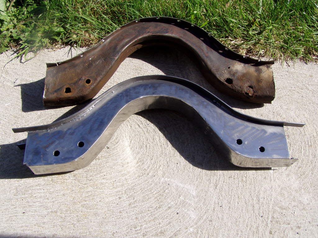

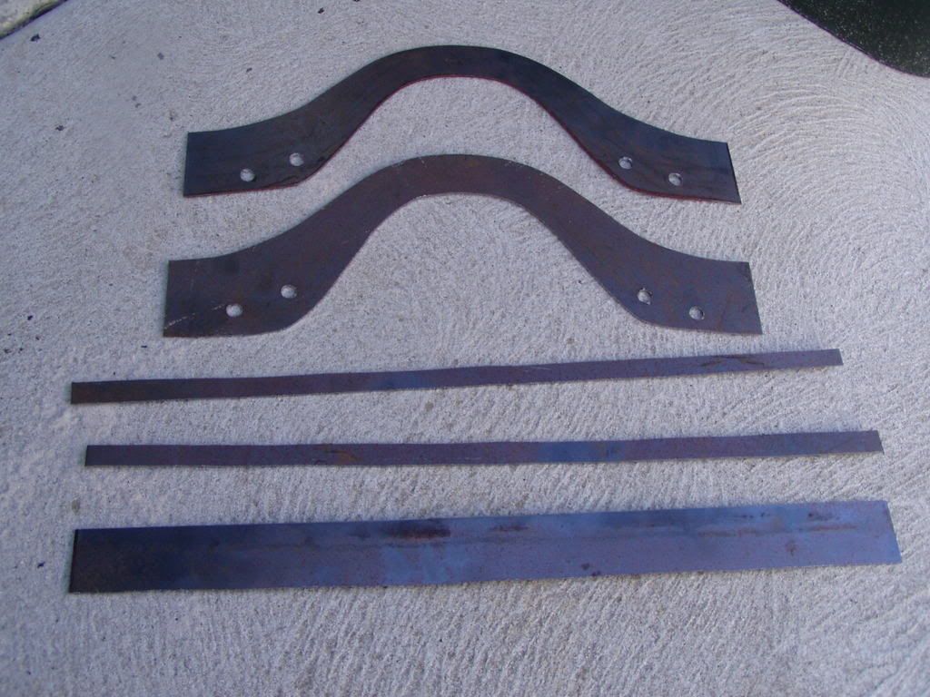

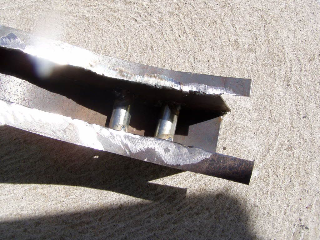

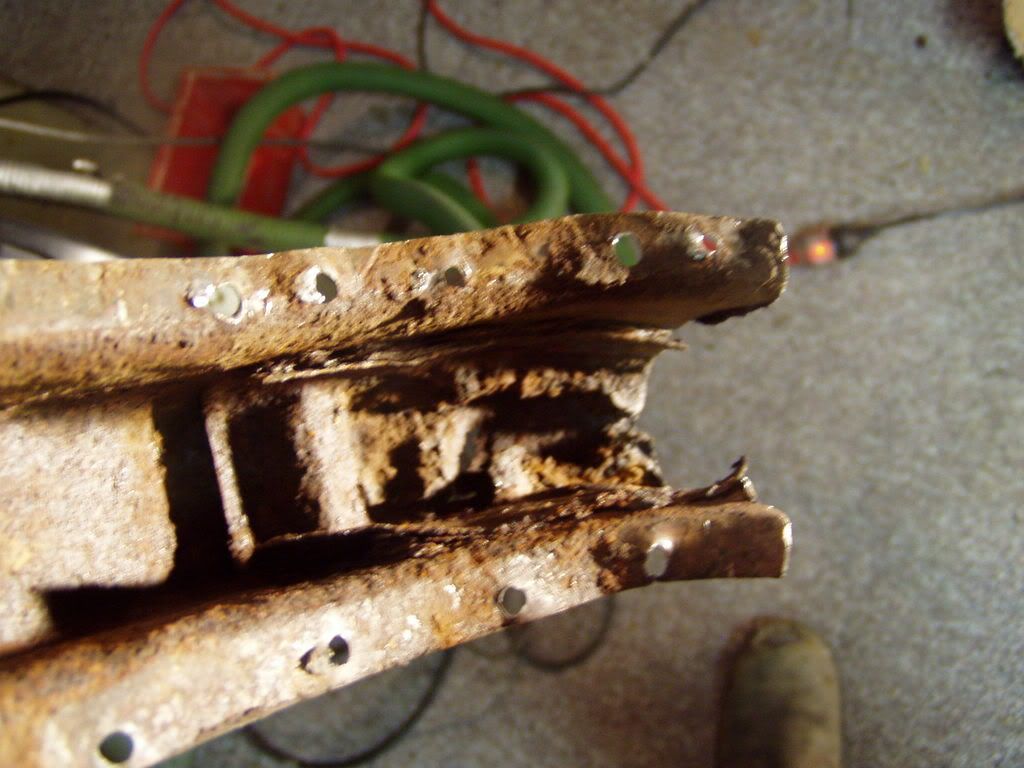

I've now done the Crossmember Fab.
Here's a few pics...

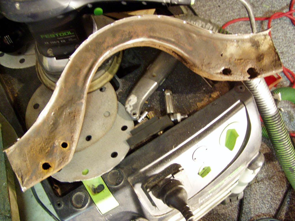

Drilled out the spot welds and cut out the old one...

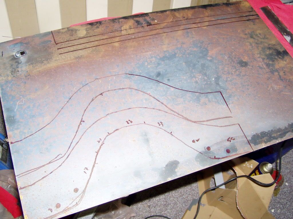

Marked out onto sheet metal....
Cut out with a jig saw....
Welded on 15mm attatching strips....

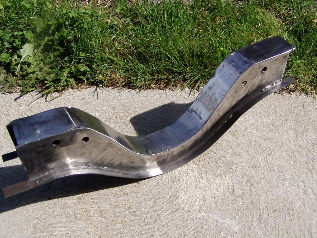

Welded together with another 40mm strip and some crush tubes....
A bit of grinding etc.....Hey Presto!
Old and New....
Happy with this mornings efforts. Just now have to get the rest of the crossmember folded up and then I'll put it all back together.
A bit o' lunch now and out to play once again :D

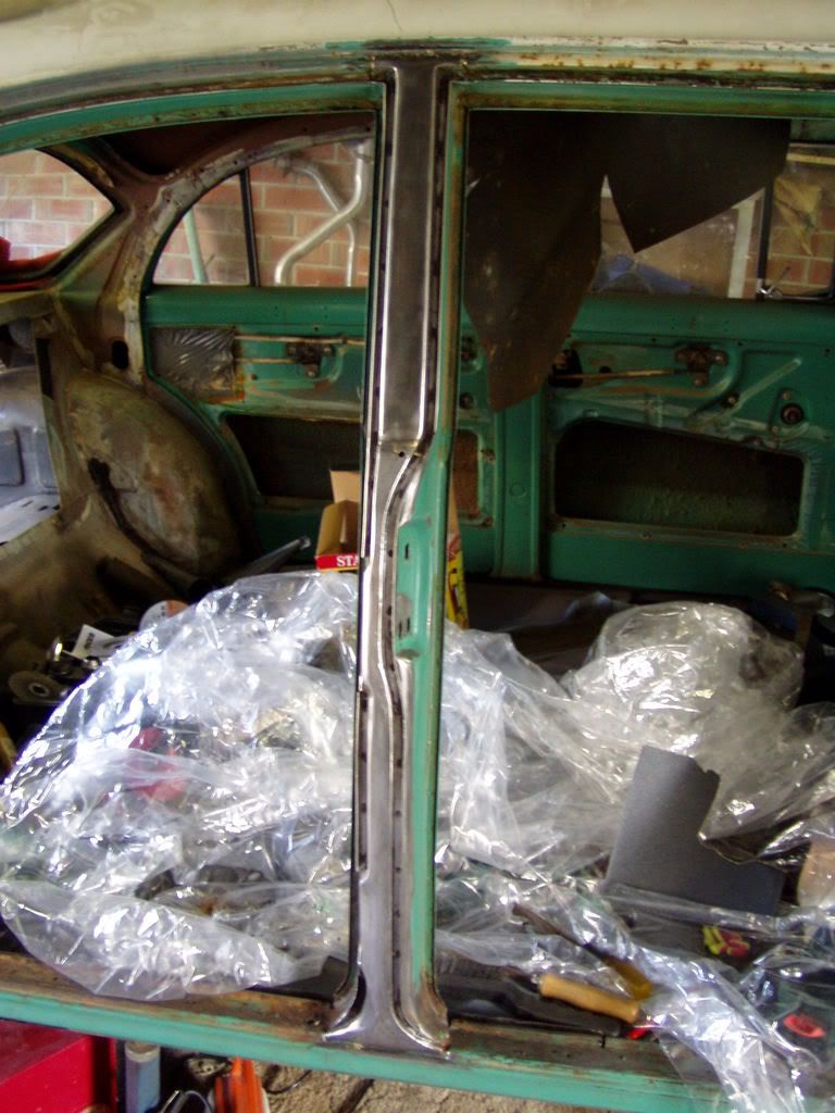

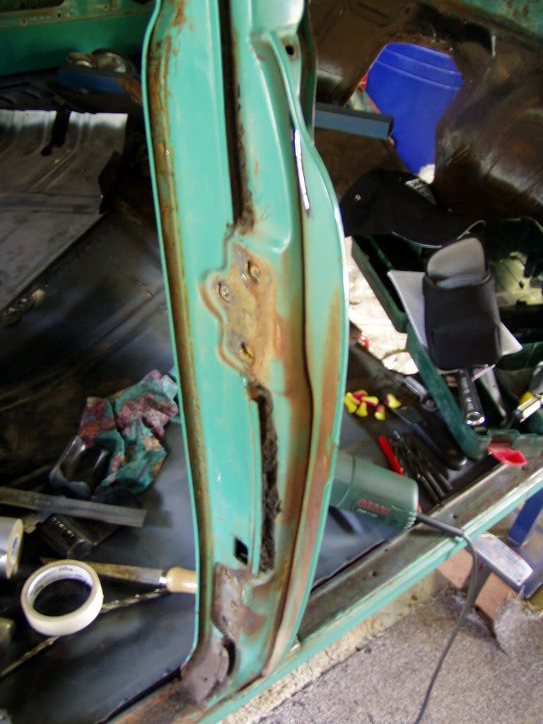

More from today :shock:
Thanks to Malcom's yellow machine, looks very neat, I've decided to take off the dividers between the doors this arvo....
Before, During and After.......
I'll get to extending the front doors another day. Thats me done for this weekend :wink:

Mate, very nice work :wink: Thats exactly how I did my crossmember.

Awesome!!! great how to for replacing a crossmember.
Posts: 2693
NIce work,
That part of the car always cops the rust for some reason!
Dont mean to be picky but its called a floor brace.
The section that holds most gearboxes is the crossmember. :wink: :wink:

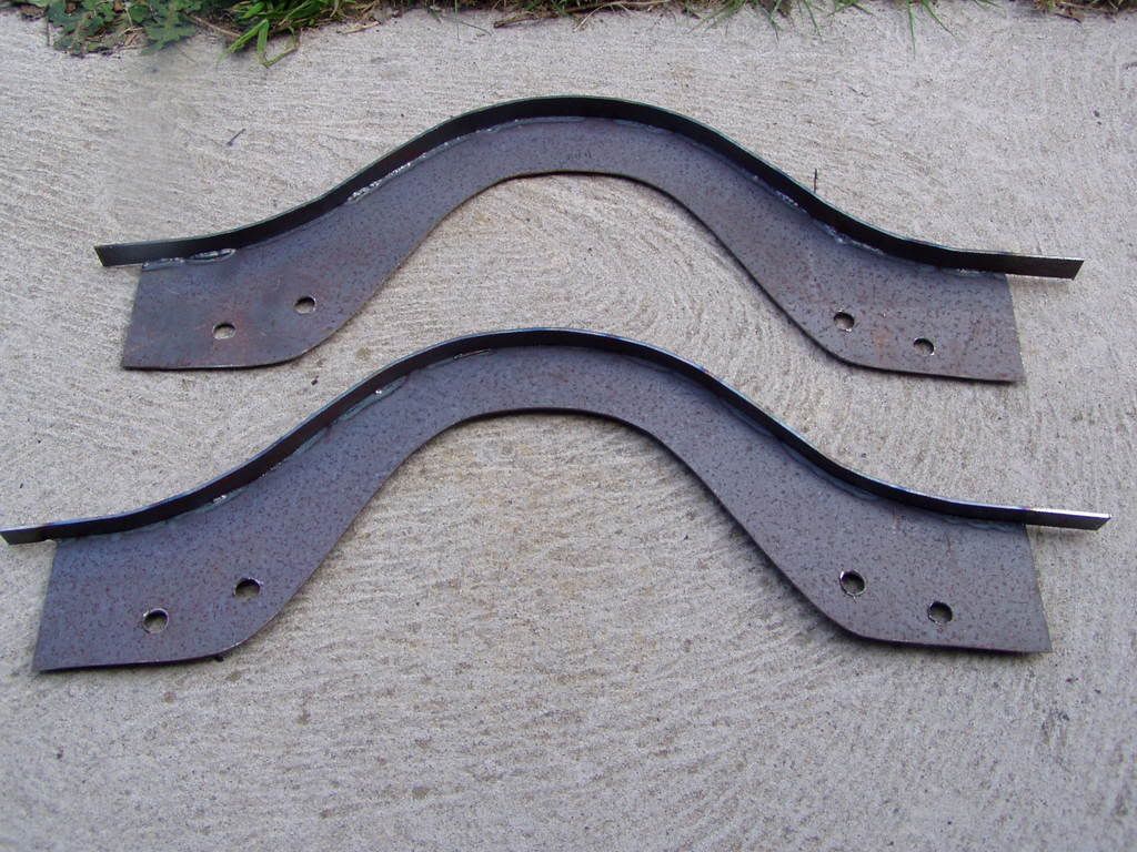

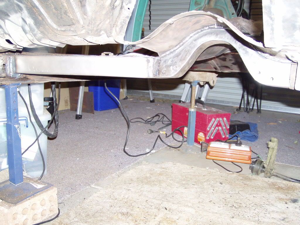

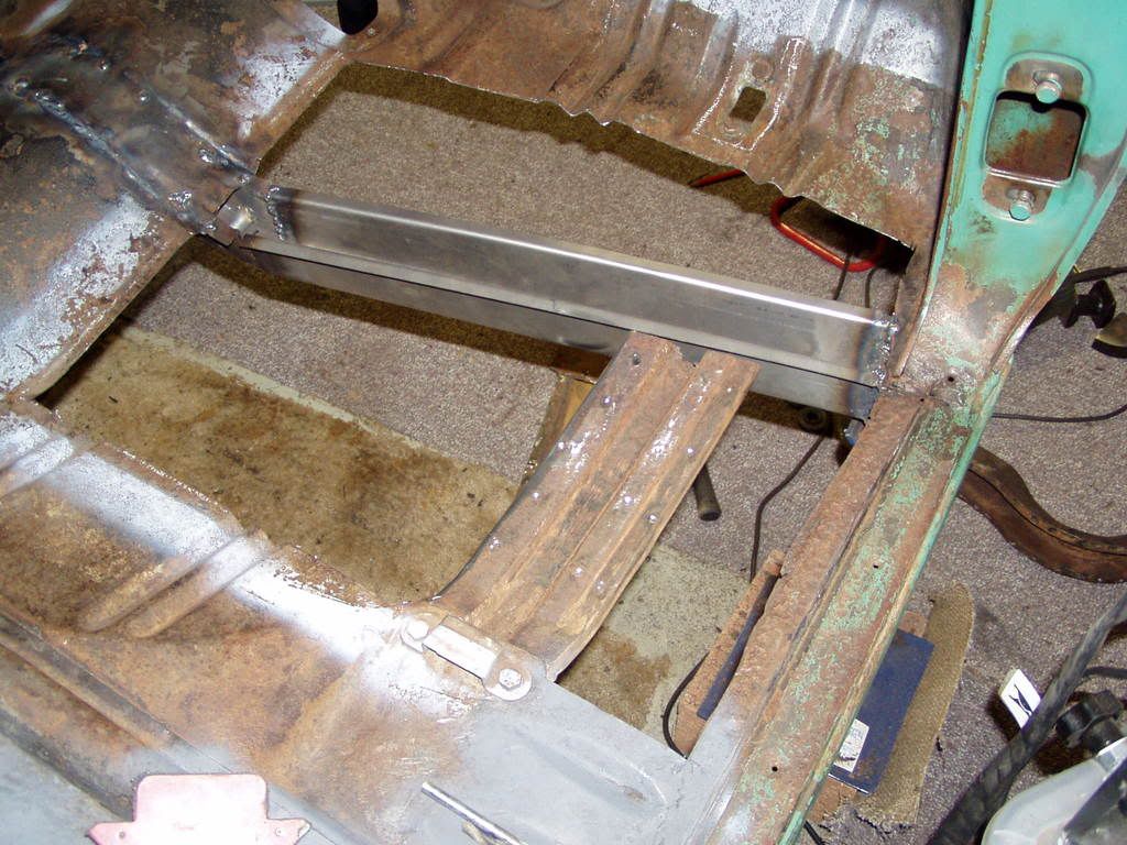

Today I got hold of some sheet steel and went over to my mates place,
he has a 'folder', and folded myself up a couple of new crossmember sections :D
Here's the drivers side in.......
Along with the new arch I made previously in this post.......
Now to work out how to get the mounting point on for the front end to bolt to :shock:
Then I think the drivers floor will come next, and all over again on the passengers side.
