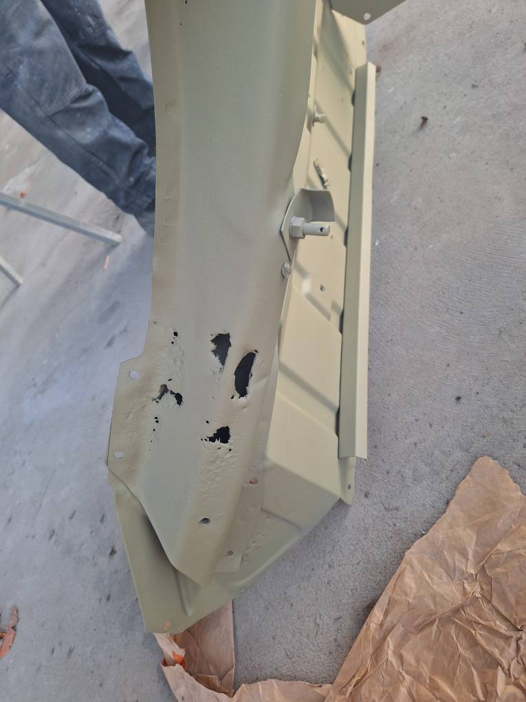

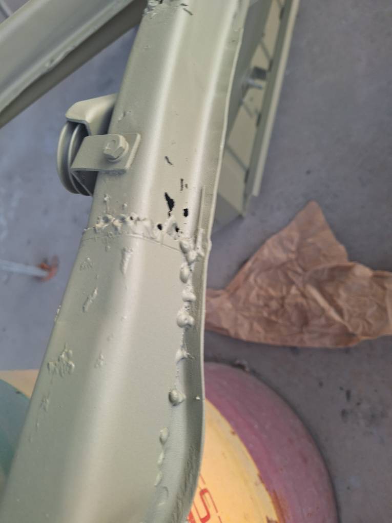

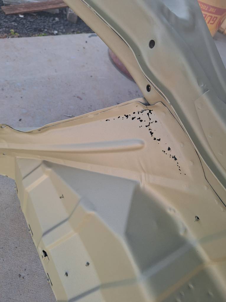

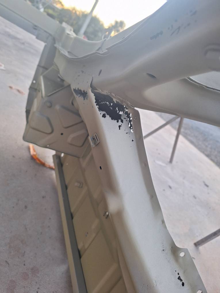

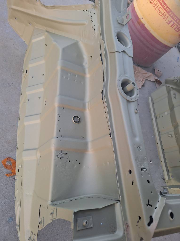

Evening gents , was a bit late to get decent pictures but heading back out to catch up with the panel beater on the weekend to put a proper plan in place .
Sent from my SM-A546E using Tapatalk
Posts: 2542
Re: Family Affair Ek Ute
At the risk of being a smartarse, what you are showing there is pretty standard subframe rust. Legs and the angled bits are all available from Rares ( I might even have the short angled radiator support pieces as well for postage cost) and easily replaced. The panels look pretty good and easy repairs there too. Probably about $400 worth of bits and about 30hours of fab work- maybe less. Easy to see the money being spent if you are paying others to do it.

Brett027 wrote:At the risk of being a smartarse, what you are showing there is pretty standard subframe rust. Legs and the angled bits are all available from Rares ( I might even have the short angled radiator support pieces as well for postage cost) and easily replaced. The panels look pretty good and easy repairs there too. Probably about $400 worth of bits and about 30hours of fab work- maybe less. Easy to see the money being spent if you are paying others to do it.
Seeing the fairly ordinary repair on the leg reminds me of Wilma. Image
Hi mate , not a smart ass at all. appreciate the input . The ute isn't mine any more it's my younger brothers if it was still mine I'd be chipping away repairing if I had the time . I don't have the time neither does he but he's happy to pay . Bit of a win win I get to build the the family ute into something great with him and he foots the bills hahaha . Would be definitely interested in any parts you would be willing to part with

And I'll second what Brett said. You'll get 3/4 of the way there with subframe legs, tie member and "dumb-irons" (the short sections with the stabiliser bar mounts). The rusted-out bits at the "triple-junction" where the idler arm bolts on are fairly easy to fabricate from sheet metal. As are the upper parts where the subframe skirt attaches to the body.
The Rares inner LH subframe leg section won't quite be long enough to fix the rot in the inner LH leg, where the old grey motor engine mount brackets go, so you'll need to make a short repair out of sheet. There's a pair of crush-tubes and a strengthening piece in there; but if you are not going back to a grey motor, the repair will be easier.
Take a look at https://forum.fefcholden.club/index.php?topic=27433.200 (and a few pages onwards)- it shows the repairs I did to my current project's subframe.
I reckon if your panelbeater can repair the subframe for $3k, it's money well spent.
