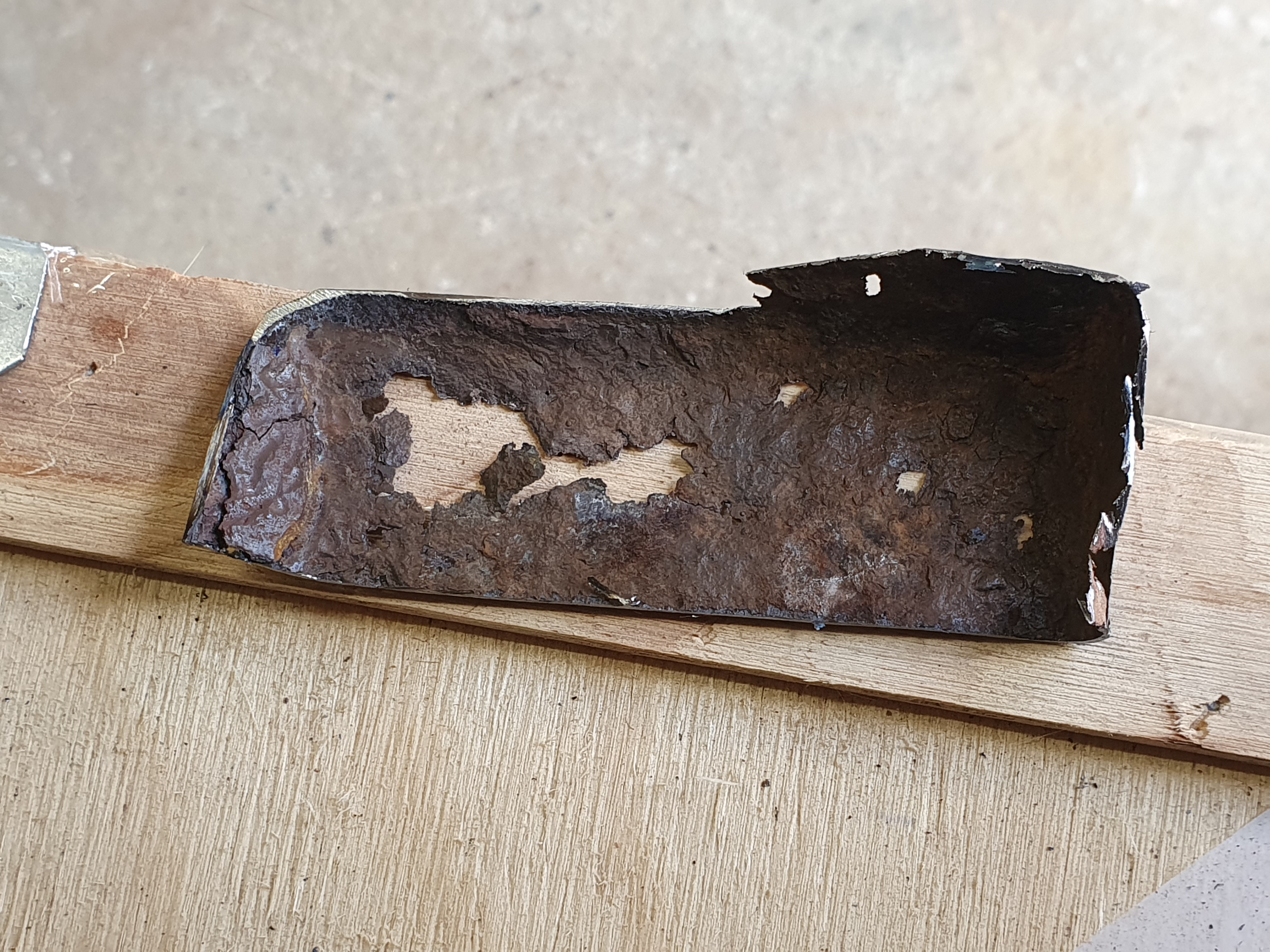

Long weekend fiddly job. Everyday is the same though.Image
There are so many overlapping sheets inside this structure, with none of them rust treated. No wonder there is rust everywhere I look. And this was the one that looked pretty good.
Ute owners beware- there will be bad things happening and dirt filling every overlapped joint. Flooding with fish oil/ cavity wax required for this space.ImageImage

That's another day gone grinding and welding. Easier side tomorrow. Image
Replaced piece
Replaced piece

Hi Rob, I would have thought that your FC 'Found Object' would be enough to keep you from looking for even more trouble. The tailgate section reminds me of the rusty stuff jammed into sedan doglegs. As always with these things, what you see is nothing like what you've really got😁
