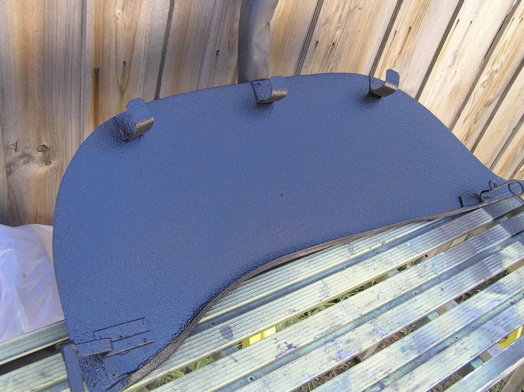

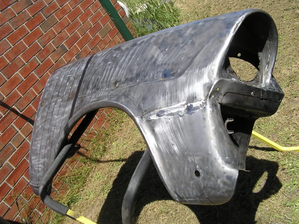

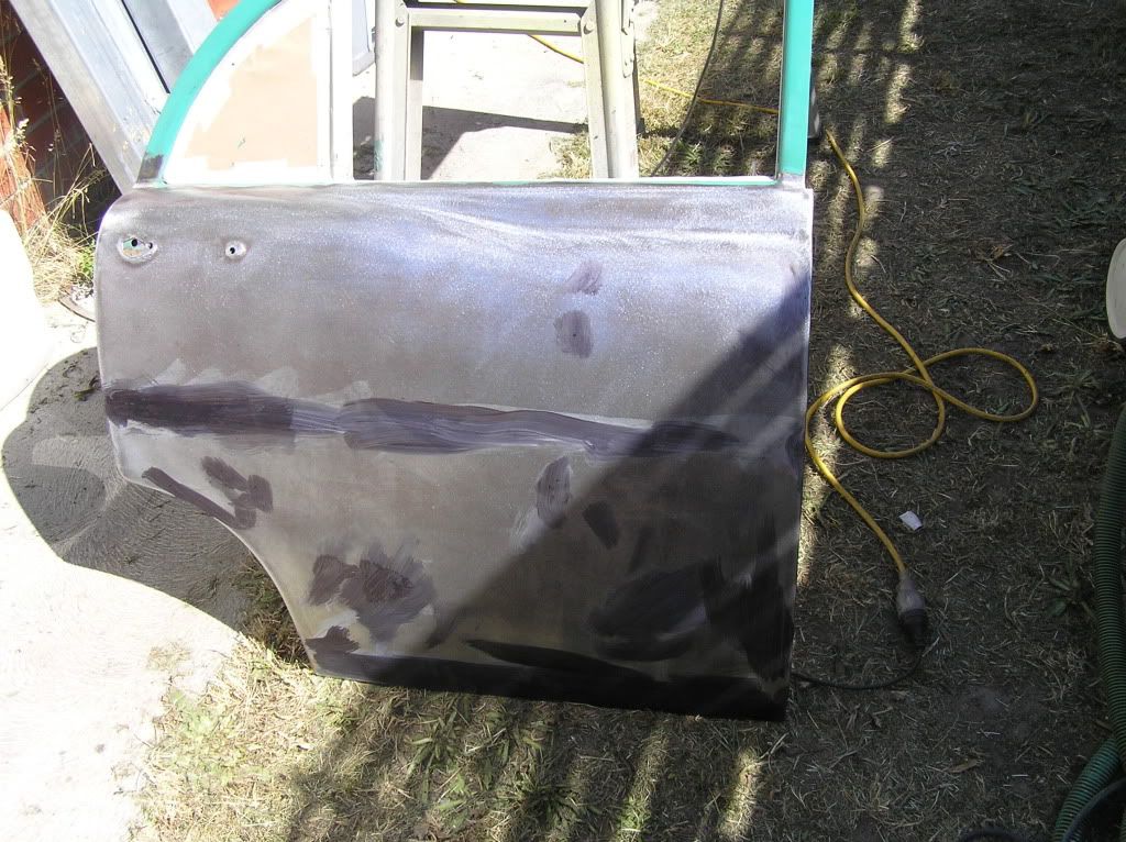

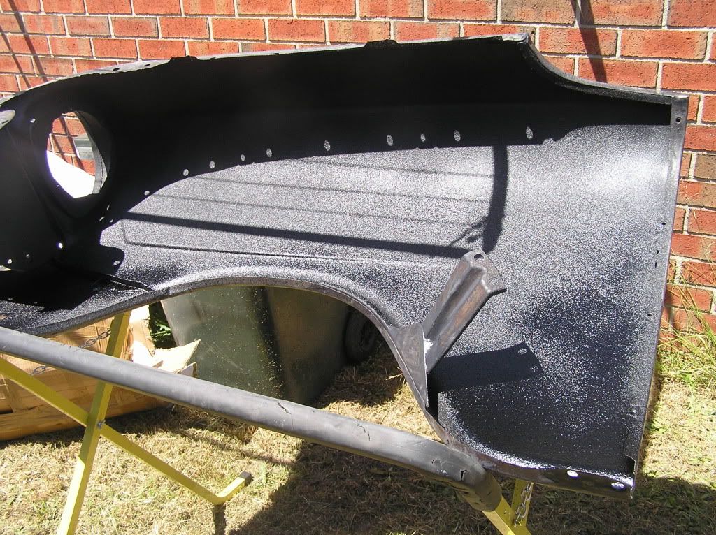

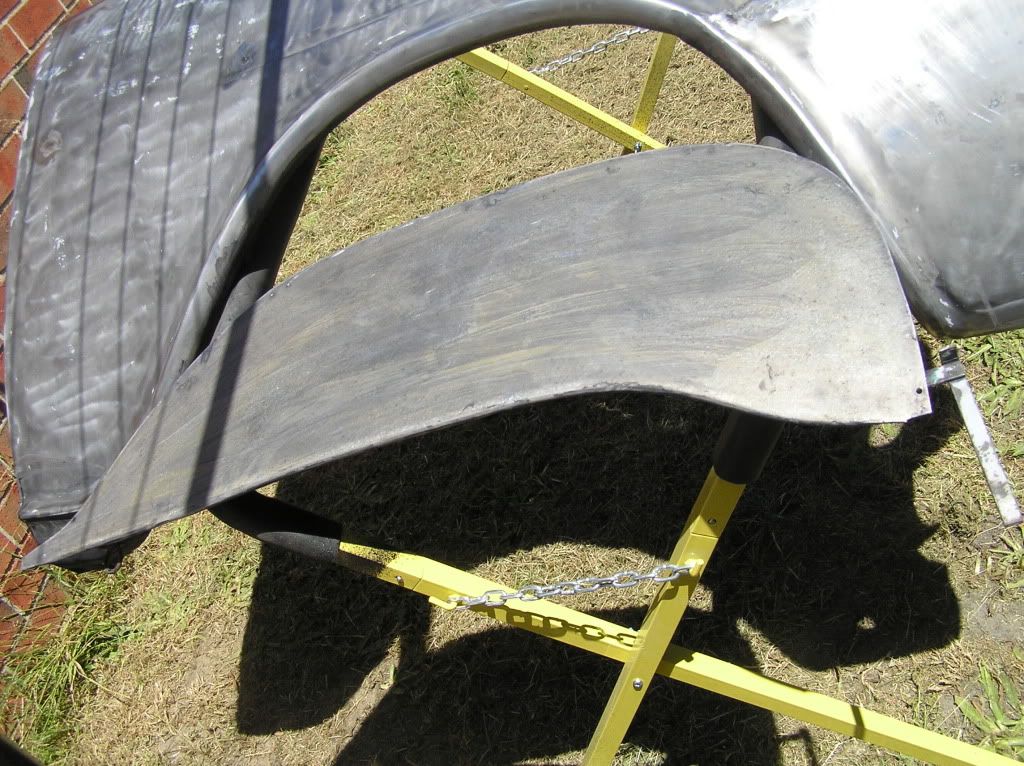

Stripped to metal all the driver's side panels today....
Body deadener under the guard and spat.....

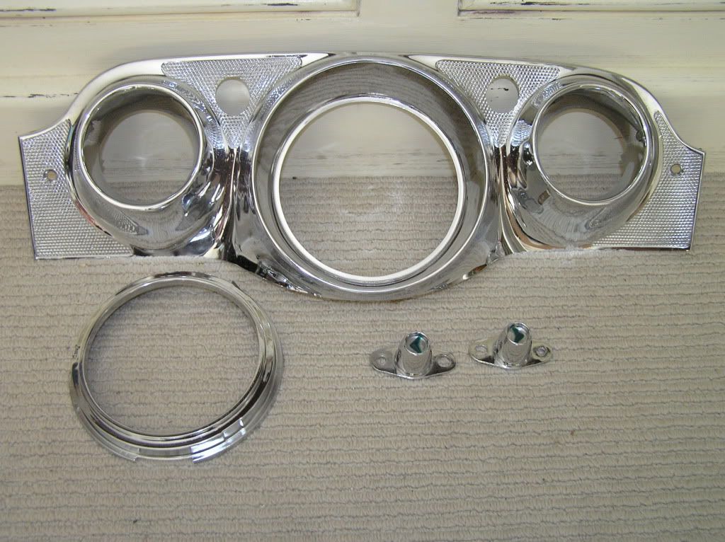

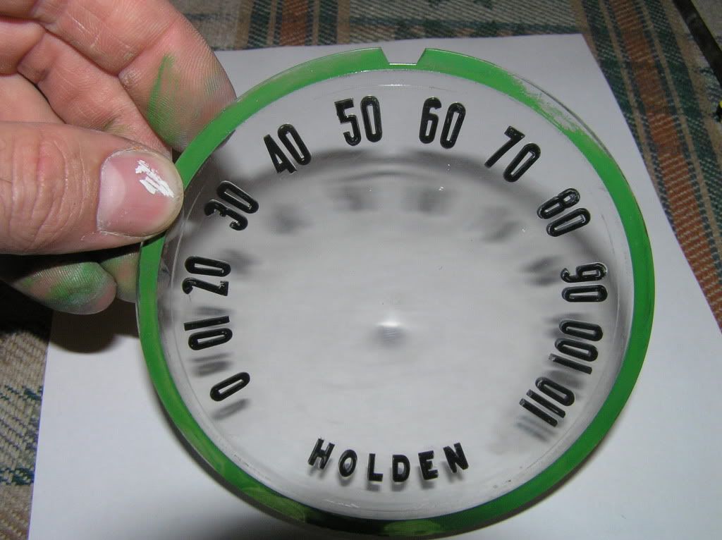

Started pulling apart the instrument panel last night so I can paint the background to suit the color of the car.
Re-painted the lettering black because the background will be either yellow or white (haven't decided yet) :?
Amazing how a bit of 'Colgate Total' can shine up the chrome work :shock:

EKSPCL wrote: Amazing how a bit of 'Colgate Total' can shine up the chrome work :shock:
how the f#%k did you figure that out :shock: :?
my70wg
Posts: 982
Location: dapto
Post by my70wg »
from drooling his fresly brushed teeth on dirty chrome... :lol: :lol: :lol:
aidan...
i'll get there....
Dakam
Posts: 1011
Post by Dakam »
At least your dash wont get plaque build up. :lol:
Dave.
EKSPCL
Posts: 794
Post by EKSPCL »
I've known that for a long time!
I think my old man told me when I had my first car.
He said it was good for getting rid of the hard to remove bugs and tar on the front bumper too.
It's a bit gritty like a cutting compound for your teeth :lol:

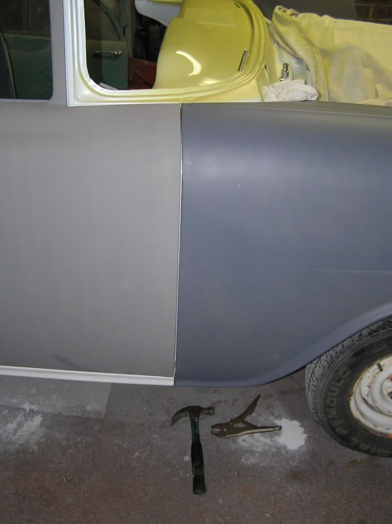

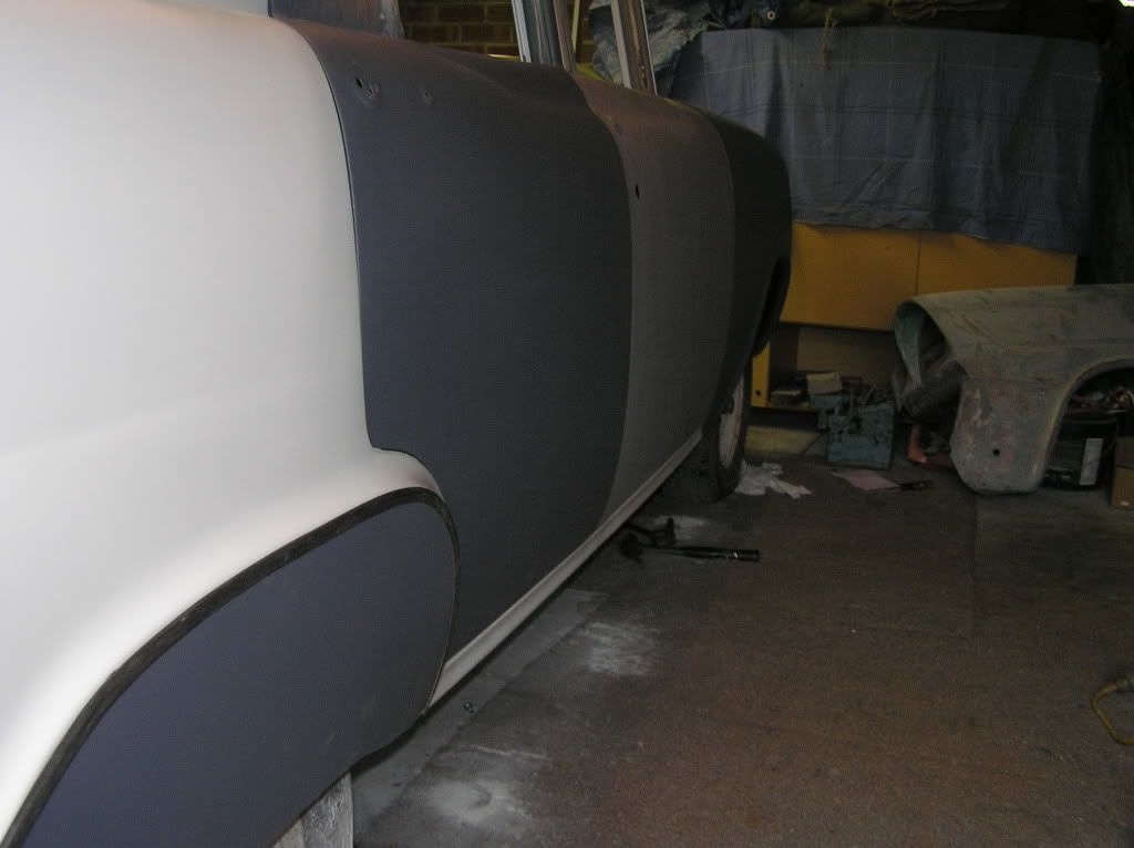

When you decide to take the peice of metal out from between the doors, expect a hell of a time trying to line up the doors :shock:
After a couple of shims and a few french words, the panels finally lined up :wink: ...........

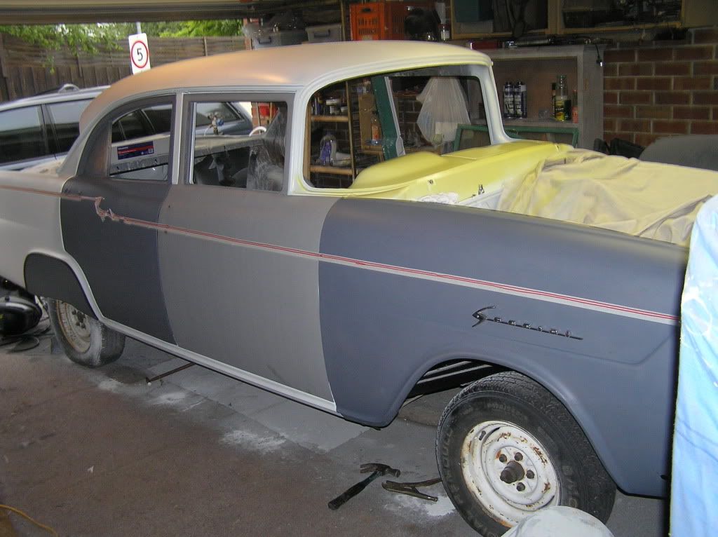

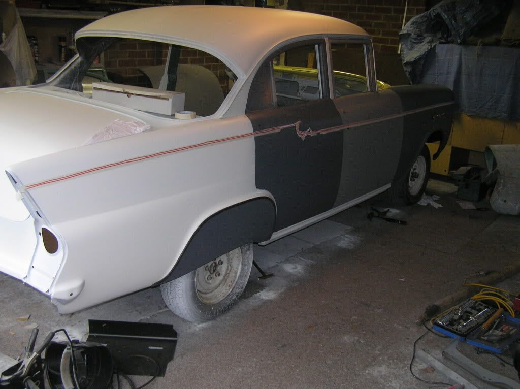

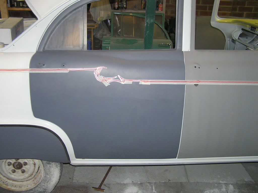

I had to see if my pinstripe would look any good.
So I used some masking tape and a texta...........
Very rough, but gives me an idea.
I think it should look OK.
The top will be the yellow and the bottom the white.
I'm thinking a tan color for the pinstripe.
Any thoughts :?: :?:

looks cool as 8)
got to love the yellow
cheers dave 8)

My opinion with the pin stripe would be to go a much darker colour than Tan, EKSPCL.. the reason being that you'll loose the line over the yellow it being only 2-3mm thick. For it to be seen you'd probably have to go a darker colour like dark Brown or Red. Even a clashing colour can work if the line itself is thin enough so don't be affraid to experiment with colours like blue, purple or even hot pink.:shock:
By the way I love the scroll work you've got on the line step..very flash! 8)
Scotty.

something to think about with the colours that sounds a very similar colour scheme to that 2 door sedan from WA, unless that was the plan :oops:
EKSPCL
Posts: 794
Post by EKSPCL »
Thanks Scotty, I will keep that in mind :idea:
Ratbox, I do know the one you are talking about.
I found a pic of it just after i decided on the colors, it has helped with the height of the pinstripe.
