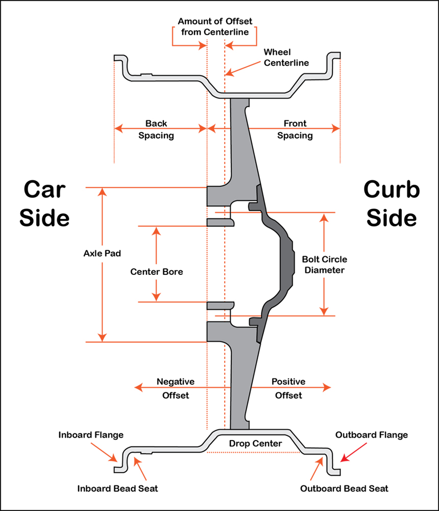

Posts: 5740
G'day Clay,
While you've got the rims out and clean, can you take a few measurements please? Perhaps back space and front space, axle pad and centre bore.
Wheel measurements.jpg (260.72 KiB) Viewed 611 times
I'd like to start a thread on how to identify the various old Holden wheels, and give some decent measurements. Some guys have the ability to look at a wheel and know it is Torana etc, and it would be great to capture that somewhere. Good place to store the discussion on the HD/HR disc brake rims too.
Being HR, they should be 4.25" bolt circle diameter and 45º wheel nut tapers. i thought HR rims had 6mm positive offset, but I could be wrong.
Posts: 2535
Great idea Harv. I would value that info highly.
