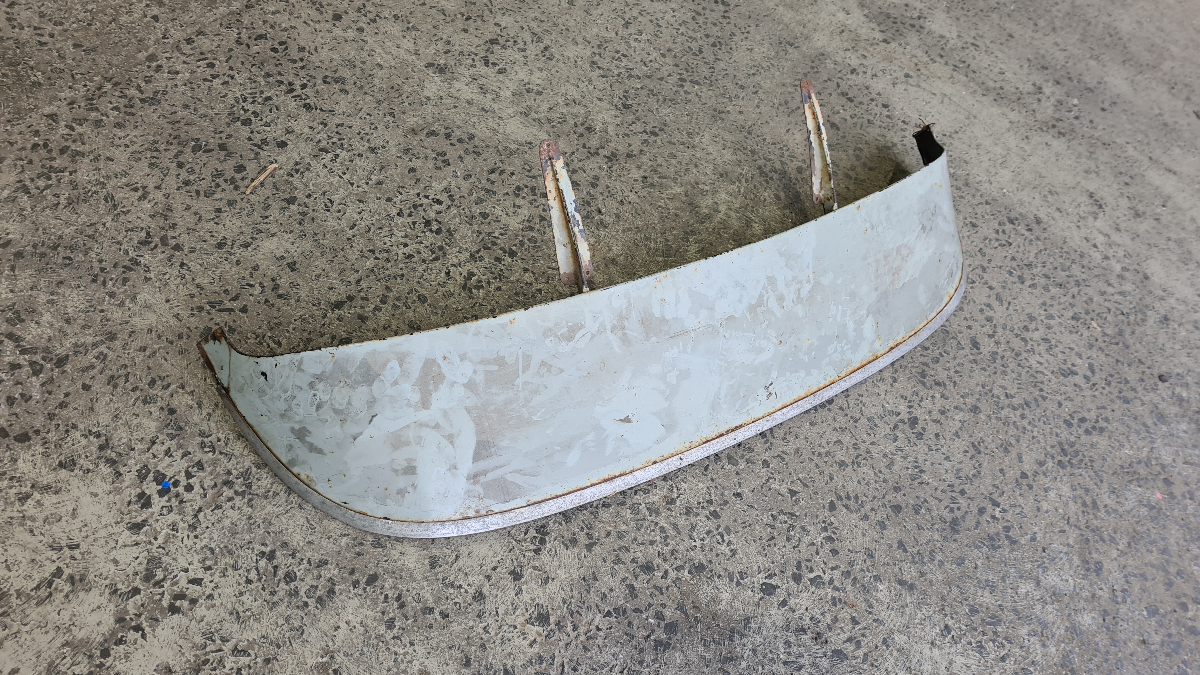

I always thought that the sun visor that came loose with my donor ute was actually off the ute as it is the same colour and the roof has the holes drilled in it. Turns out the brackets are a different profile and don't fit. Tried them on sedan roof and they fit perfectly.
So, anyone out there want to swap ute brackets for sedan brackets ? Also need the drivers side s/steel corner trim which is missing.

Also,
Is there a way of removing the aluminium trim without destroying it ? I want to take it off so it can be polished and to paint the visor.

gpi
Posts: 1131
Re: Micks chopped & tubbed ute
Post by gpi »
this bloke got his off but had trouble putting it back on
viewtopic.php?t=14680
Wrongway Roger
Posts: 756
Post by Wrongway Roger »
Beware of what is under the trim. A little surface rust is the edge the more underneath.
This is my visor that will go back on Ammo's ute.
Visor 1.JPG (39.55 KiB) Viewed 5486 times
Visor 2.JPG (36.06 KiB) Viewed 5486 times
Visor 3.JPG (44.65 KiB) Viewed 5486 times
What looked to be fairly single repair to start with so I have patched on the inside but have yet to decide what to do on the edge.
I hand rubbed the trim to remove the corrosion with a view to anodise it but still in a raw state at the moment.
