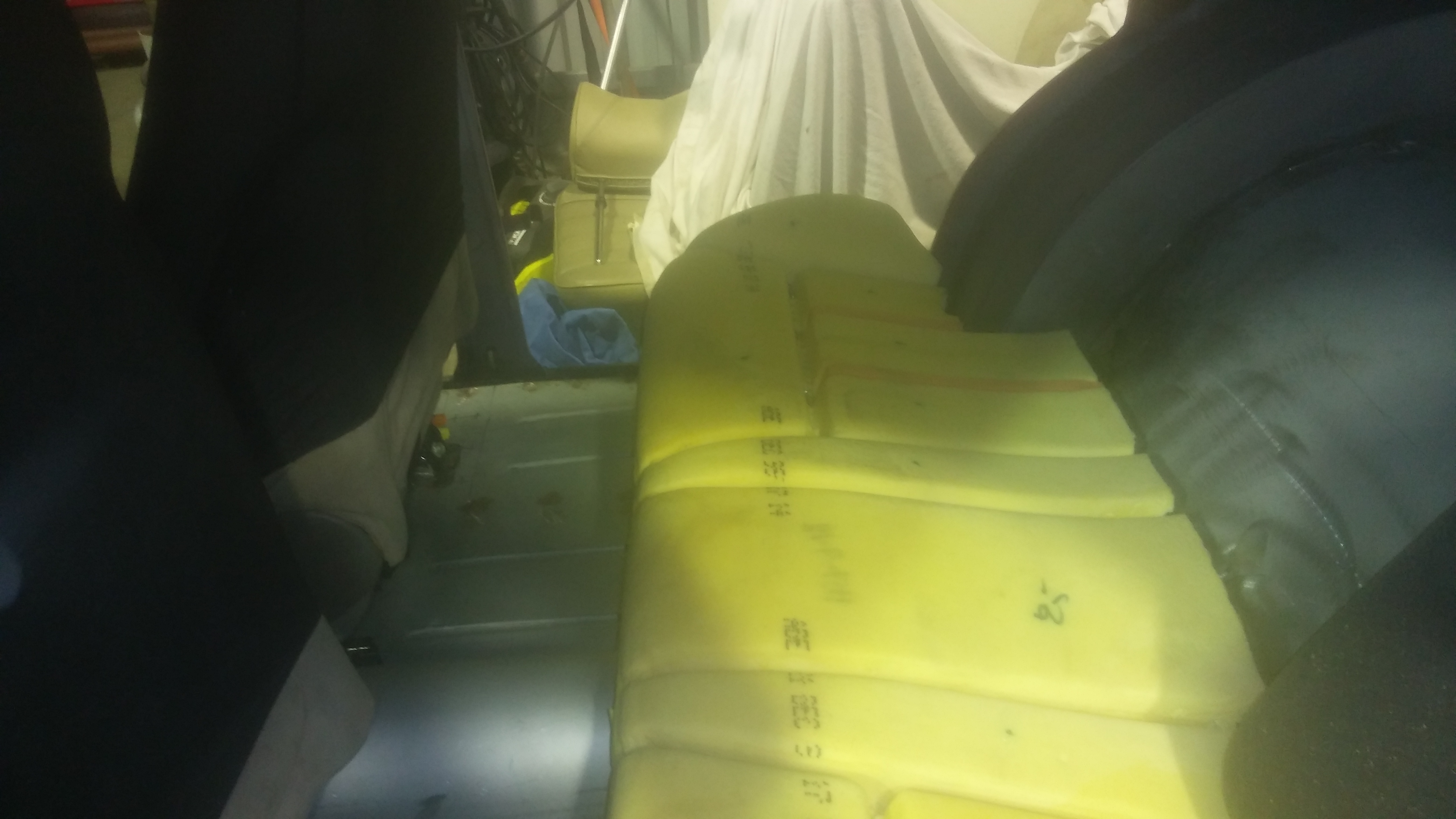

Been playing around with the rear seat. Am not sure i will get three bums on it due to the tubs. Will mount the front seats and then see if i can sneak the rear seat forward a bit more.

So i have now mounted the front seats and it looks like i can bring the rear seat forward about 75mm so it may be okay. I wont be sitting in the back so if its a bit hard on the backside it wont matter 😀😀

So more progress made. Front seat mounts fully welded in. Rear upper seat mounted including seat belts. I need to reinstall the hood lining to check head clearance before mounting the bottom section of the seat.ImageImageImage

Nice job Taz,

EK283 wrote:Nice job Taz,
What are the rear seats from?
I have a WH statesman which i am using for parts. The middle cushion will need a bit out of it. I reckon i will glue the middle to the left and right uppers and make it one piece. I had to cut the back out of the uppers as well to clear the tubs.
