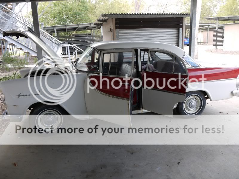

Hey guys, finally got the FB back to my house. I got to take a few photos but im not sure what people want to look at.

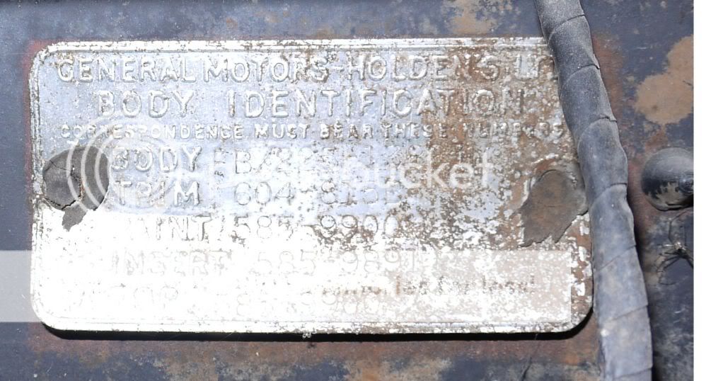

If you cant make out the I.D plate the paint reads 585 - 9900.
I'm traveling to Melbourne today so i wont even be able to start working on her till i get back. Oh well, Rome wasn't built in a day.
Re: Brand new to the Scene.
9900 = Cathay grey body (dark)
9891 = Lilac grey flash (light)

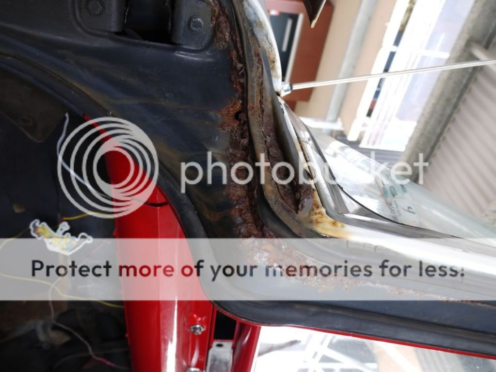

Get rid/treat any rust before it goes any further,dont worry about tunes that should be the last thing on your list.

Yeah, Mick...I'd have to agree with Brett & Jase and leave it until you move. Just hook into the major rust spot and stop it from going any further..wire brush on the angle grinder, rust converter & some paint of some kind (or even grease will do) and it won't rust any further and will be ready for it's re-build later after you have settled into the new abode. :wink:
