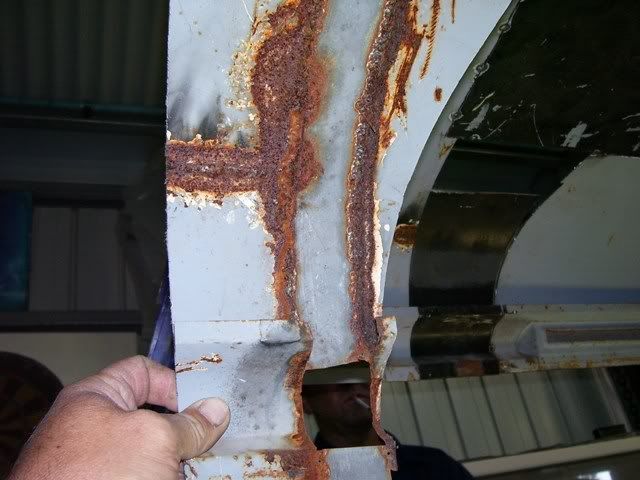

This piece was where the roof was extended 50mm on the left side of the sunroof.
It was cut out and replaced with a piece from the other van which you can see tack welded
into position behiend

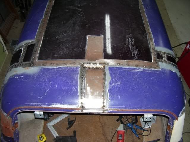

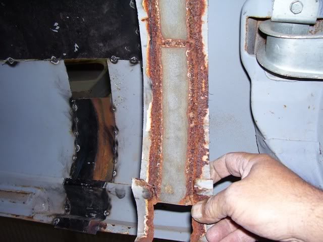

Same thing on the right side.
The gap between this piece and the sunroof filler was also made and tacked into position
This shot from above shows all the bits tacked together at the rear of the roof.
We are getting there
Its going to take a lot of nights, but we will get there

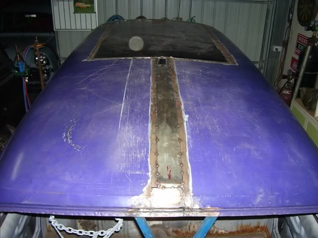

The next step is to repair the strip down the center, from the sunroof to the windscreen.
The the job of oxy welding all this together into one roof
