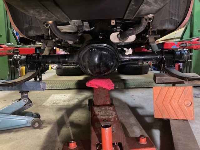

Got the diff center and housing back in, bloody big and heavy bugger.
diff back in.jpg (92.91 KiB) Viewed 1721 times
Get all the rest back in during the week, test on the weekend hopefully then a big wash !
