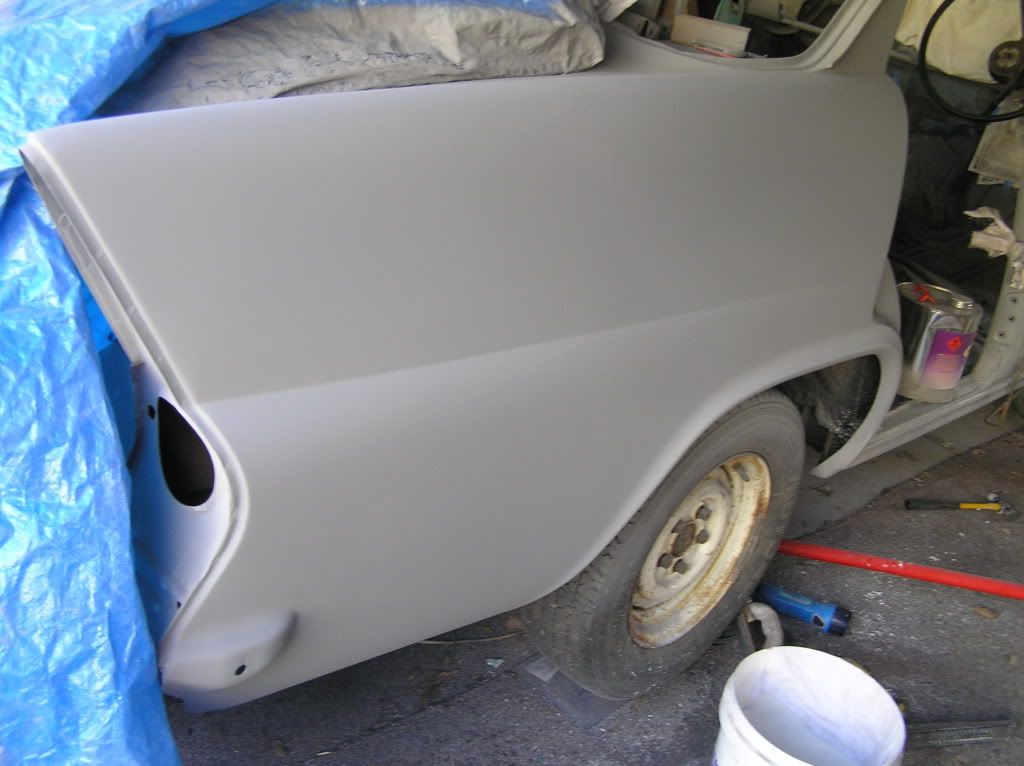

During the week I got the boot and passengers rear quarter primed...
Stripped the two front guards and stone tray too.

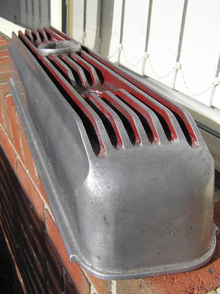

Also picked this up tonight.....
I want to paint the grooves in the top of the rocker cover in satellite yellow (same as the body).
Can I use the same acrylic or will I have to get something else mixed up :?:

you could use acrylic but would be better off with enamel or 2pak

EKSPCL wrote: A mate of mine has told me to be not to put pinstriping enamel on the acrylic paint because it will react with the acrylic.
Is the pinstriping paint always an enamel :?:
If so why can all of these cars be done when most are probably acrylic :?:
all paints can react but it's usually the other way around can't put acrylic over enamel, enamel on acrylic is ok 99.9% of the time
