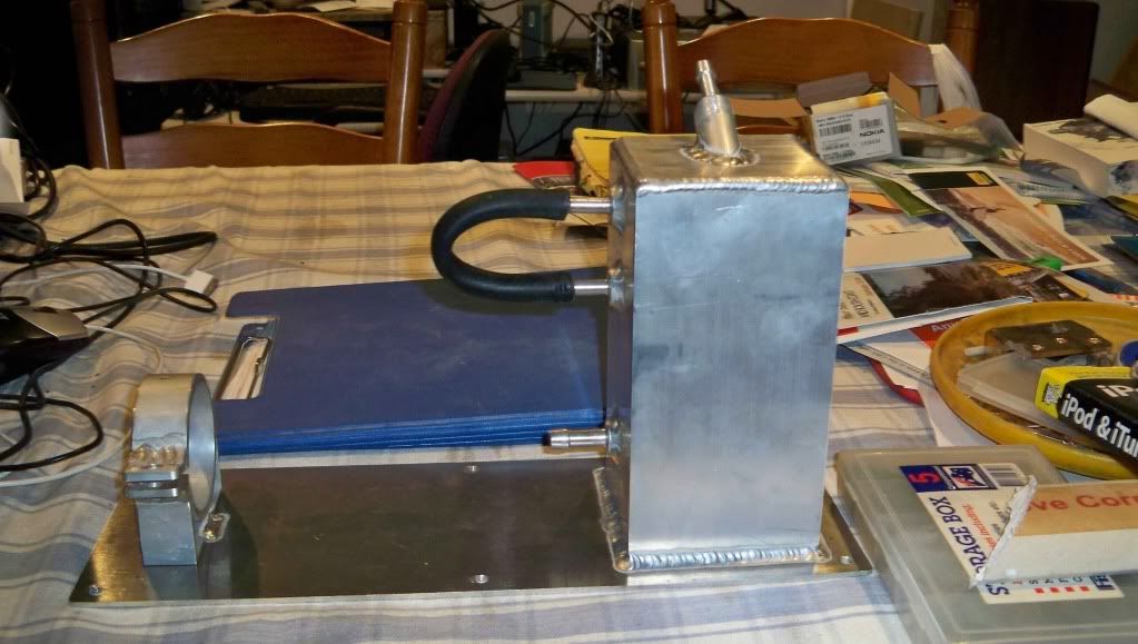

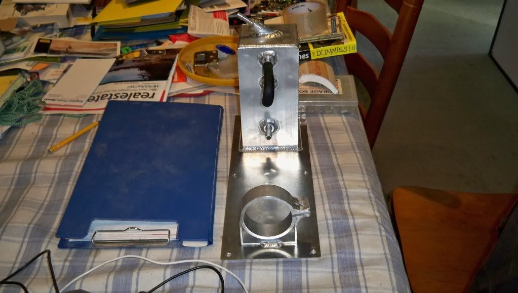

Here is mine from the
bay. Be careful as I found mine had a pin hole in one of the welds and I can't get in contact with the guy I got it from now, funny that. I am off to get it fixed today.
Have the EFI pump pick up on the bottom, the next one up is the fuel line return, then the over flow back to the tank and a breather back to the tank on the top...
Whatever....:(
