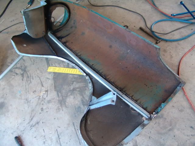

matchew wrote:i like the height bu hows ur front guards go on full lock?
No probs, the front guards have 20 x 20 mm rhs welded inside behind the chrome trim, I rolled it 20mm before fitting, this has "pumped" the guard subtly and given the additional clearance required to drop it so
Here is a pic when I did a trial run on an old guard to see if it would work:
