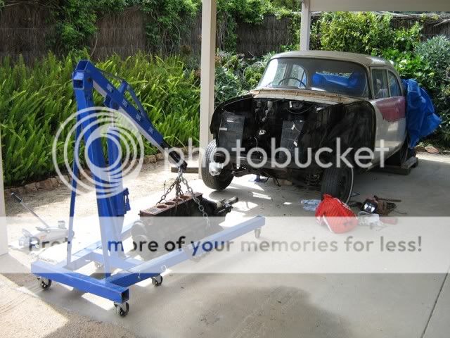

Going to have a go at taking the engine and transmission out this weekend. We have borrowed an engine crane and i have been disconnecting and draining everything.

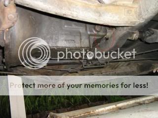

Do i just have to unbolt these four bolts to get the shaft off?

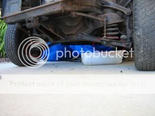

If the transmission tips down to get the engine out will the steering need to be disconnected?
We just had a look with the engine crane and the support arms can't fit under was going to jack the car up then put the crane in or is there an easier way?
Don't undo those bolts, undo the ones that join to the uni joint near the diff, then just pull the shaft out of the back of the box. Then remove the gearbox cross member.
TimR wrote:If the transmission tips down to get the engine out will the steering need to be disconnected?
No.
TimR wrote:We just had a look with the engine crane and the support arms can't fit under was going to jack the car up then put the crane in or is there an easier way?
The engine crane should have an extendable lifting arm, that should help.

1st pic,
The four bolts circled in your top pick only hold the floor crossbrace/gearbox crossmember in.The gearbox isn't mounted to that crossmember but the crossmember has to be removed to pull out the motor and gearbox as one unit.Basically the gearbox is just bolted to the motor and hangs there with no rear support.
Tailshaft can be undone with a 7/16th ( or 11 mm) spanner by undoing the 4 bolts holding it to the diff centre pinion.Wrap tape around the rear uni joint because,as sure as shit,if you don't, the uni cap will come off and you'll most likely lose all or some of the needle rollers.
2nd pic,

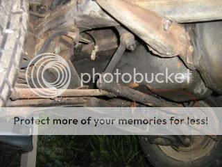

Steering shouldn't need to be disconnected if you have the engine/gearbox at the right lifting angle ( approx 30 degrees) but you could disconnect the idler arm via undoing the attachment bolts at the subframe member ( passenger side) should you need to.This will drop the steering down a little.
3rd pic,
Jack up the car high enough to get the jack stands under the car.
Place your engine stands under the floor crossbrace members which are approx underneath the footwell ( floorpan) of the front floors.
Hopefully they aren't rusted out or otherwise the weight of the car when lowered onto the stands will crush the rusted floor crossbrace.
This should then allow you to get engine crane support arms underneath the car unhindered.
