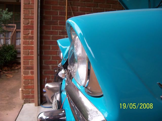

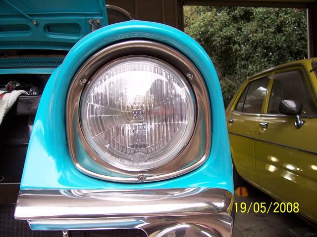

Hi Yeprat,
as requested I took three pix to give an indication of how the protectors alter the flat faced appearance of H4's.
They will not however give an original look, but distract attention from the flat face which I feel detracts from the look of our model........ eyes and stuff.....
One point though, they are much deeper than an original bulb lens or sealed beam.
The protectors fit between the glass lens and the chromed retainer - if you decide on doing this, I would encourage you to drill those holes I mentioned above.................
Hope these give you a true indication of how the protectors will alter the look.
