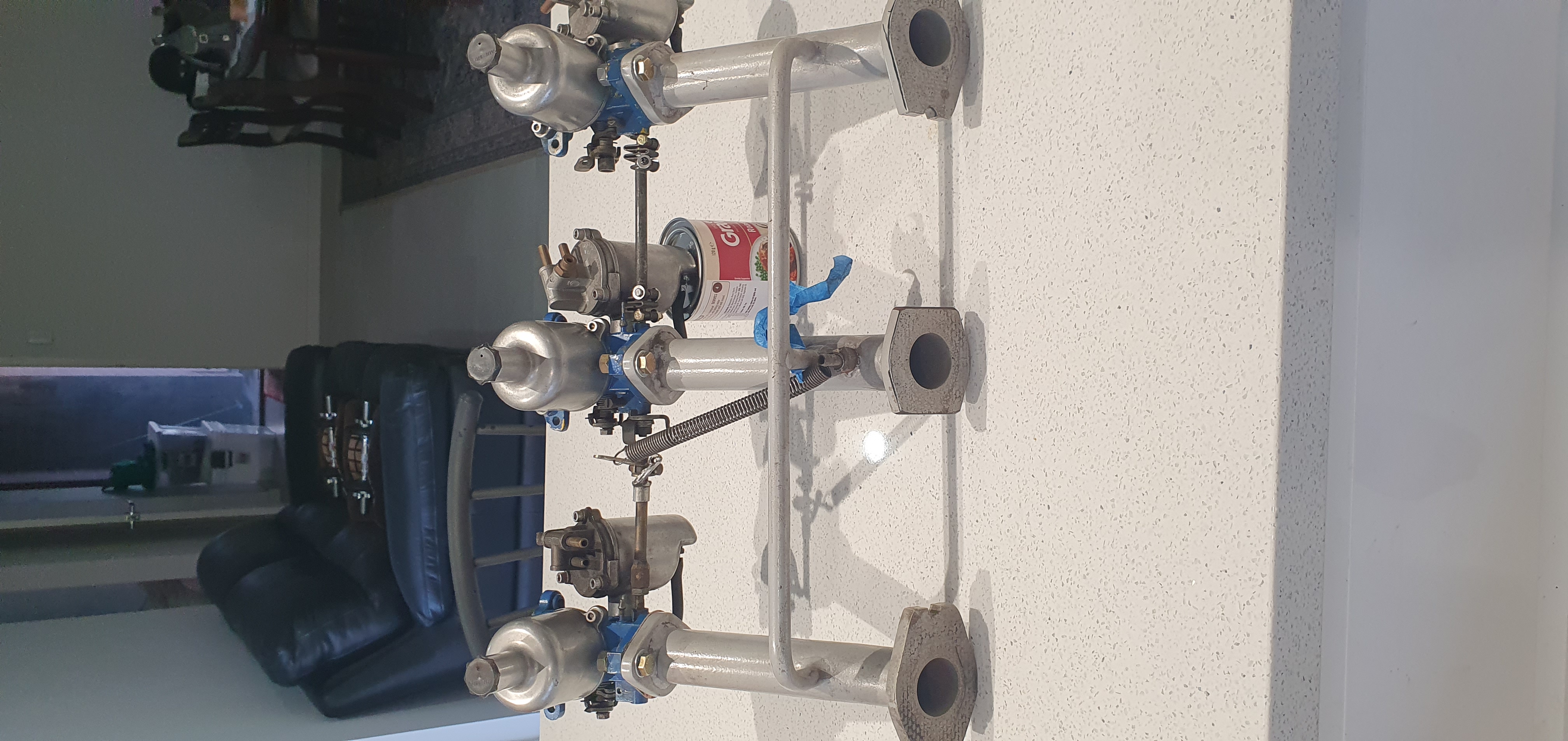

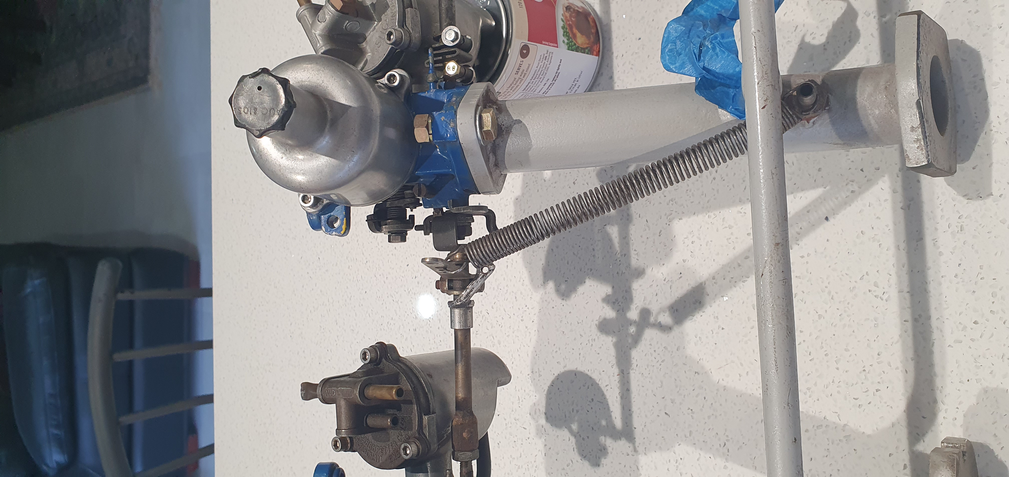

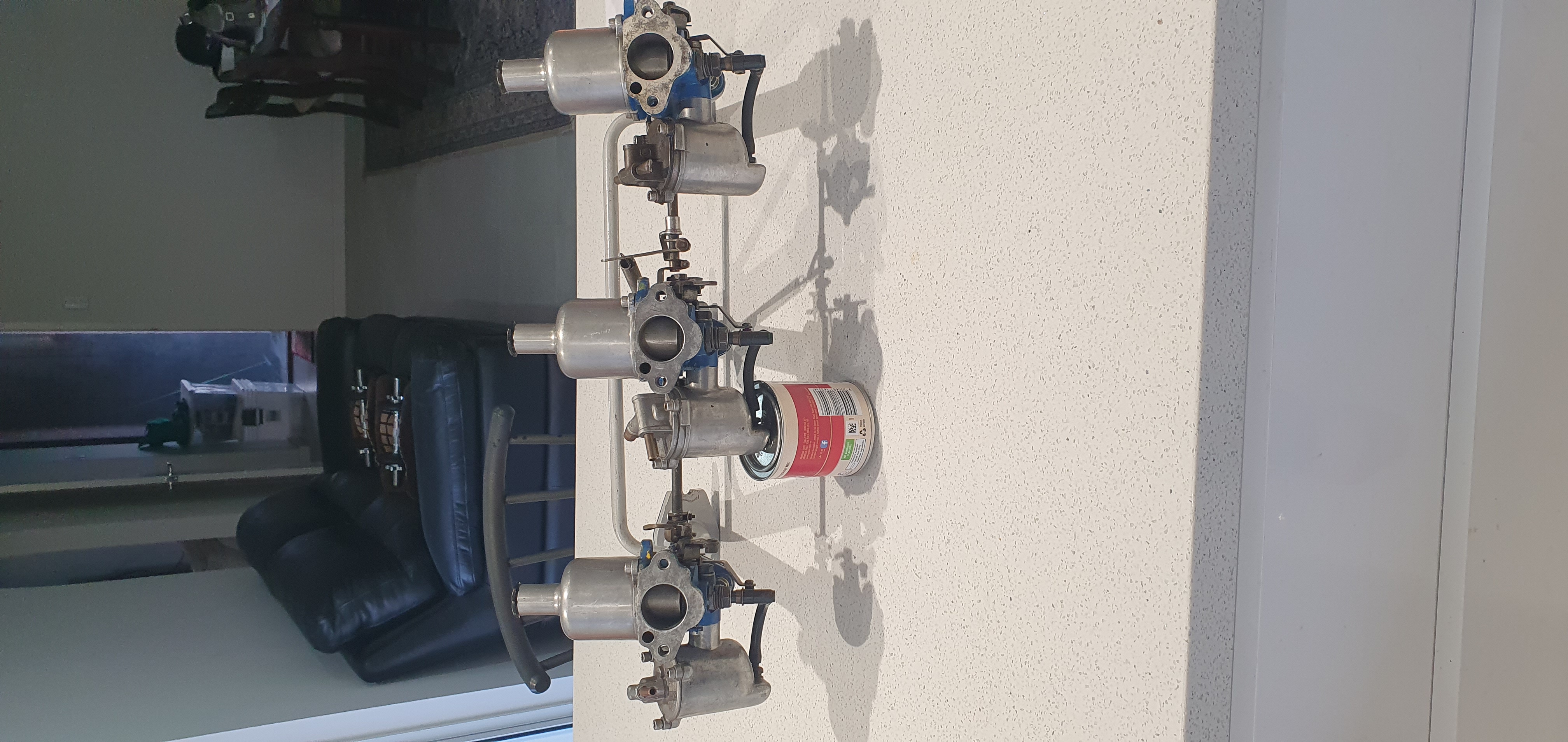

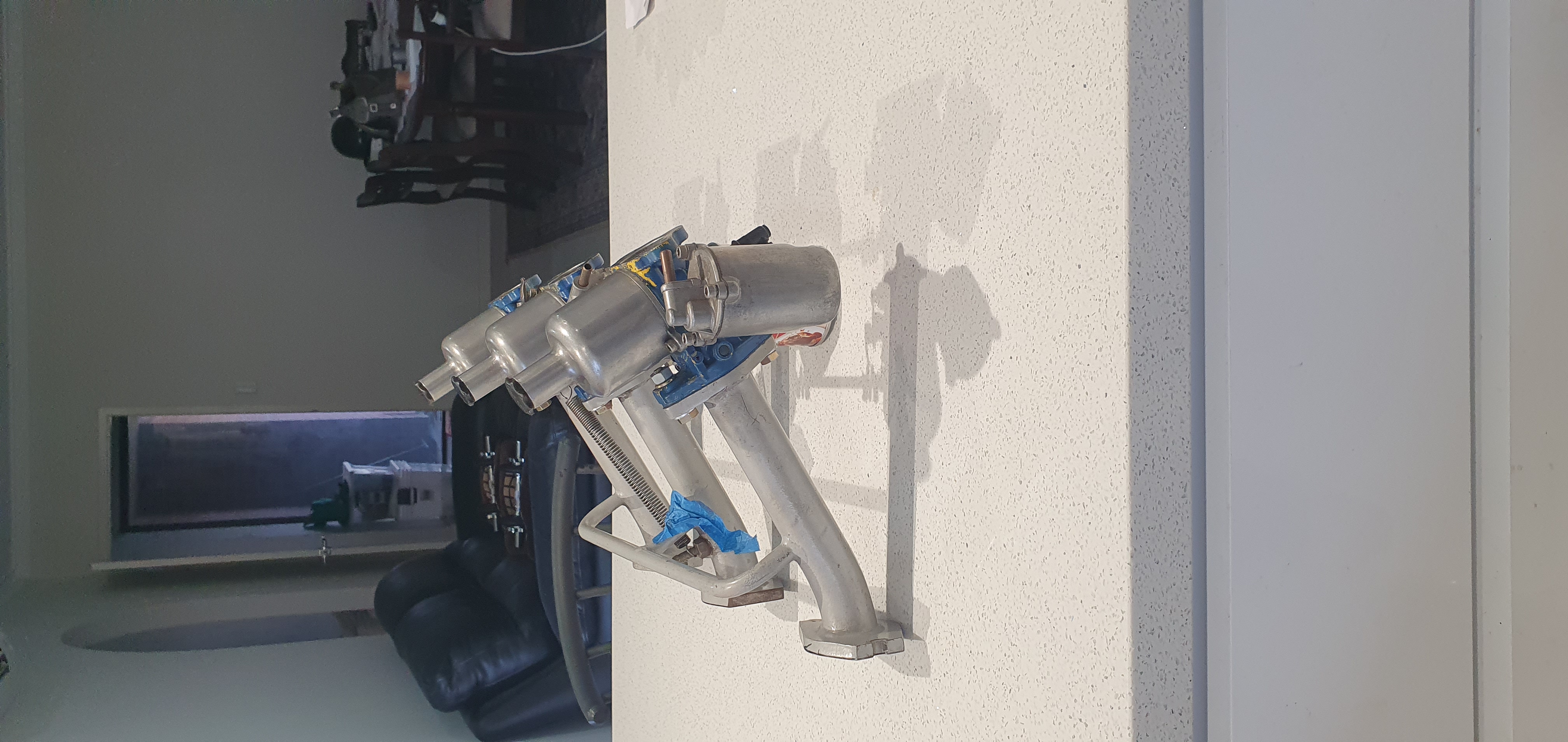

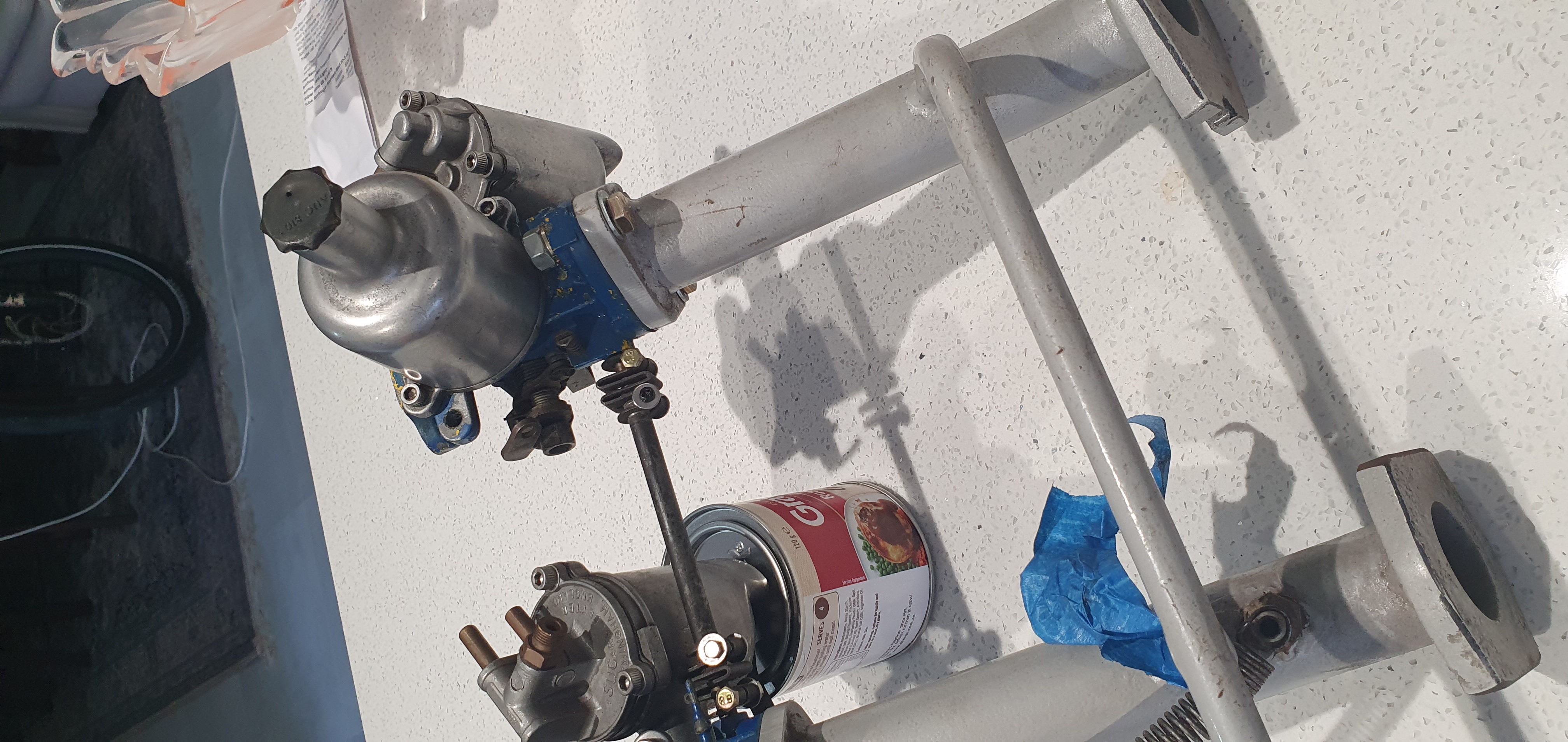

Re: Are you Bored? Bang for Buck Engine recipe required.
Hi guy photos attached,
Please add comments or advice about the carbys if you spot any issues.
They are going on a humpy so no battery or heater box to worry about.
They look tidy. Fuel bowls facing forward is good for firewall clearance, well in an EK at least. Long runners = good torque. As said the round linkage shafts, but you know that.
