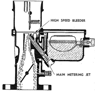

P66: “Tuning procedure for Zenith, Solex and Stromberg carburetors follows recognized textbook or instruction manual methods, as long as petrol is retained. A difficulty sometimes arises, however, when multiple mounting is used, because the intermittent flow conditions then present may make mixture regulation difficult, the usual effect being to cause the mixture to become very rich at or just before full throttle, and the engine will show a reluctance to run at a speed which should be well within its capabilities. This effect can usually be cured by increasing the air-correction jet size, though, in some Stromberg models, this jet is simply a drilled hole and is not normally alterable by fitting another jet, as in the Solex or Weber. For example, the air-bleed in the Holden Stromberg is a hole of 0.020 in. diameter drilled in a small bullet-shaped pressing near the outer edge of the venturi. When two are used to feed the six cylinders, this hole should be drilled out to 0.060 in. After this treatment, the carburetors will be almost impossible to tune correctly, if sold to some unsuspecting person who endeavors to use just one of them on a normal engine, unless the air-bleed hole is reduced back to its correct size.”
Phil is proposing here to open up the high speed bleeder holes (see image below), which are #70 drill (0.0280”). These should not be confused with the much larger (#52 drill or 0.0635”) idle air bleed holes. The high speed bleeder holes allow air to mix with the fuel coming out of the main jets, emulsifying it. By opening these holes up, the main metering circuit becomes leaner, with the fuel being more “bubbly”.
High speed bleeder.jpg (35.94 KiB) Viewed 10373 times

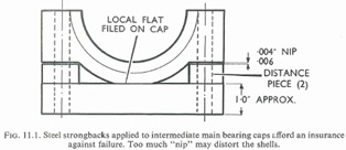

P116: (on how much crush (“nip”) to use on main bearing strongbacks)
bearing strongback crush.jpg (15.31 KiB) Viewed 10371 times

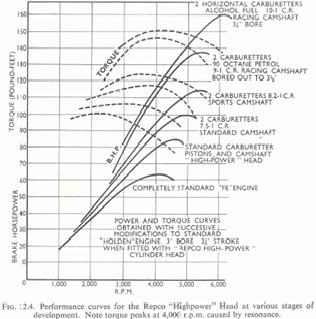

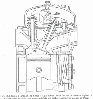

P128: “The Repco “Highpower” head produced in Australia for “FE” Holden engines, shown in section in Fig. 12.3 can also be fitted straight to an existing engine, increasing the output of the 3-in bore x 3 1/8 in. stroke engine from its normal 64 b.h.p. at 4,400r.p.m. with one carburetor, to 88 b.h.p. with the same carburetor and 100 b.h.p. with two large ones. Further modifications produce still more power as shown in Fig. 12.4. these curves are representative of many readings taken during development of this head and shows the effect of successive modifications. The section (Fig. 12.3) shows the large 1 9/16 in. inlet valve with smoothly contoured port; the apparent interferences between it and the vertical, much smaller, exhaust valve is because they are offset in plan view and not straight across as usual. Even without this head, the Holden engine can be made to develop around 130 b.h.p. on petrol and 145 b.h.p on alcohol with three carburetors and can be run up to over 7,000rpm. The critical crankshaft speed is 6,300rpm, This head will not fir the 149 and 179 cub. In. engines.
Repco head power output.jpg (39.04 KiB) Viewed 10371 times
Cross section of Repco head.jpg (33.91 KiB) Viewed 10371 times
