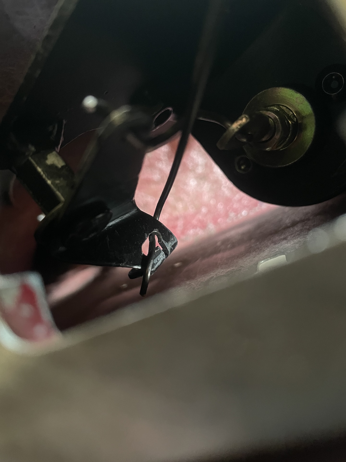

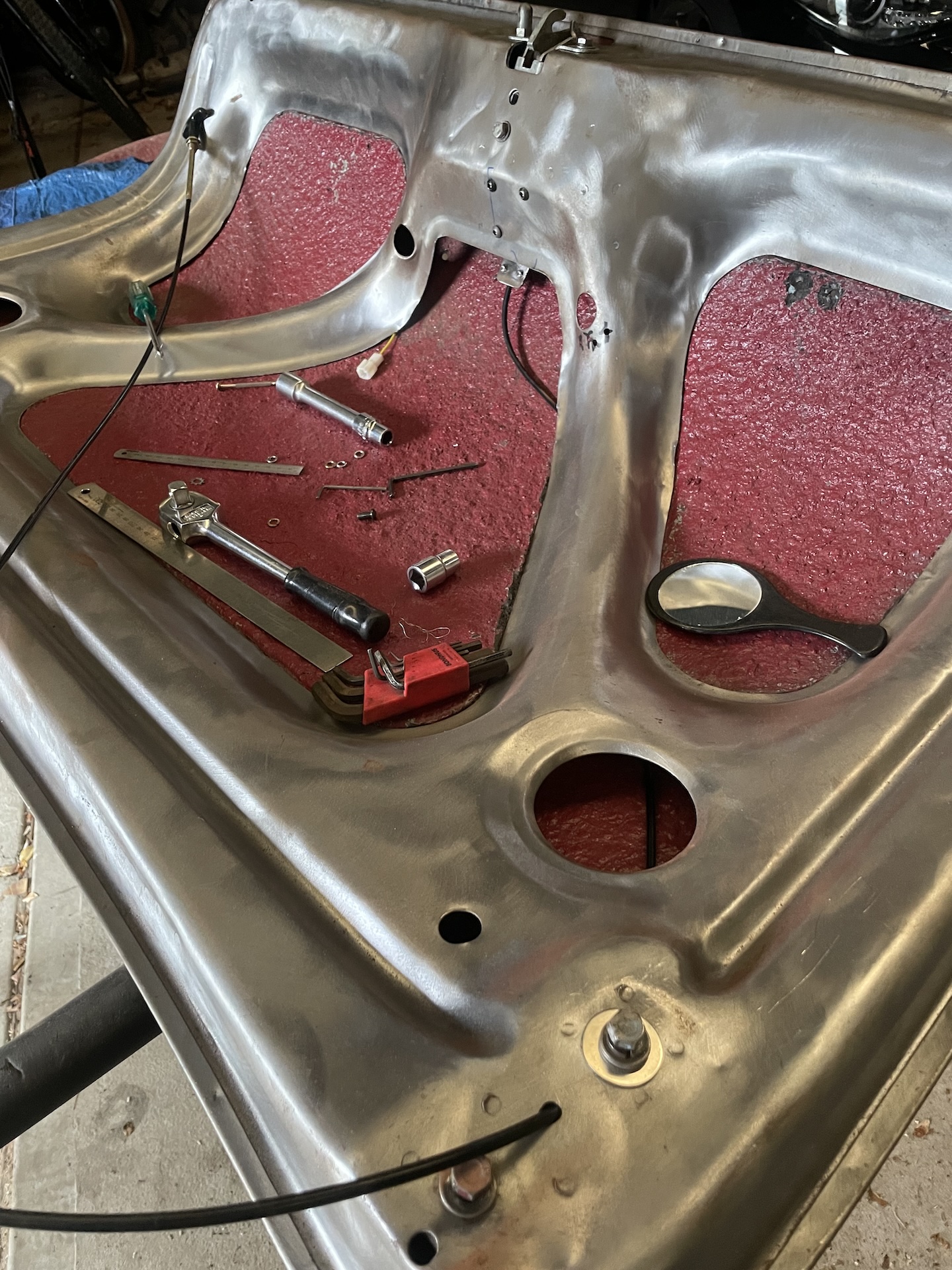

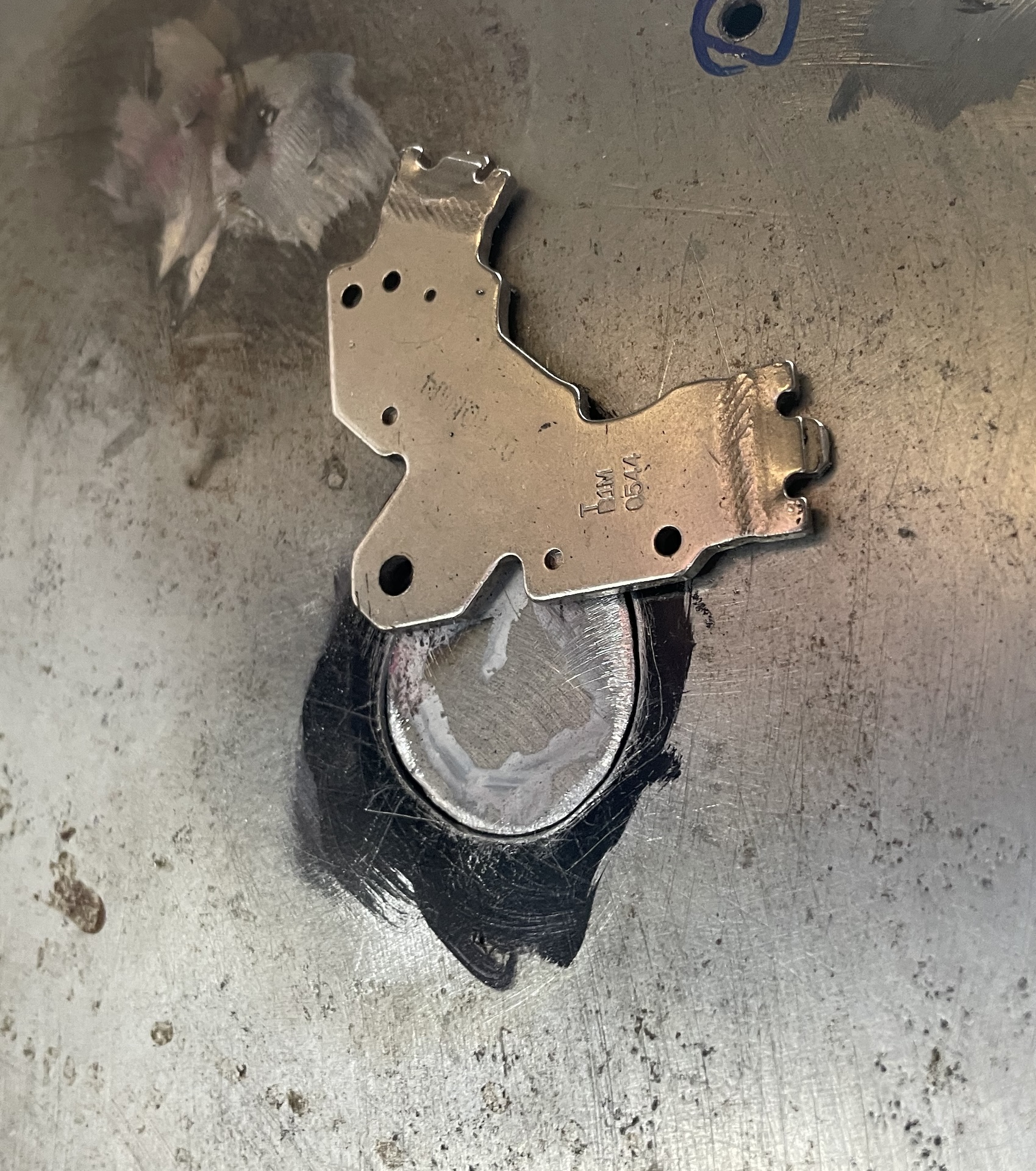

Took the xmas break to finalise the boot popper. What started out as a quick test fit to prove the concept ended up being a slow and painfully boring repetitive fitment as each of my brilliant ideas literally unravelled. From a fraying cable, to the lock not engaging when closed, to just the general gymnastics required to get it all in and bolted up, I was pretty ready to ditch the whole idea. But hey, had the time, so I stuck with it and in the end I have this.
Install is something like this.
Run emergency release cable through hole in hinge bracket.
Feed bare solenoid up into the lock area parallel to the bottom edge (just fits) and turn so that it is facing the lock mounting hole. With other hand, drop popper mounting bracket/pivot down through the hole and attach the hard line between the pivot and the solenoid before attaching the solenoid to the mounting bracket with two bolts. Not as easy as it sounds.
Attach a second hard line from the pivot to the popper to the lock pivot arm, and also attach the emergency release cable, making sure neither foul the other.
This is the main modification from the previous posts. Was not super happy with the popper pulling the cable, which is pretty violent and I figured would stretch/ break the cable over time, and then I would have no emergency release either.
Now slide lock and popper into place and bolt everything up.
Finally, clamp release cable leaving a little slack in the line.
Much happier with this as now the popper and emergency cable are independent of each other.

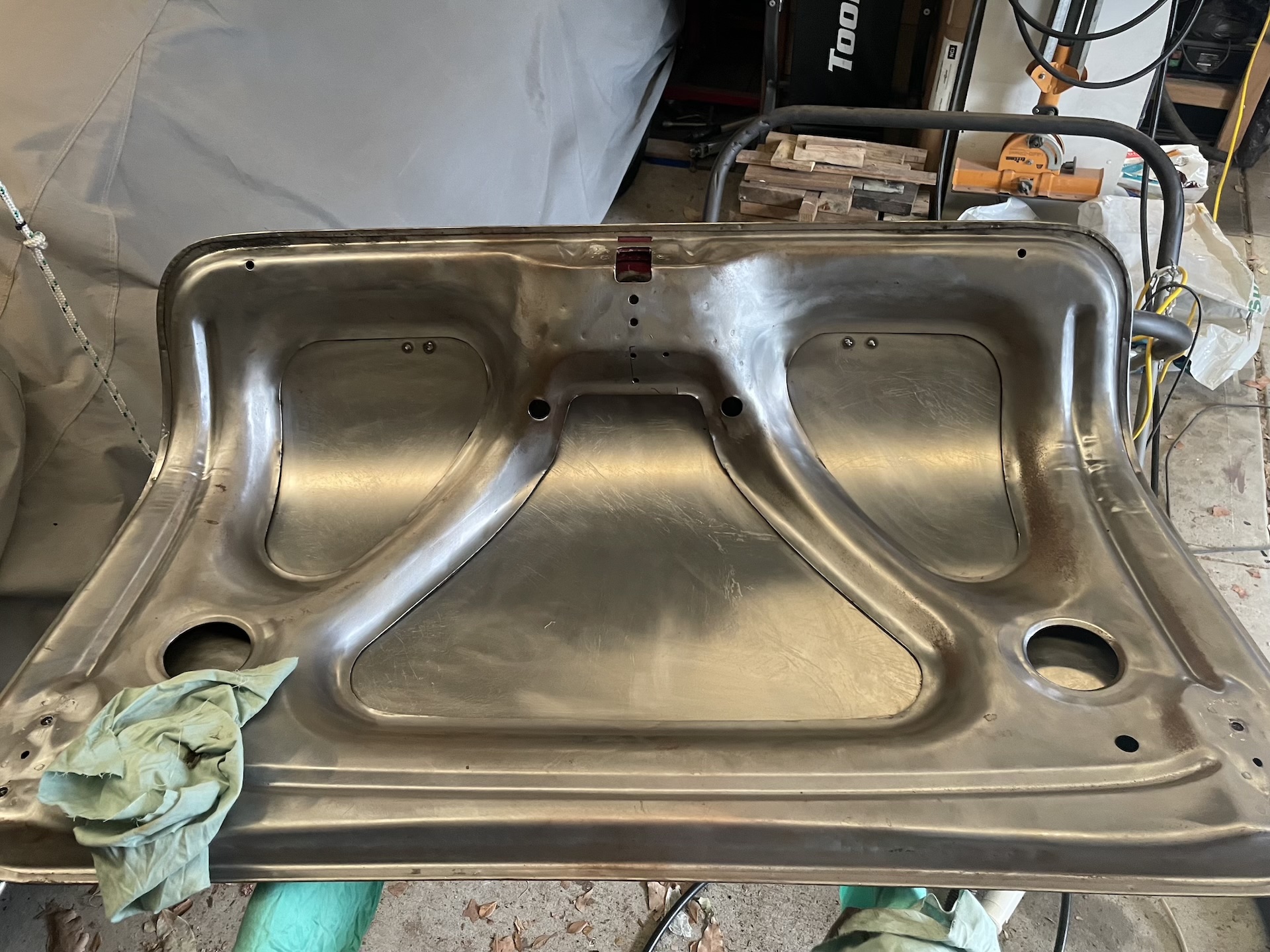

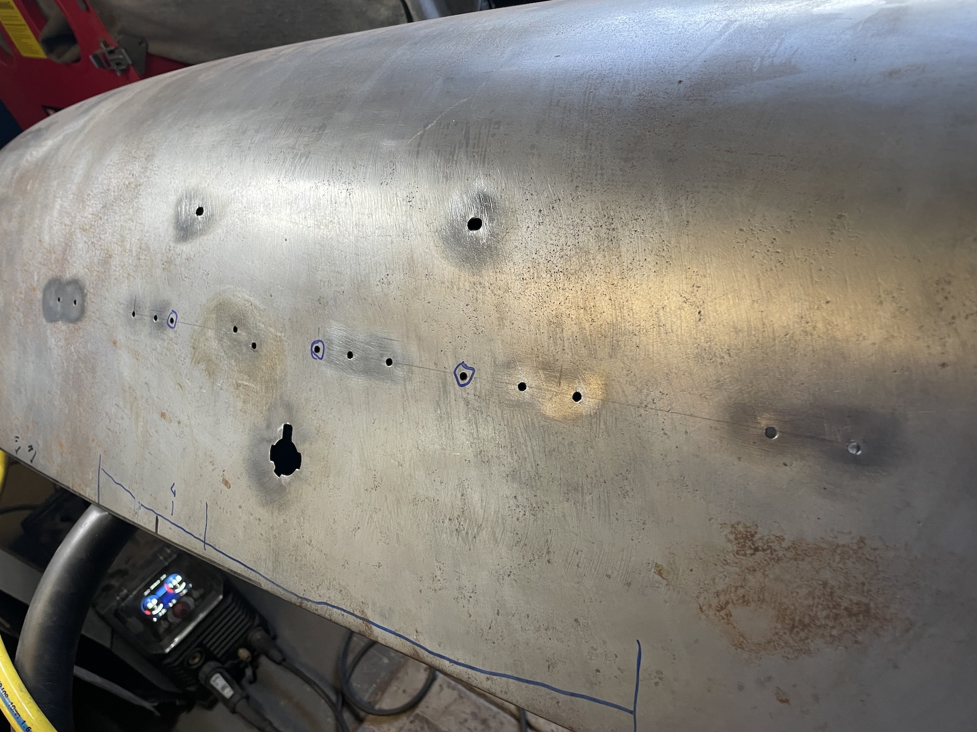

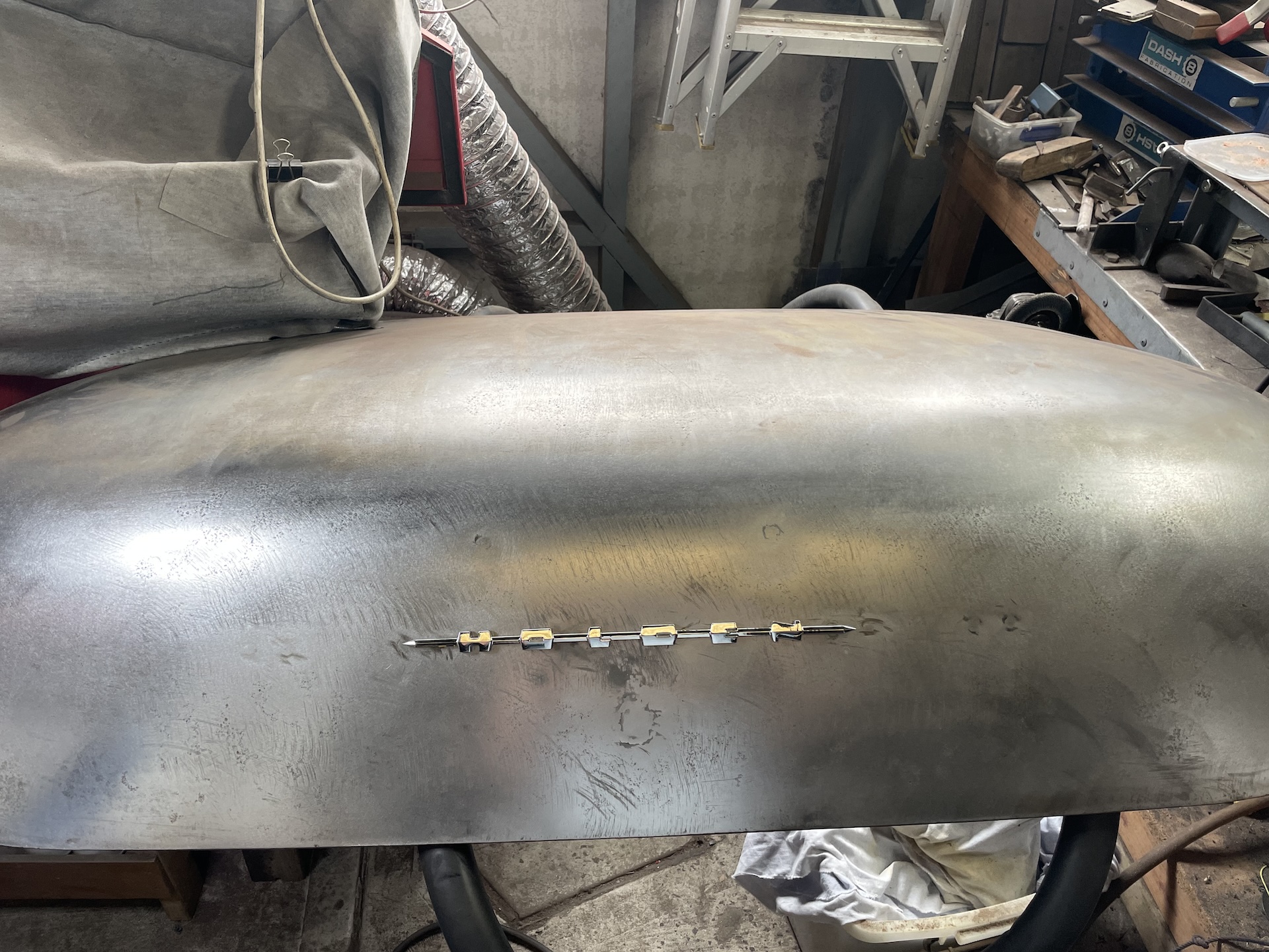

Moving on. Time to delete a bunch of holes in the boot lid, and at the same time add three more.

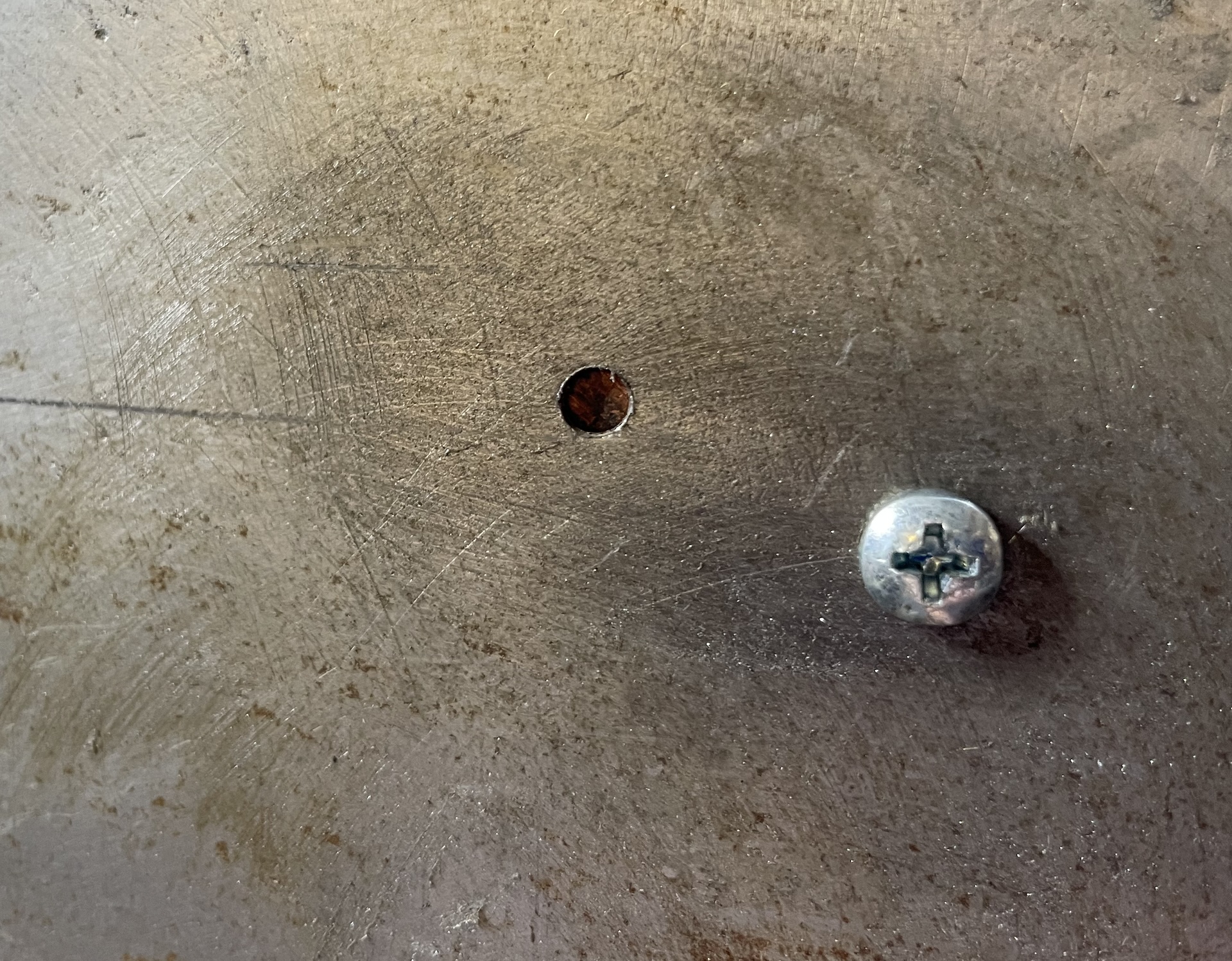

Used a bit of copper with a tread tapped into it to hold in place when welding to delete the 12 holes for the HOLDEN letters and winged it for the hydramatic badge.
As the pooper appears to work, no need for the lock.
Short time later,
Holden badge was a birthday gift this year. Liking the slightly less understated FB branding.

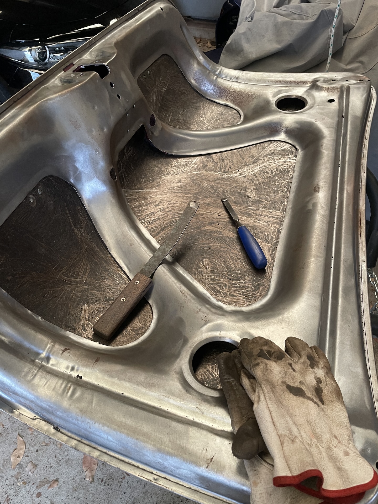

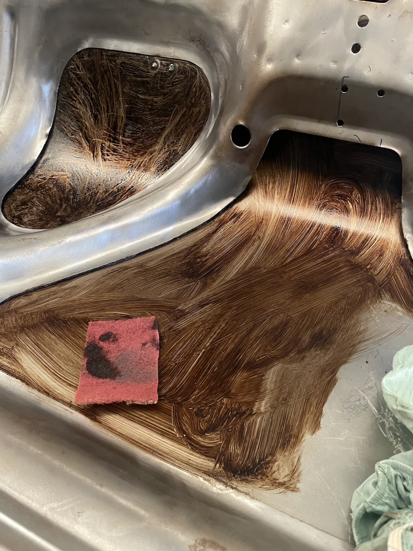

But not done yet. Body deadener. If I'm stripping the paint off then this has to go. Could use heat, but that ends up in a mess so went with the trusty chisel instead.
Much time later, and then som more as I tried to extricate all the loose bits of bitumen with a vacuum and air gun.
Wax* on.
Wax* off.
*wax and grease remover.
Quick scotchbrite and lashings off easyphos to keep the brown bugs at bay, and its as good as ready as it will ever be for primer
Scott
Posts: 11582
Re: Ol' Rusty - FB/EK Sedan
I love that Scotty! Very thorough taking that stuff off. Kero works also.
Posts: 14174
Another easy way to remove body deadened is dry ice - makes it super brittle and can remove with a scraper in no time 👍👍

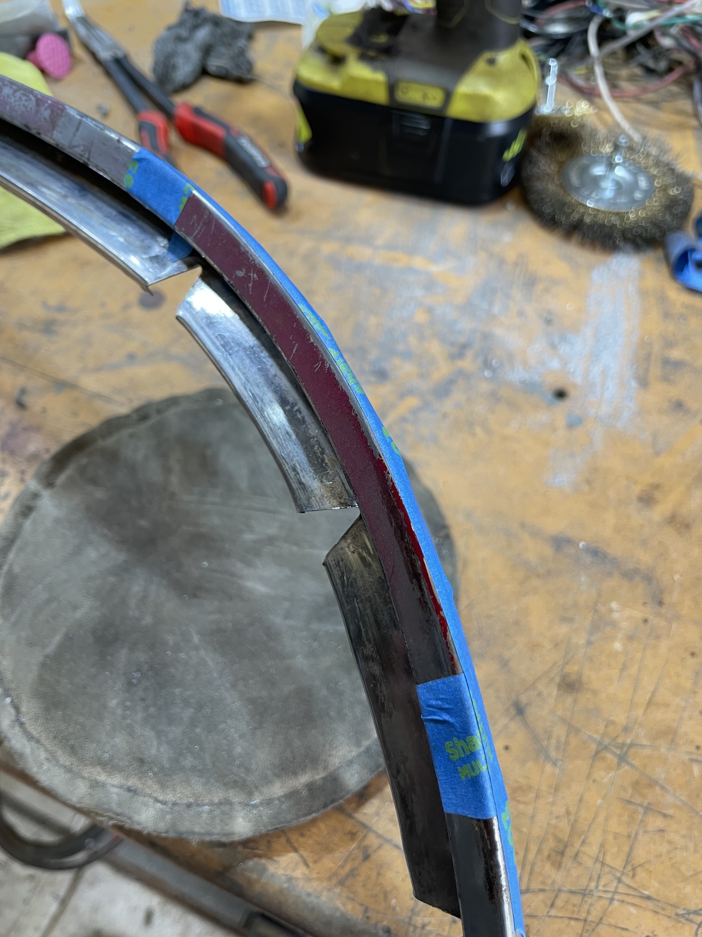

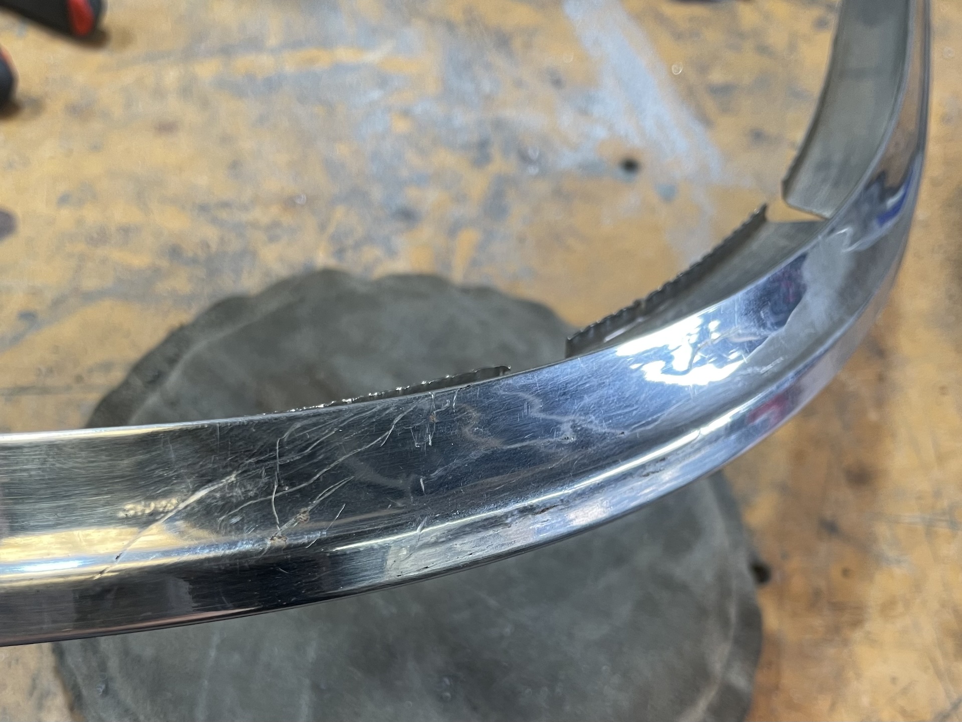

Pulled the front and rear windscreens out for an inspection. Front is toughened and has a chip and wiper scratches so need to get a new one. Rear looks good and if you squint in the right light you can even see the safety watermark top centre of glass.
Grabbed all the stainless trim out of the crumbling rubber, and after inspection I need to do a bit of repair to the bottom piece of the front windscreen.
Does not show up well in the camera but the passenger side is pretty rough. Various gouges and scrapes.
Only way to get in behind to tap them out is to cut the bottom out of the trim and weld it back in. Marked with tape and cut with a 1mm Dremel cutoff wheel.

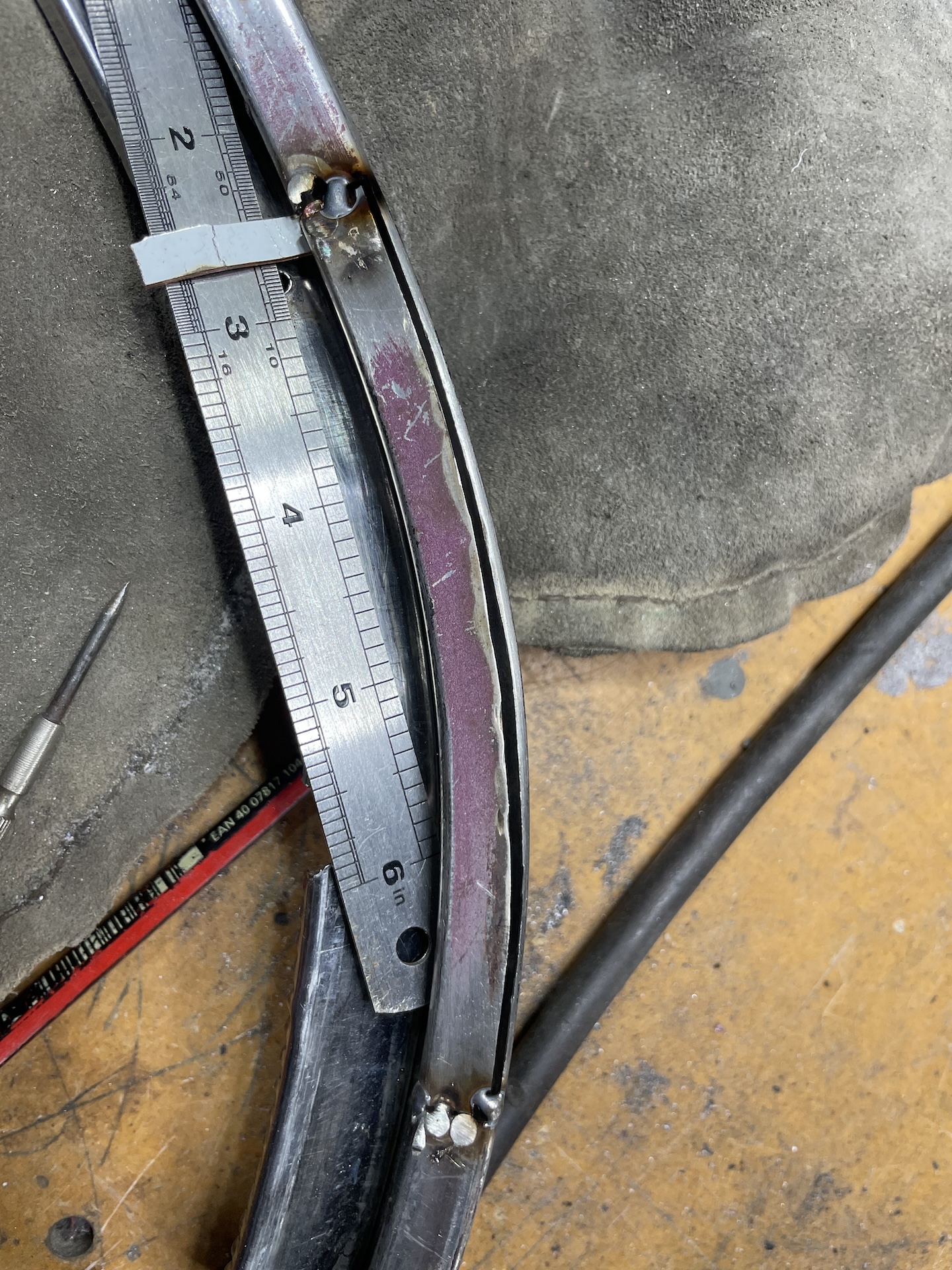

Much tapping and hammering and ready to weld in. Except all the tapping and hammering has stretched the trim. Cut out bit is a good visual guide to how much it moved.

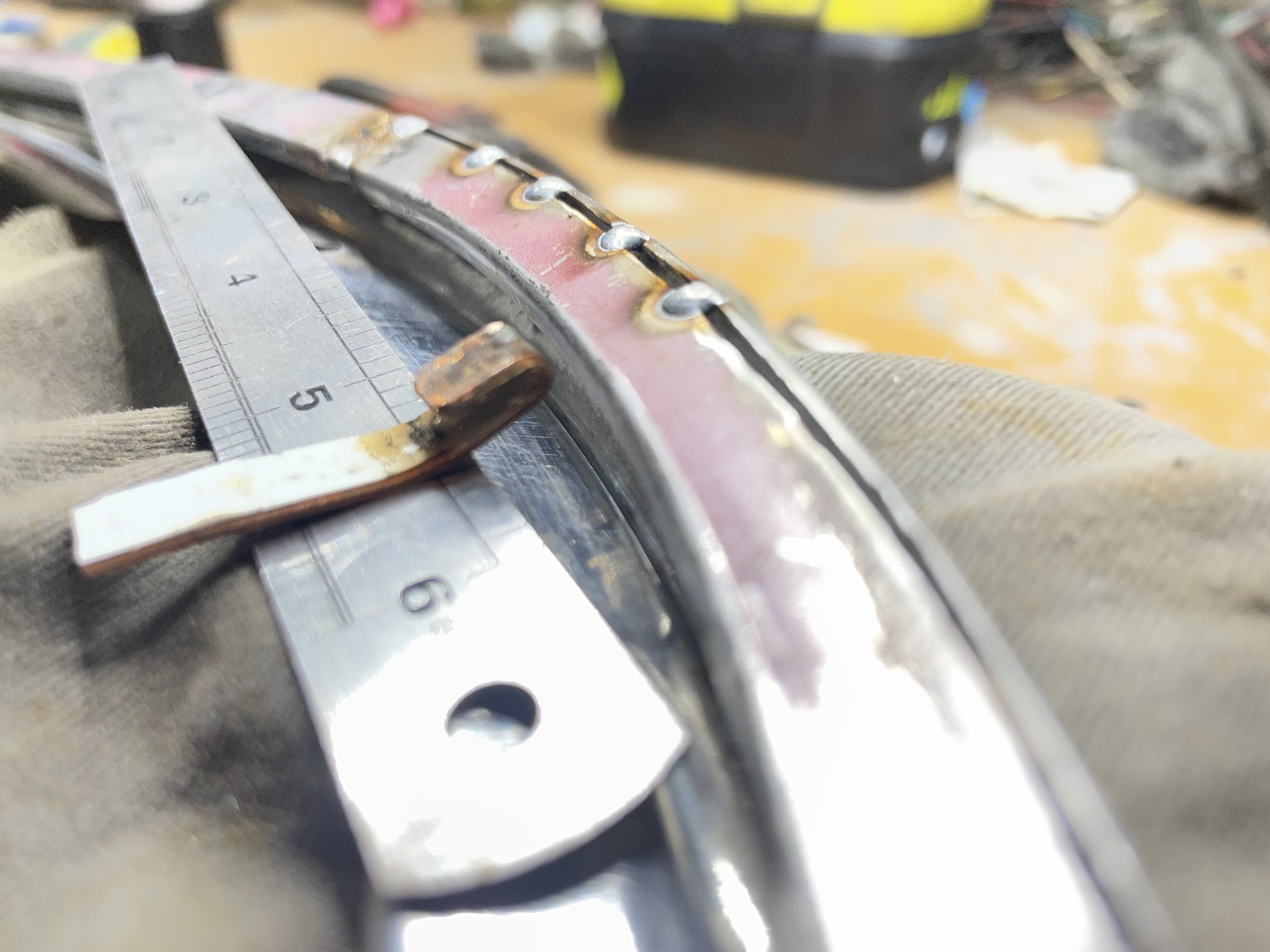

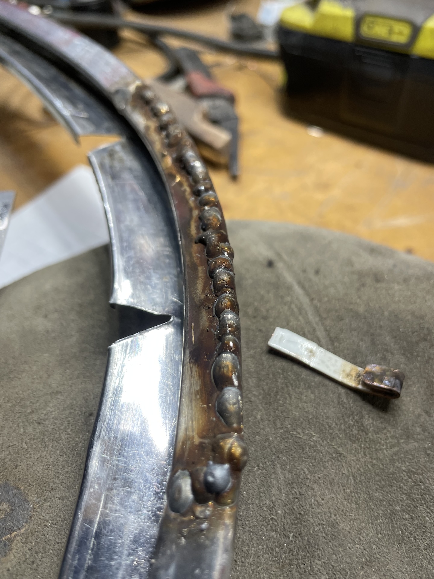

Spent a bit of time with the shrinking disk and then gently eased the lip back into a better position. Gambled on tacking it at each end, with the hope that if I went in from the ends that it would naturally close up.
Tacking along, using a bit of scrap copper and a steel ruler to hold the copper over the weld when tacking.

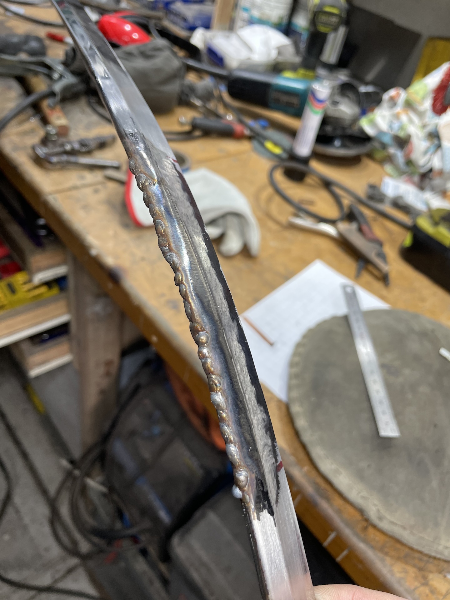

Ground off the tacks the filled in the gaps to create this blobby mess.
Ground off the weld and then dress with a file, then 80 grit on a block to reshape the trim.
Still a bit wavy in the light but a bit of an improvement me thinks. Put it in the pile to be sanded and polished.

Good work there, the stainless trim will polish up nice. Did you use a steel hammer on the window trim, is that why the trim has stretched? What did you use to tack the trim back together?

Hey Stephen, I used hardwood pieces profiled to the curves and a steel hammer to knock out the fine creases, and then a plastic mallet to form the rest. Was hoping that cutting out the piece under the curve would force it to hold the shape, but the trim is only 0.5mm thick so it was asking a lot. Used 0.9 316 stainless wire to fill it all back in.
