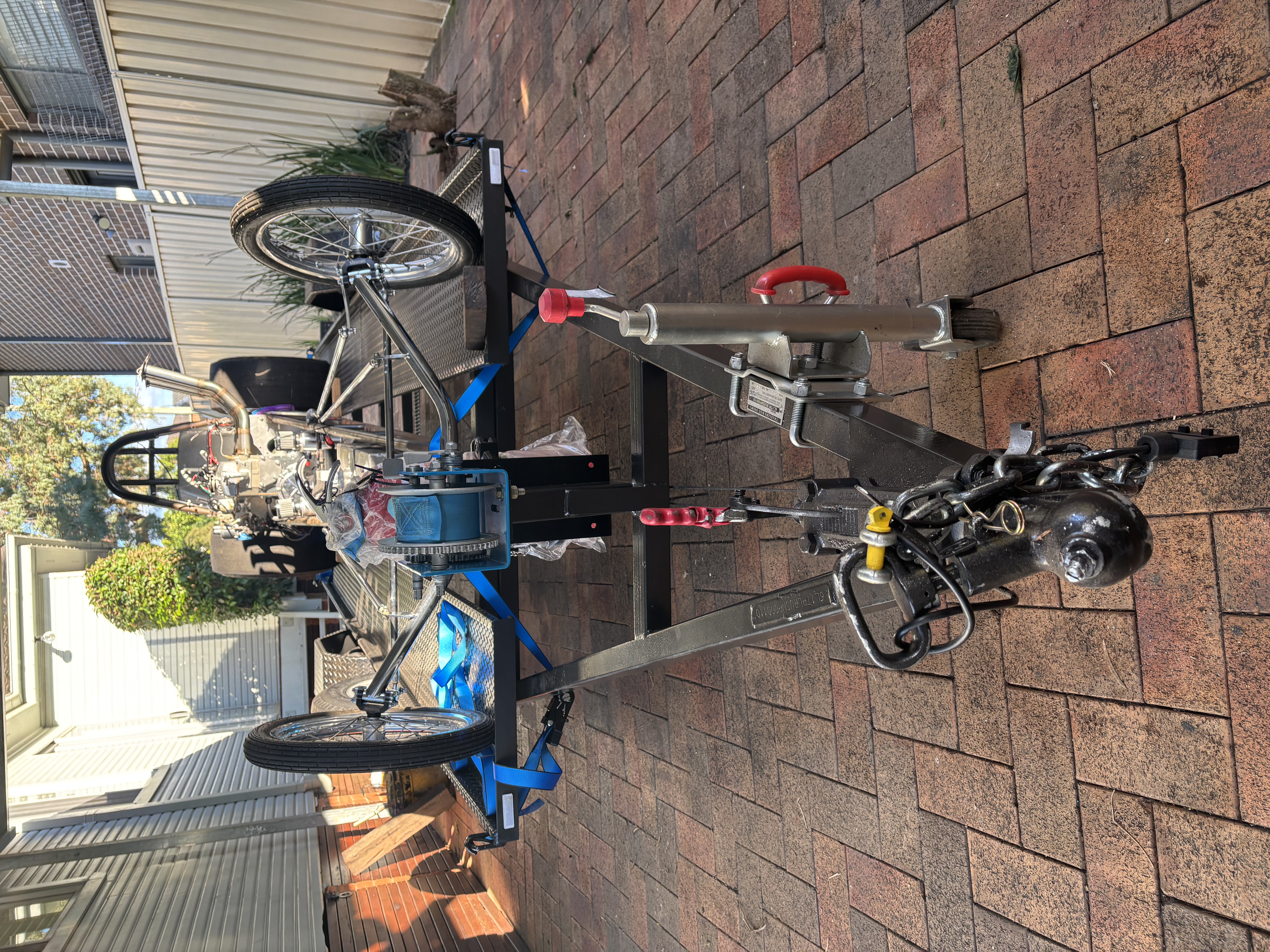

FED all tidied up and stored at Kennards for the shed build. SUs and side plate in place temporarily to keep the dust out. I can work on it there (within reason) but it will be a little disjointed. Got lucky and the local Kennards has a loooooong car garage that fits the FED and trailer… by inches.
