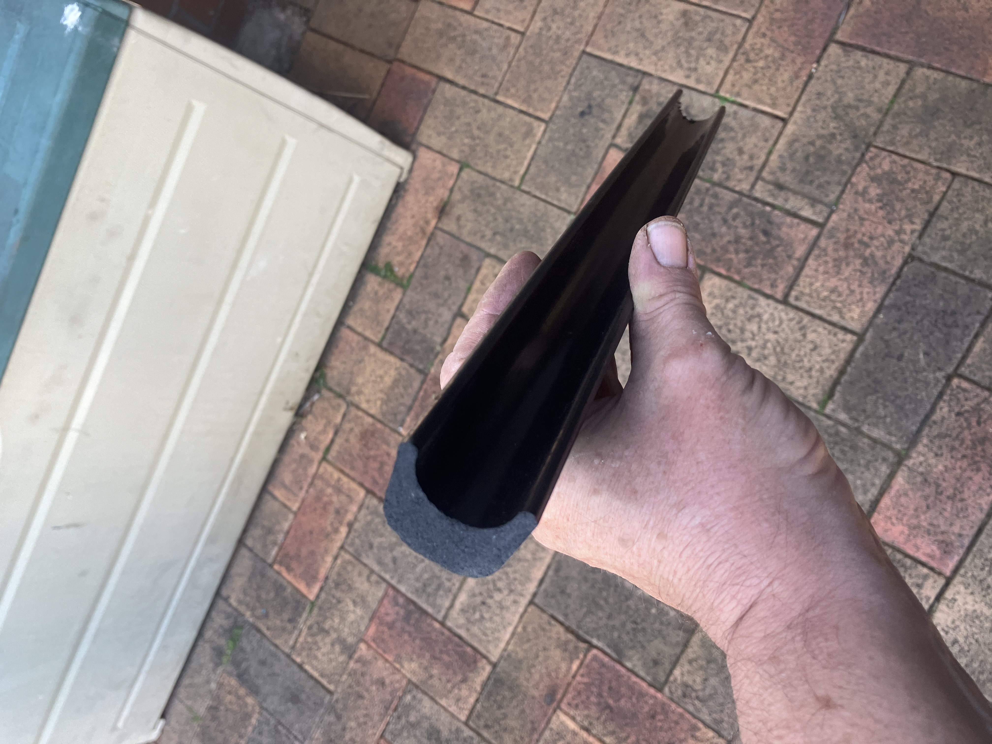

I do not like roll cage padding. :(
Everything that the driver’s helmet can touch has to be padded. The padding has to be SFI certified… no pool noodles or hot water lagging.
Bought the certified stuff, which come in 900mm lengths… for $60 a length :shock: It’s softer than pine, but harder than polystyrene. Could readily be used for the ancient Lancastrian martial art of Ecky Thump. Cuts easy. Hates bending.
The simple bends are OK - hold it in place with cable ties, then slowly press it into the curve. Tight curves are bad - bend it a little too much and it snaps. Heat does not help much. Best way I have found is to put lots of cable ties on it, then tighten them up one or two clicks a day until it seats into the bend. It seems to relax over a period of hours. Have got impatient more than once only to hear that snapping noise. Probably spent as much in cable ties as the padding.

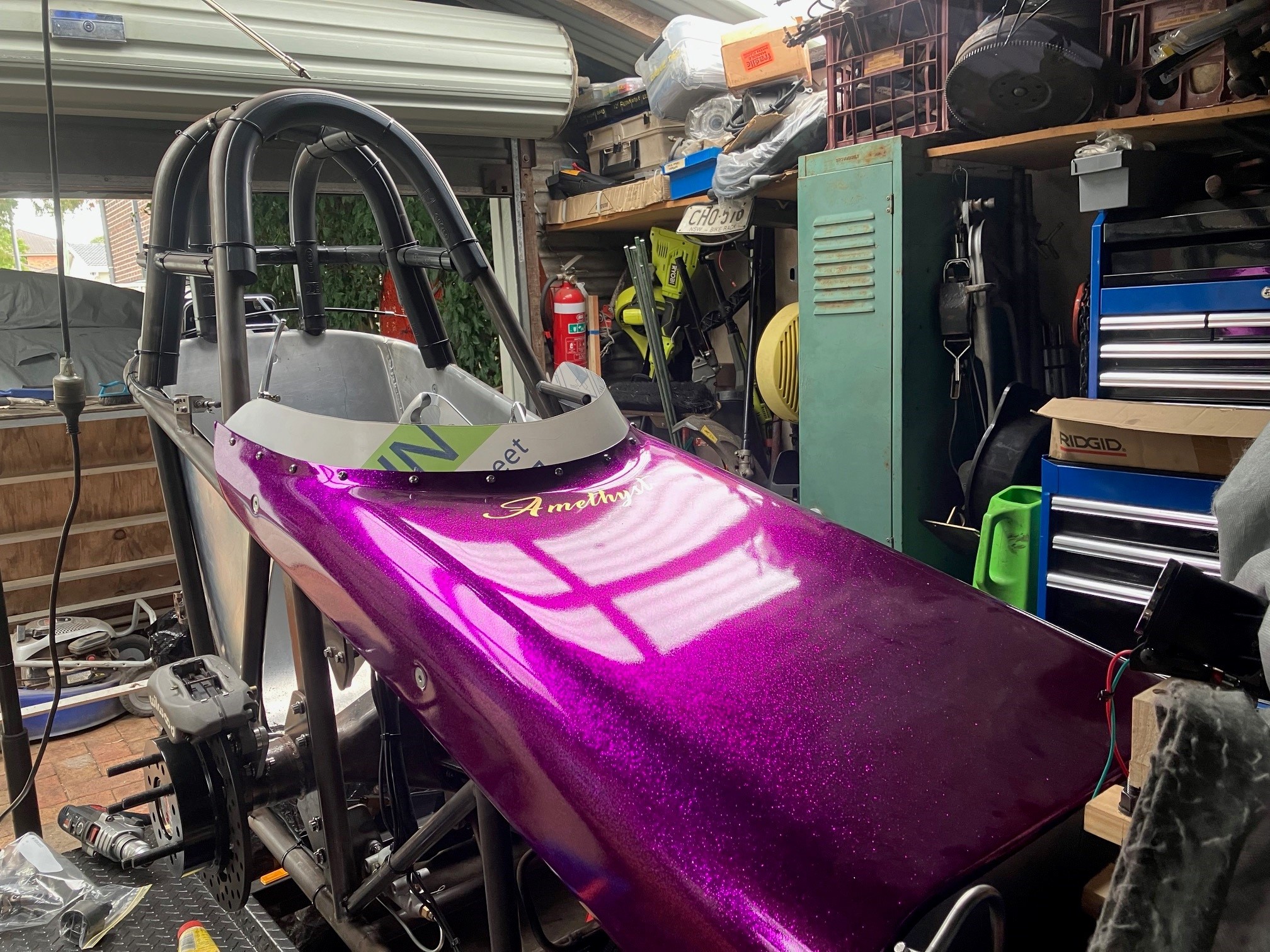

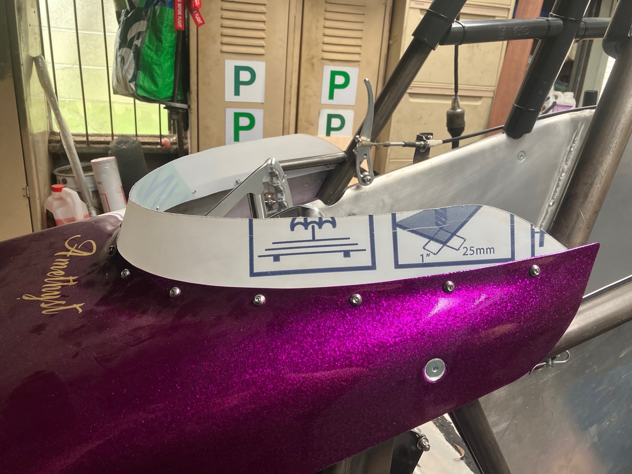

On an easier note, made up the windshield for the cowl from some 1.5mm polycarbonate sheeting. Still has the protective film on it, but is clear once the film is removed.
FED windscreen 2.jpg (703.14 KiB) Viewed 6326 times
FED windscreen 1.jpg (889.14 KiB) Viewed 6326 times
