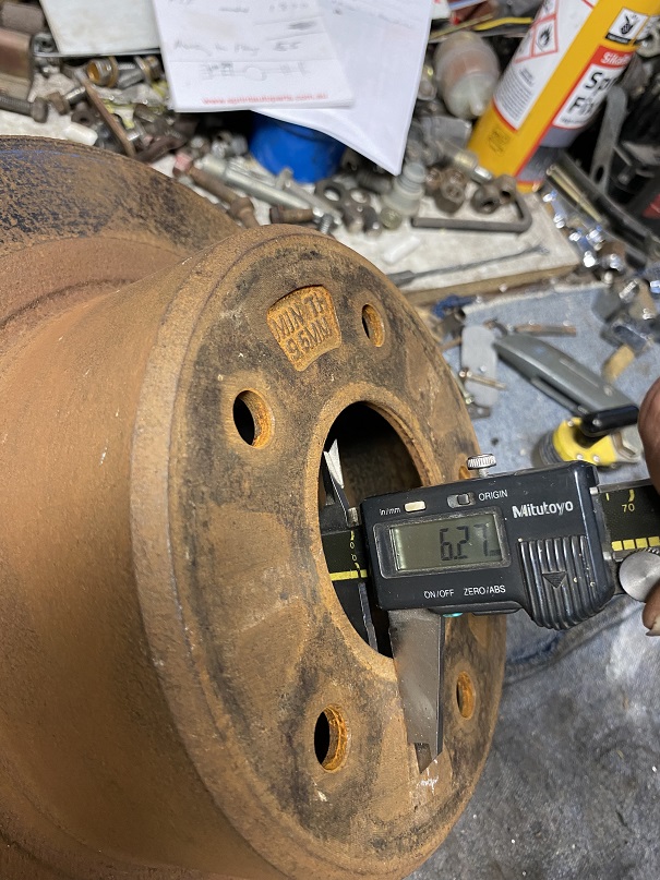

All ready to weld so I asked my neighbour to check my calculations.
Diff housing.jpg (76.48 KiB) Viewed 3675 times
All good until I remembered the disc mounts over the studs against the axle face.
Disc thickness.jpg (215.26 KiB) Viewed 3675 times
Now I have the re-cut the diff tubes by 6.3mm per side to achieve the desired width of 1370mm.

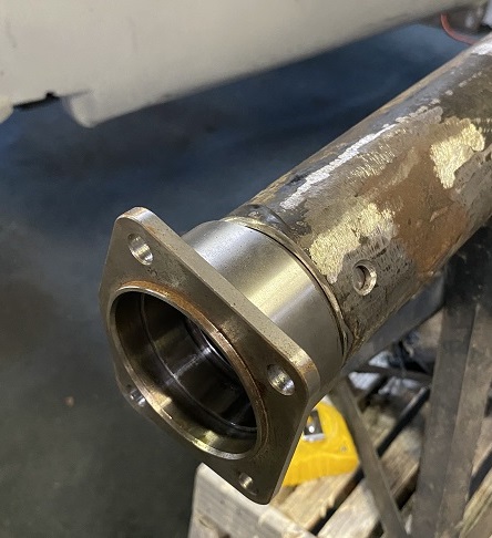

Located in the jig and all ready to weld, thanks again Gledge.
I will weld the bearing housing and spring pads, let it cool before removing it from the jig.
ready to weld (1).JPG (122.76 KiB) Viewed 3580 times
