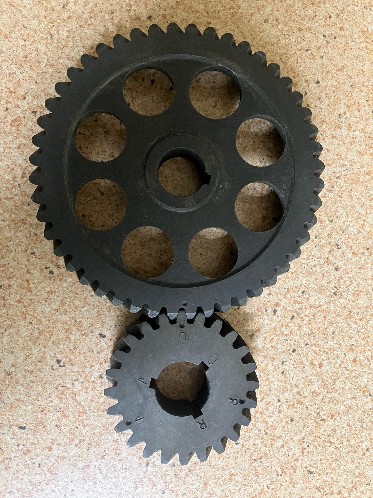

Found the crank and cam gears. One of the few joys of getting old and forgetful is that when you find stuff you have stashed away it is like Christmas all over again. The gearset is a Master Engineering GS138 adjustable timing set. I bought two of these sets as part of the Master Engineering closing down sale years ago. I need to do some learning though as I don't fully understand the keyway angles. Assuming that the "0" point is zero degrees, the advanced "A" keyway is 125º around the crank, whilst the retarded "R" keyway is 105º.
Master Engineering GS138 adjustable timing gear sheet.jpg (854.78 KiB) Viewed 11732 times
Master Engineering GS138 adjustable timing gear set.jpg (1001.02 KiB) Viewed 11732 times
Gut feel is that's a lot of crank degrees, but my mind is thinking of ignition timing, not piston/valve timing so perhaps not so drastic.

Harv, re: your cam timing, methinks it would not retard or advance your timing by 105 degrees as it would not run , I think if you lined up the 'O ' slot on the gear and drew the outline of the corresponding tooth , then did the same with the Ä" and the "R" you will find it will be only a few degrees difference. If you have a protractor you could measure the difference ???
Posts: 5754
Re: Harv's meth monster project
Aha, now I see what I was doing wrong. When the cam is "straight up", the key is in the "0" slot and the "0" crank dot aligns with the camshaft gear dot. I was assuming that to advance the cam the key is in the "A" slot and the "0" crank dot is still aligned with the camshaft gear dot. In reality, the the "A" crank dot is still aligned with the camshaft gear dot.
So the advancement (or retarding) is really the difference between the green "Standard angle" and the red "Advance angle" or blue "Retard angle".

You're right, it is only a few degrees - 2º in each case (roughly measured from the photos with a paper protractor).
