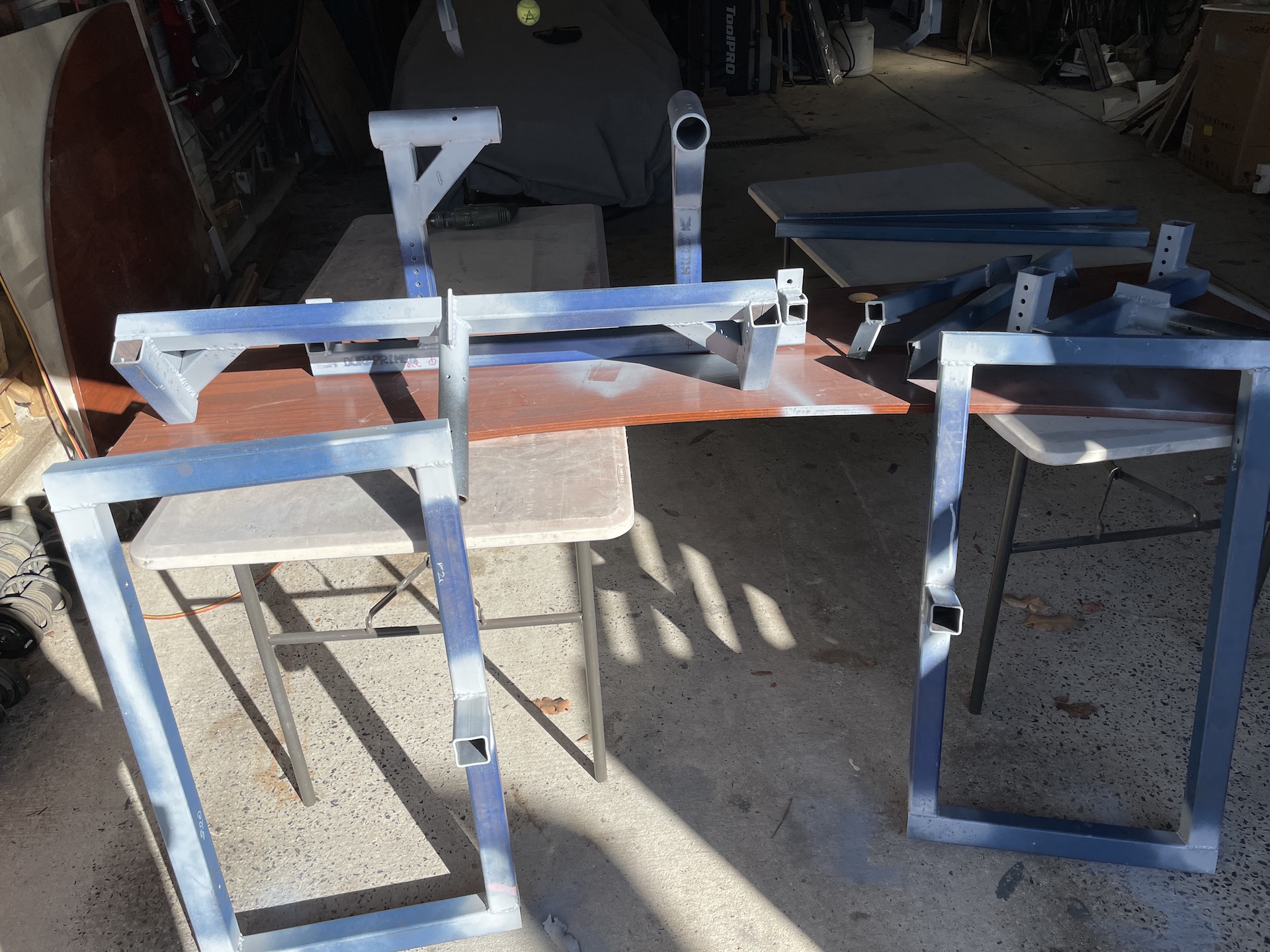

Okay - nearly there.

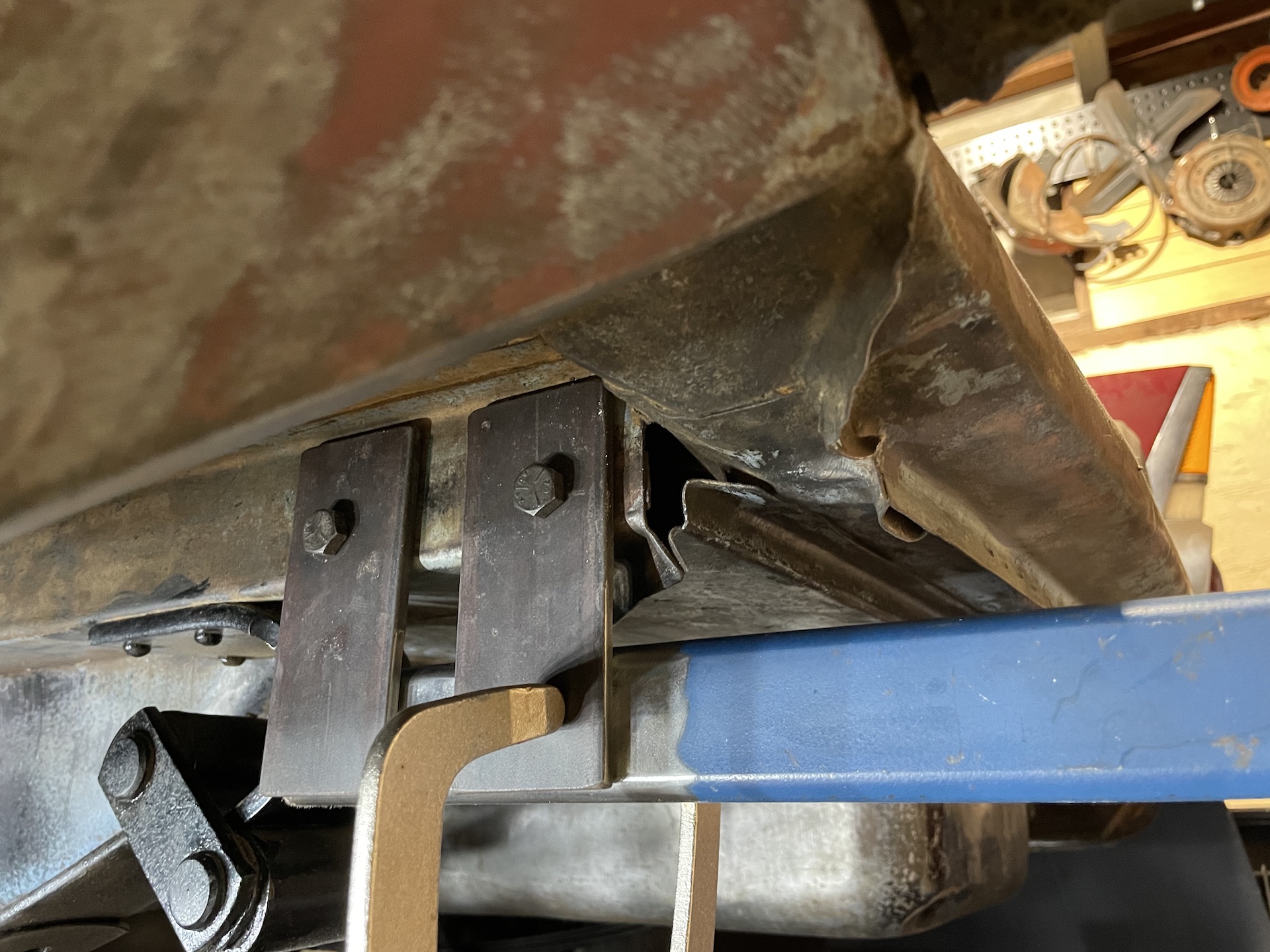

Bolted the plates into the rear bumper mounts and tack welded. Lots of lining up with level and builders square to get as close as possible. There is enough play in the bolt holes for any furthrer adjustment.

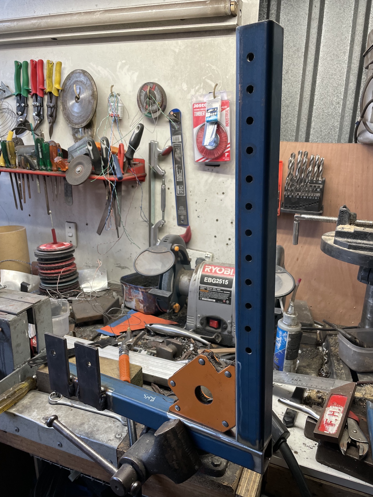

Out into the vice to finish welding each leg.
Bit of art. Both legs welded up and in place.

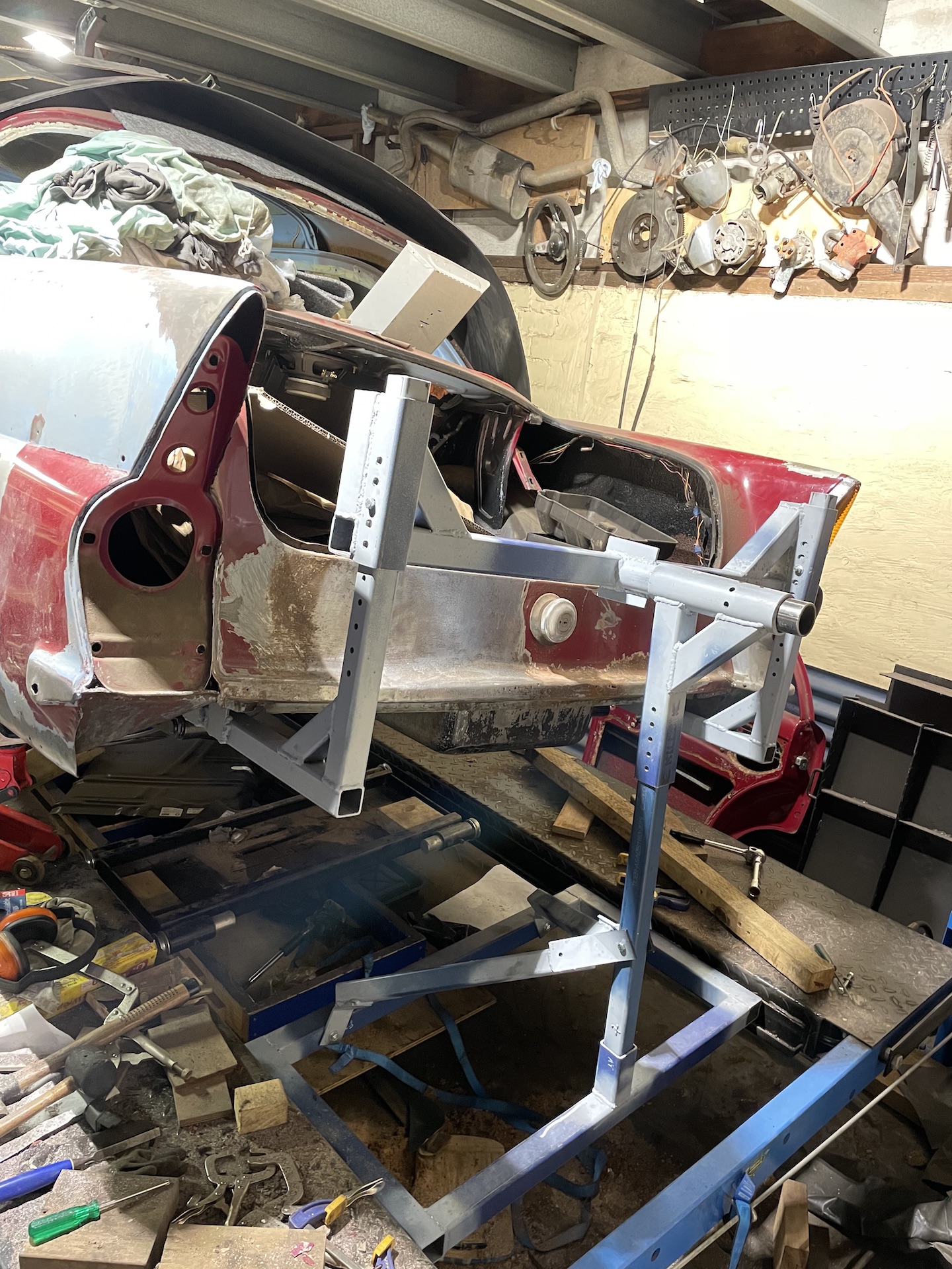

Reassembled and started to balance - and ran out of room. Need to move the subframe, the car, or both.
Fully floating. Need to take the diff out to get it balanced but it moves pretty easily. Will also slide the car back as far as I can to try and clear the sub frame. A bolt in each inside corner of the base, through into the rail of the hoist and I'll call it done. That nine months just flew by.

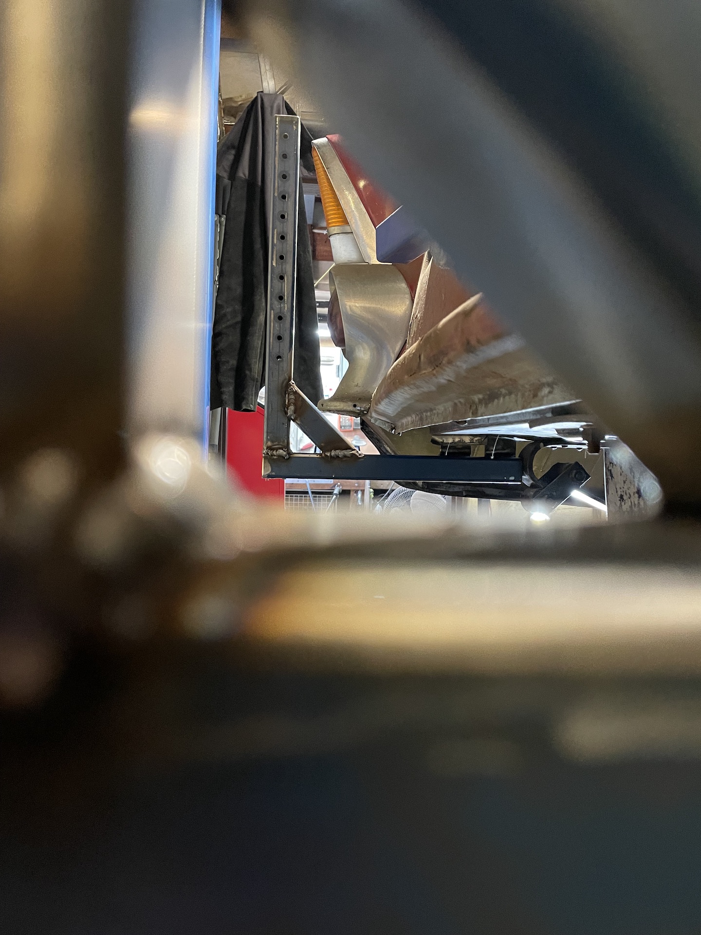

G'day Clay - you don't have any photos of what's going on inside there do you? I also have a couple of the captive nuts gone missing and I'm trying to work out the best way of properly securing the newly chromed rear bumper. The guy before me managed to install a post on one side, but on the other side there is no internal thread at all. I'm thinking of cutting in from the top, but would just like to see if anyone has a picture of what's inside.

Pretty hard to photograph in there in the case of my ute Tex. I was working through the rust holes. On each side there are two square nuts from factory, sitting in individual cages, with no movement. In my case the threads were seized, causing the nuts to spin in the cages, forcing the sides apart.
I replaced them with fresh nuts, fixed with bolts through the bumperette mounts, all set up. Then got the welder in through rust holes and stuck them in place, carefully as I could, without melting the threads. Then repaired the rust inside the car.
