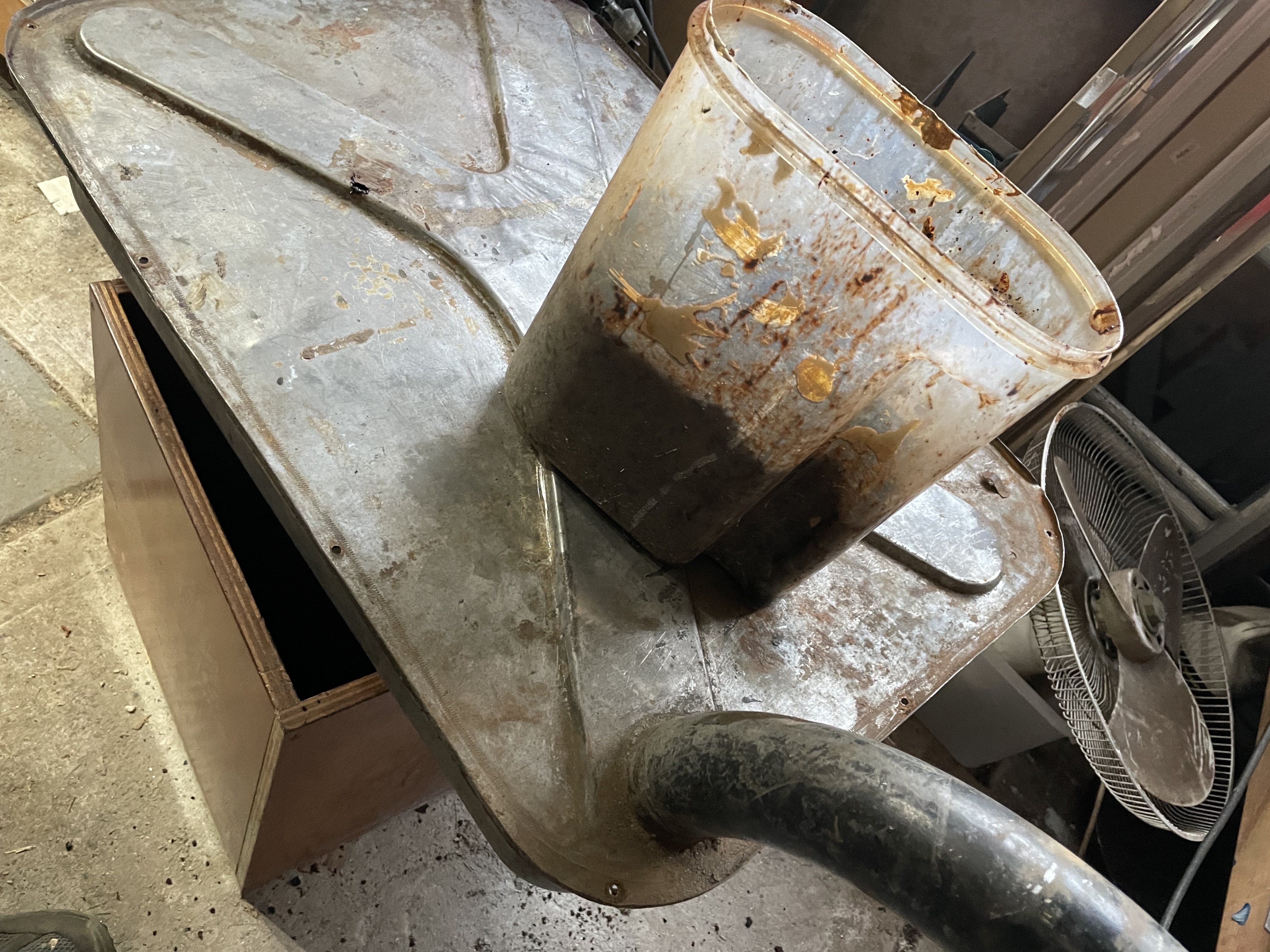

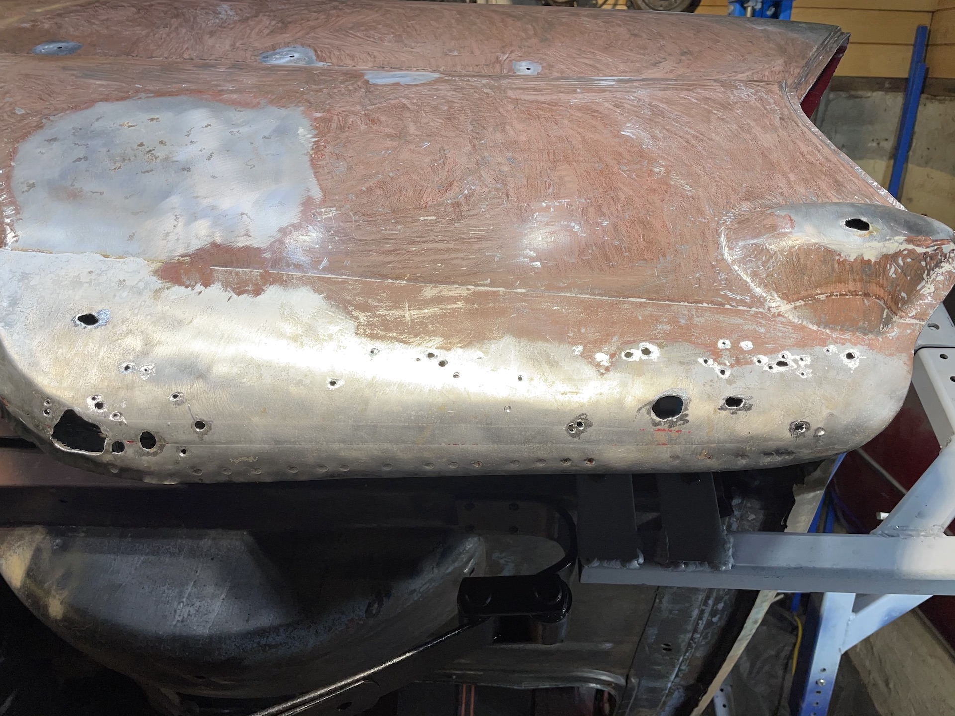

With the fuel tank out, noted there is a fair bit of crud floating around inside. Curiosity got the better of me so I turned it upside down and shook it around. This is what came out - still around about another litre in there by the feel and weight.
Doubt I'll repair this as it has a few holes and a bigger tank will help the thirsty 202. Greg, I'll be having another look at your thread and how you went with the &*#@ xa? tank, but as that has the filling neck on the side (from memory) probably easier to delete the wheel well and go with a Mustang tank (stainless is about $550 at the moment). Or a 69 Maverick tank looks like it could work if you flip and narrow the wheel well (Space Saver anyone?) - but means sourcing from the States and not in stainless. And at around 1K might as well source a custom tank from here. Or am I underestimating the cost of custom?

Re: Ol' Rusty - FB/EK Sedan
I would be more inclined to solder up the pinhole in that tank and whack it back in - whenever we do any long trips we stop every couple of hours anyway so I have never felt the need to have a bigger tank .

Harv, thanks for the link - I've seen that name pop up and was who I was thinking if I go down the fab route.
Blacky - I'll spend a bit of time on the tank to work out how much I'll need to do to slap it back in. Sydney to Melbourne was a three/four stopper depending where I'll fill it. Always over cautious as I never trusted the gauge. 2 litres of crud in the tank wasn't helping the cause either.
Greg, some honest feedback there about the spare - flat clean floor would be nice, but this isn't a show car so if I have to push a spare out the way to fit stuff in the back then that's no issue. I looked for dimensions for XA-B tanks and they seemed too big. Well done getting it in. Even a Mustang tank (at me rough measurement) has the tank just past the start of the diff hump. Not by much though.
So order of operations - proper assessment of stock tank, price custom tank, stop procrastinating and make a decision.

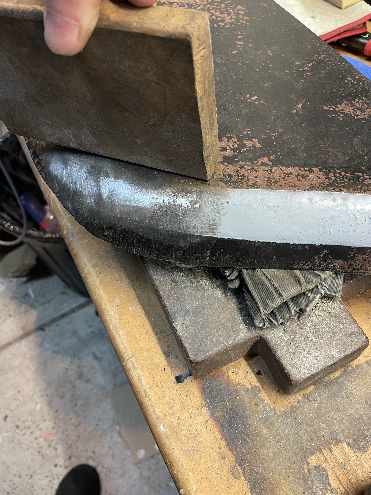

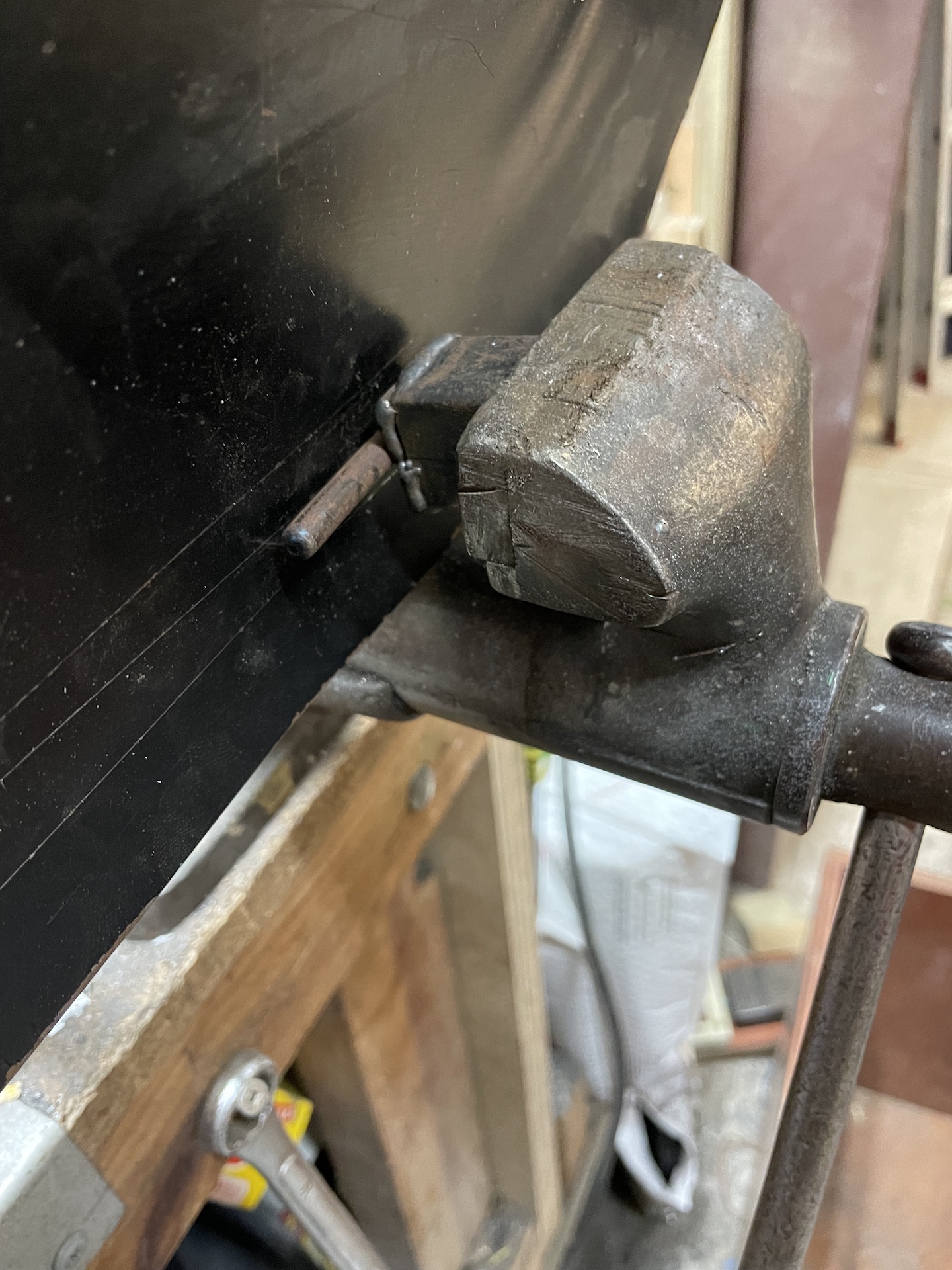

Got my 'cheap' rear quarters in the mail the other day. Should have spent the extra $80 and got new ones instead of NOS ones that look like they have been left out in the weather.
Oh well, stuck the good one in a bath of citric and had a crack at a bit of panel beating on the other.
Can't fit this piece in the press so managed to bodge it up in the vice with my block of hard wood and rod
Scored some lines in the panel and even masked and painted a shadow line to see what it might look like. Panel in the vice and squeeze my way along the line.
Jaws not deep enough to get to the arch so plan B with a bit of bent alloy rod from a shelf in an old fridge
Hammer with block of hard wood
Working the metal made what was a bad fit is now really bad. Will need a bit more love
But you get the idea. Bit rough but I like the line.

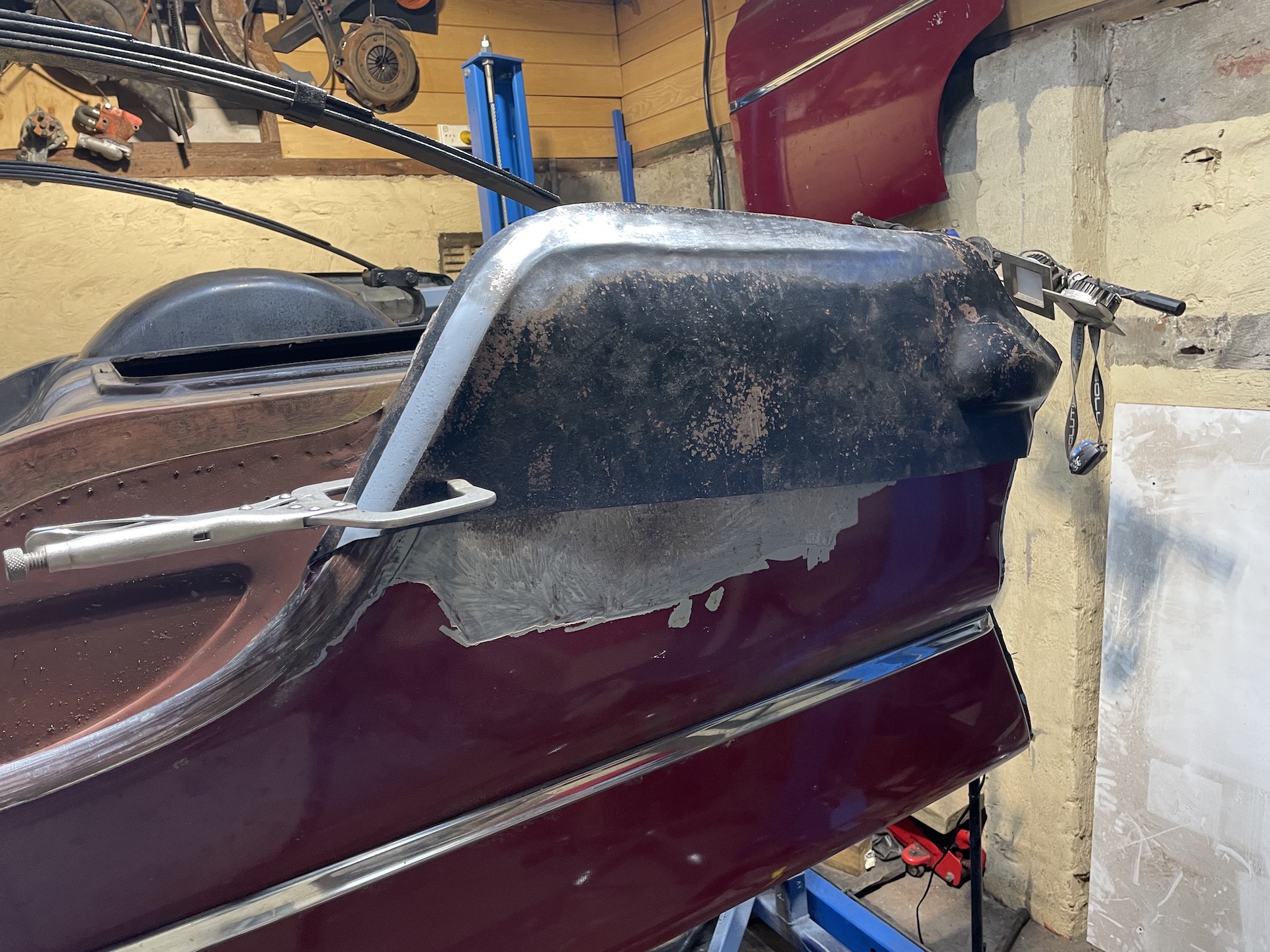

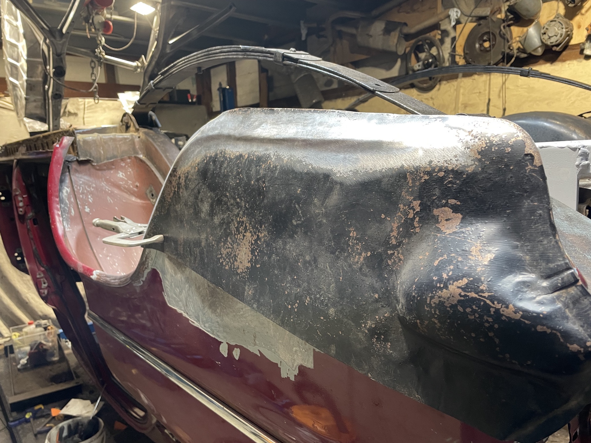

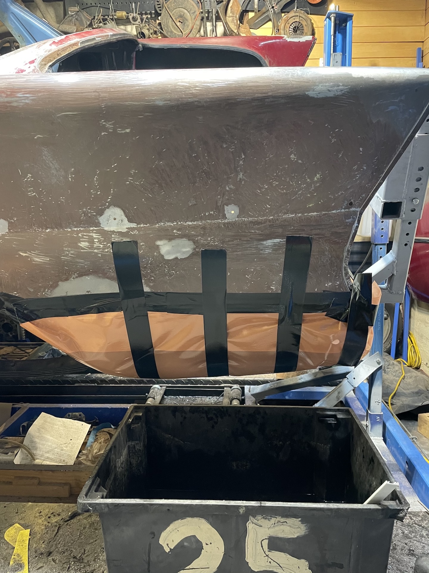

Had a go at shaping the rear quarter panel with my knee to see if I could get a bit of curve in the panel. Well got a bit more than I need....
Decided might be about the right time to straighten it out, and put it in a nice warm acid bath.

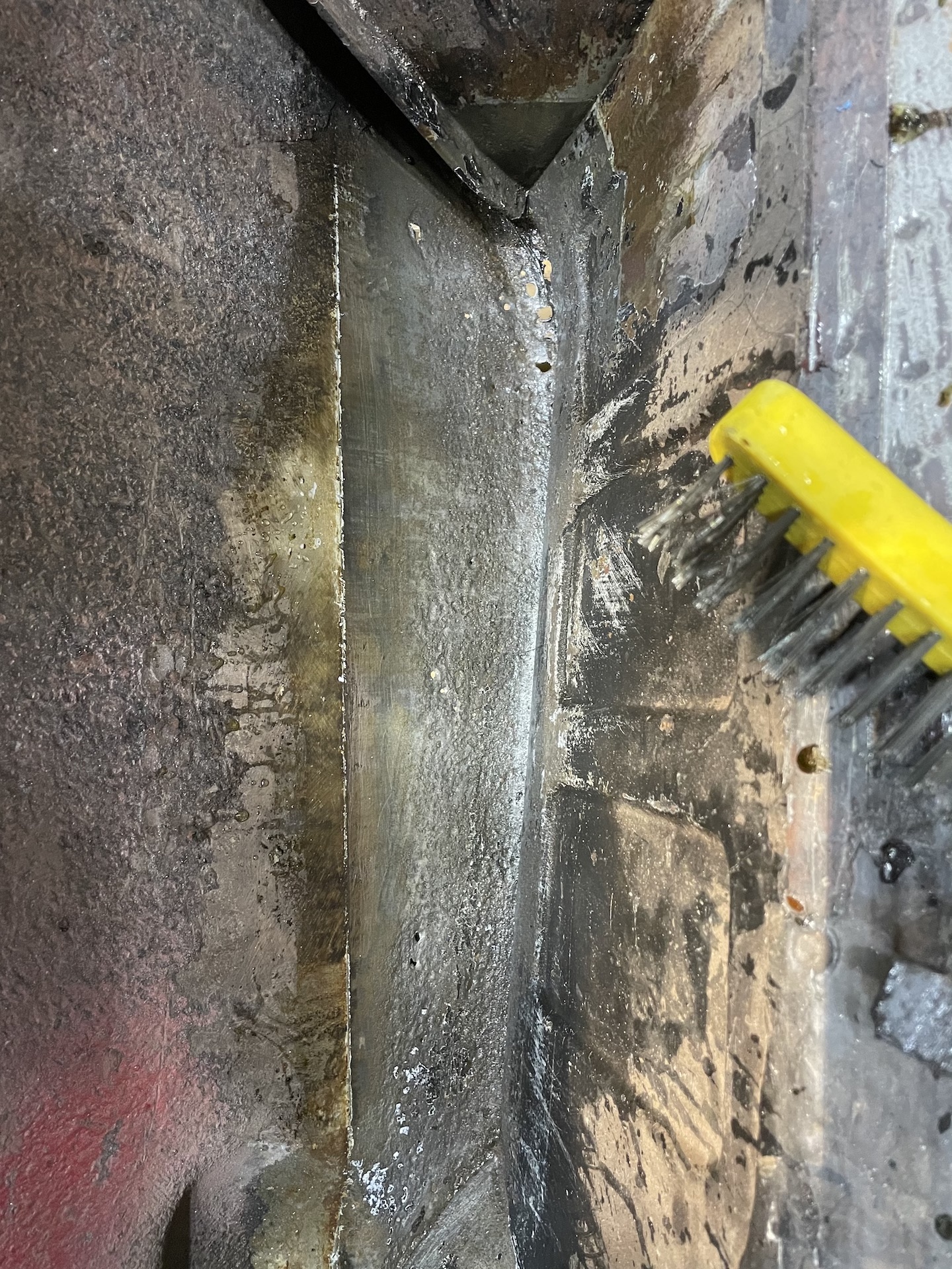

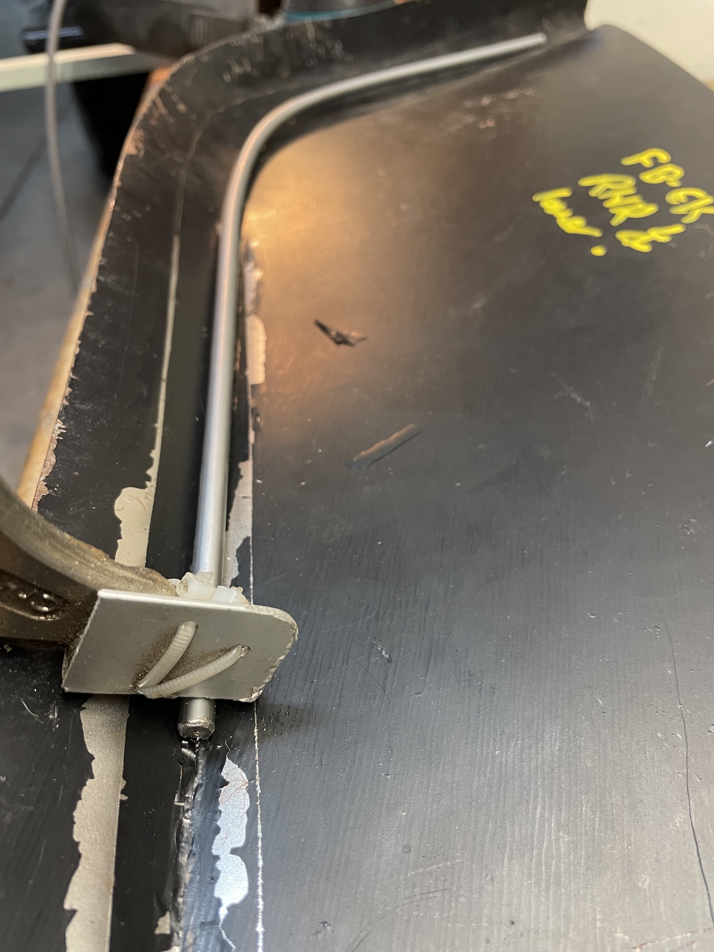

Swapped it with the passenger side which had been soaking for a few days. With a quick wire brush this one scrubbed up alright. The rod I used first time round is great to draw out the line to use as a guide on the inside of the panel

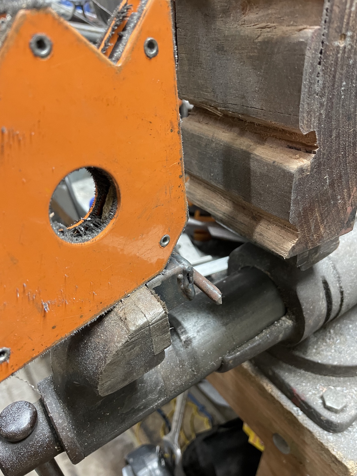

Repeated the process from earlier. To help the panel curve I shrunk it a bit more. Cold chisel, a couple of old drill bits with a washer between them and some ducting tape does the job.

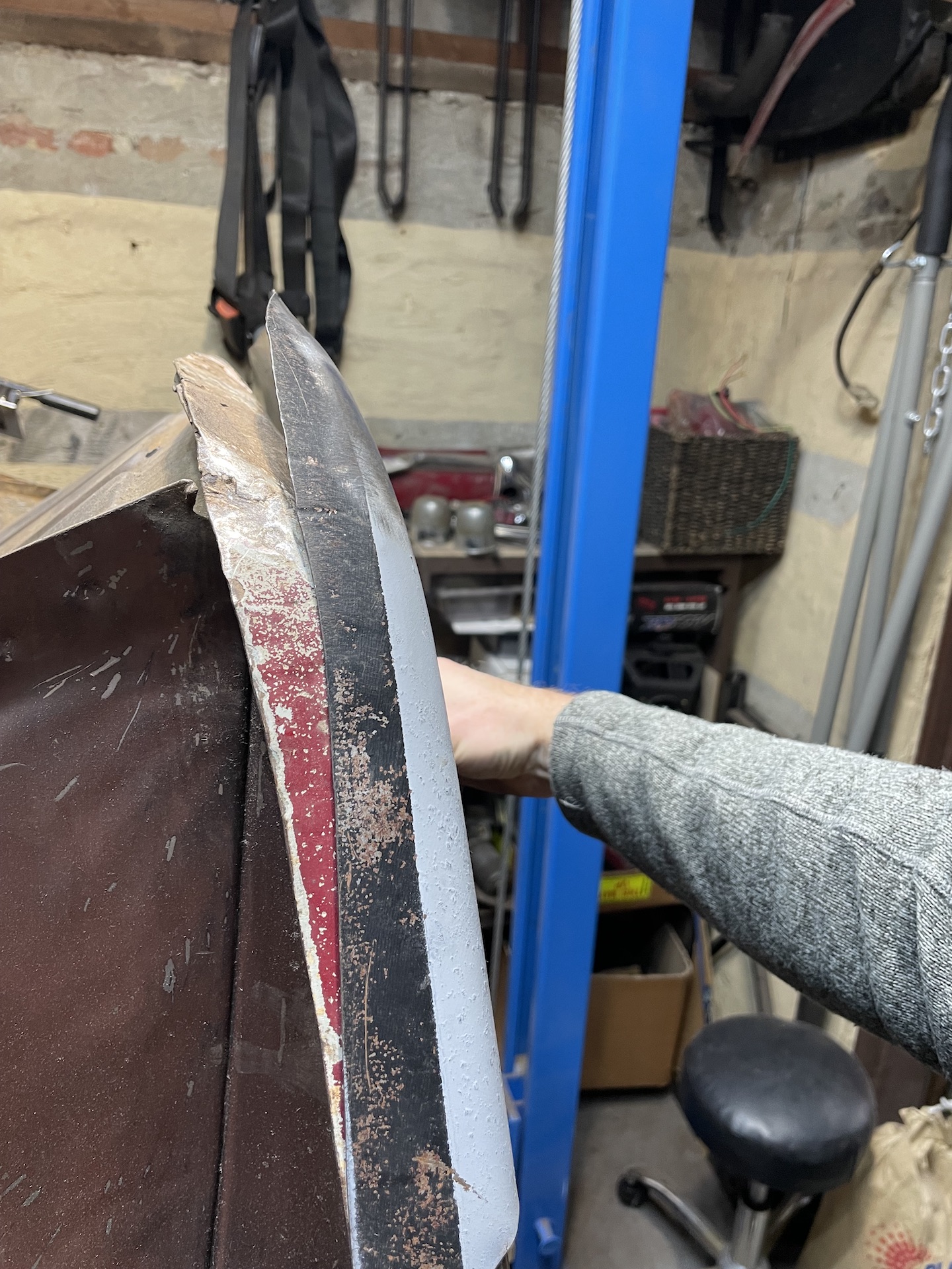

Using a shifter to help with the bends leaves little scratches so I decided to make some soft jaws out of hard wood and masking tape.
Here is the result
